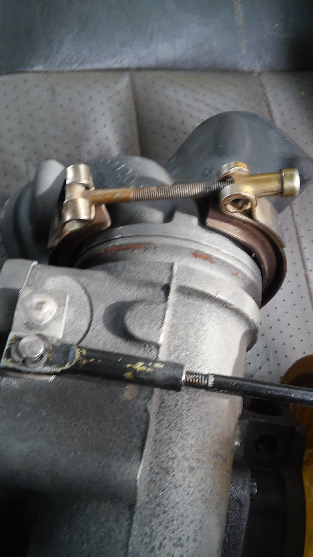

Easy, tighten to spec the collector to the up pipes, then make sure you align the up pipes to the exhaust manifolds putting the bolts and nuts hand thight so they wont loose their location(this is the most important thing for ease of installation) from there put the clamp that holds turbo to collector over the collector like this
align the turbo to collector make sure the nipple goes all the way in into the collector,
Install the ebpv if he still has it. Put the turbo to pedestal bolts tighten to spec, then go and tighten the manifold to up pipes bolts. And your done.
