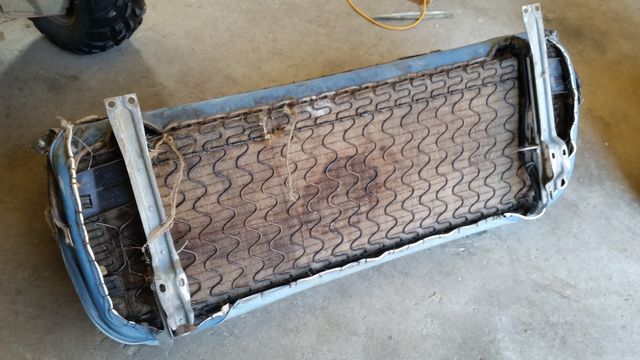

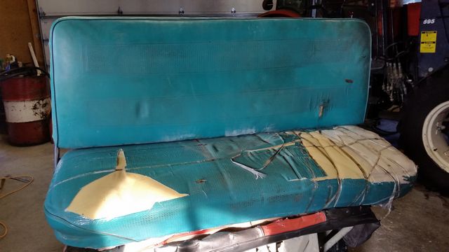

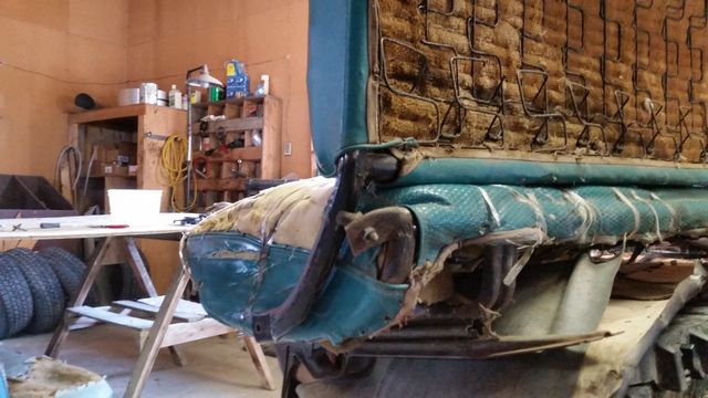

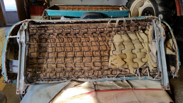

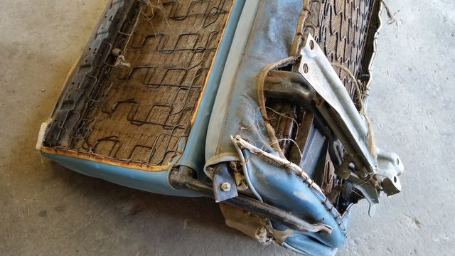

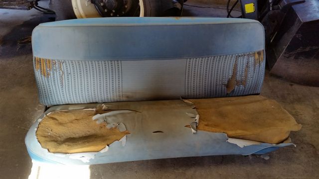

I used a '66 Custom Cab seat in my truck, instead of the '65 Standard Cab seat from my parts truck. The seat backs, as far as I could tell, are the same. I believe that the seats are the same length, width and depth, but the springs and thickness of foam padding are different.
The Custom Sab seat springs are right at the bottom and flat, with 5" of foam. The seat fabric attaches at the back near the springs.
Size:  51.3 KBName:  tn_20160226_120404.jpg
The Standard Cab seat springs are higher up, curved, with far less foam, maybe 1" or so. The seat fabric attaches at the back a bit higher up, so less fabric is needed, as far as I could tell.
Size:  62.4 KBName:  tn_20160226_103214.jpg
Does your seat look close to any of mine?
