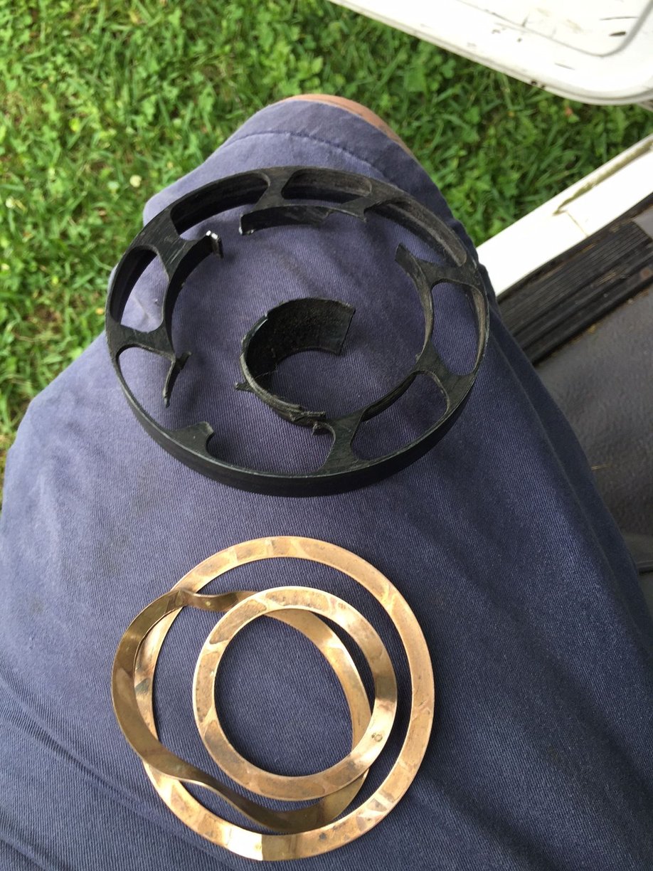

Hello, I'm Mark and I'm new to the forum. I recently picked up a '94 F250 with a 351 windsor. Solid truck however the steering wheel has a bad wobble. I pulled it apart and the bearing is shot. I plan on replacing the bearing. I found a little kit online that I can use to replace the bearing or I was going to order from LMC truck. I also came across two other broken parts that I'm not too sure what they are.. can anyone help me identify them? Thanks
the kit i found on ebay..
any idea what these parts are called?
F4UZ-13806-A Switch Assy - Horn Contact
Three ring contact part of #3600 , w/o air bag, w/o anti,theft, w/o speed control
OR
F4UZ-13806-B Contact Ring And Brush Assy
Three ring contact part of #3600, brush asy #9C899, w/o air bag, w/speed control
F4TZ-9C899-B Brush Assy
Less Driver Air Bag Restraints, Less Anti-Theft System
OR
Do I need the horn three ring contact? My horn is wired to a horn button on the dashboard, i guess the original owner couldn't figure out why the horn didn't work, LOL.
as far as the brush assembly I cannot find a picture of a new one when I search the part number..
I don't believe the truck has speed control or anti theft..
