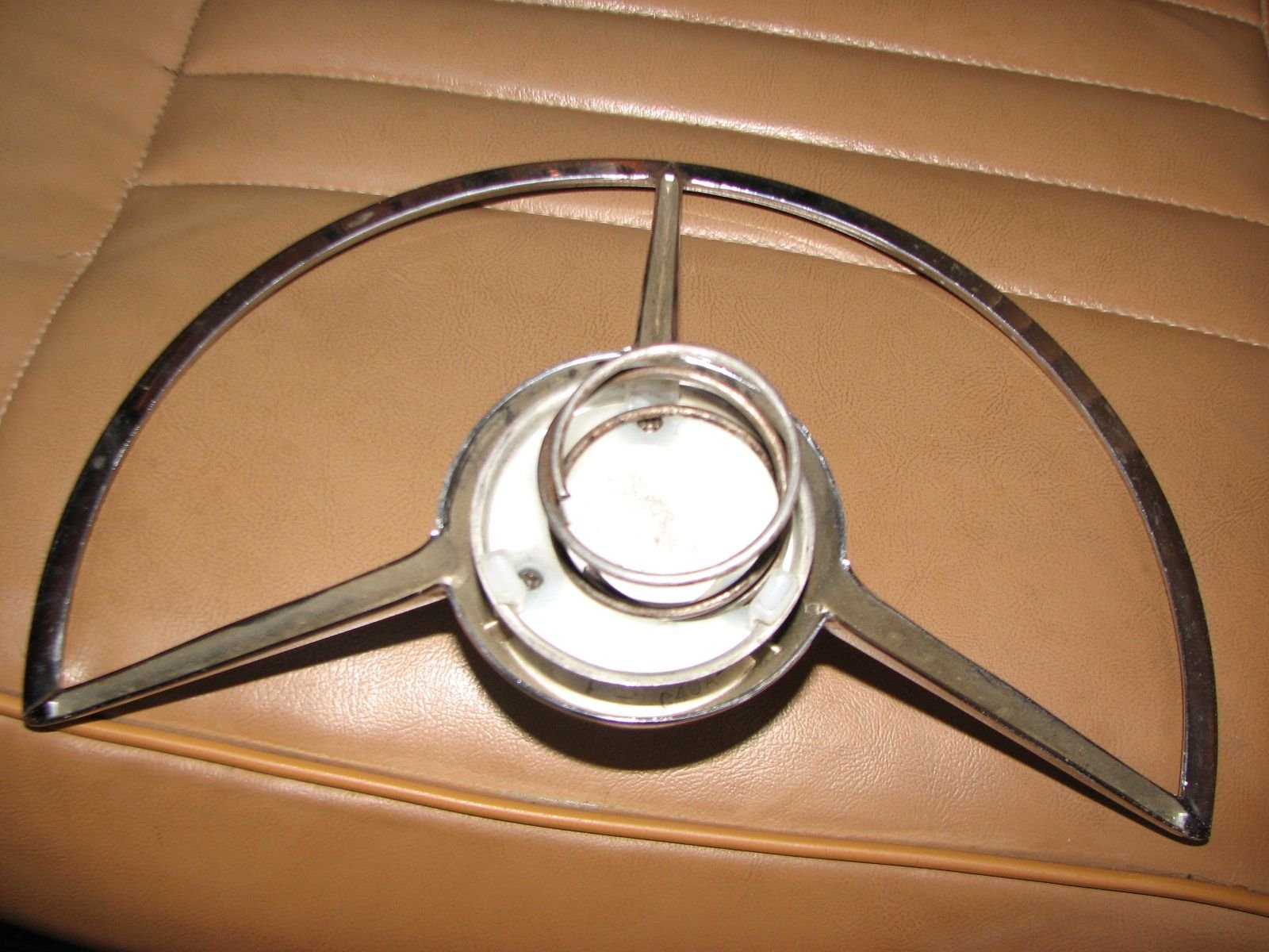

I am replacing the turn signal switch on my 66 F100, understand everything going on there. I have never had a horn all that is there is what is you see in the picture can anyone tell me what I am missing. I think this truck was originally a column mount shift and someone installed a 4 speed on the floor?

Suggest clean all surfaces starting at the horn ring to the turn signal switch, dissimilar metals tend to leave a residual film which can cause poor ground issues. Also, there are 2 horn brushes that are same, flimsy so I try and keep a spare on hand: 1 at the steering wheel collar and another at the turn signal switch. Rather than cut and splice the turn-signal wires, with patience one can remove the individual pins from the connector using tweezers, mini screw driver, or both. There is a tool perhaps other member's can offer info. Imagine member will be posting pic of the assembly? With regards to the horn ring/button, make sure the plastic retainer pins/ears that secure the ring/button to the collar are not worn or damaged. Removing the 3 screws on the horn ring retainer there is what I believe is referred to as a pressure pad. Make sure it's in decent condition and surfaces are clean.

Thanks for all the information. As far as the horn it looks like from your pictures i am missing a spring and the half circle looking thing?

You'll need a few things to get it right. Here's the parts catalog page showing the parts.
The horn brush (C2OZ-13A821-A) is the same: 1961/66 F100/250 2WD; 1966 F100 4WD & 1967/70 F100/350. Yours is in place, but take it out and look at it.
The brush contains a coil spring and has a thin copper wire that snaps. When this occurs, the horn no longer blows.
The nylon retainer (C2DZ-13A809-A) is the same for the horn button and horn ring, has the same applications as the brush.
But some people don't know that to remove the button/ring, it has to be pressed down firmly, then turned. They attempt to pry the button/ring off, which breaks off one, two or all three of its "ears."
Now the button/ring sits catty wampus or if all three ears have broken off, won't fit on the steering wheel...period.
But, be aware that the coil spring used with the horn button (C0DF-13A807-B) is different than the horn ring spring (C0DZ-13A807-B). Both are reproduced, but make sure you get the correct spring.
I posted the parts catalog pic, so you won't have to scroll up to post #4 to see it.
The following parts are shown as their basic part numbers: spring: 13A807 .. nylon retainer: 13A809 .. horn brush: 13A821
