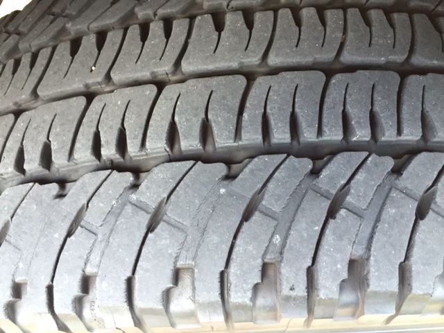

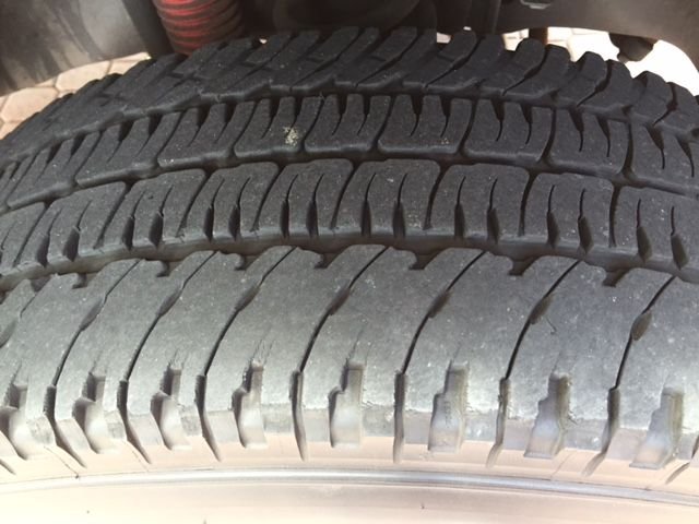

Here is what my tires look like after less than 28K miles. Jim

I think you need to get your alignment checked before you replace the tires, it appears the tread is worn on one side making me think it's a alignment issue.

It's hard to tell actual tread depth since there is that raised portion between the tread blocks on the outer sections. Honestly that doesn't look that bad to me. Mine looked worse than that at 14k miles when I got rid of them. They had tread blocks chunking off of them.
Do you have a tread depth gauge? Measuring in several spots across the tread face will probably tell you more than we can.
