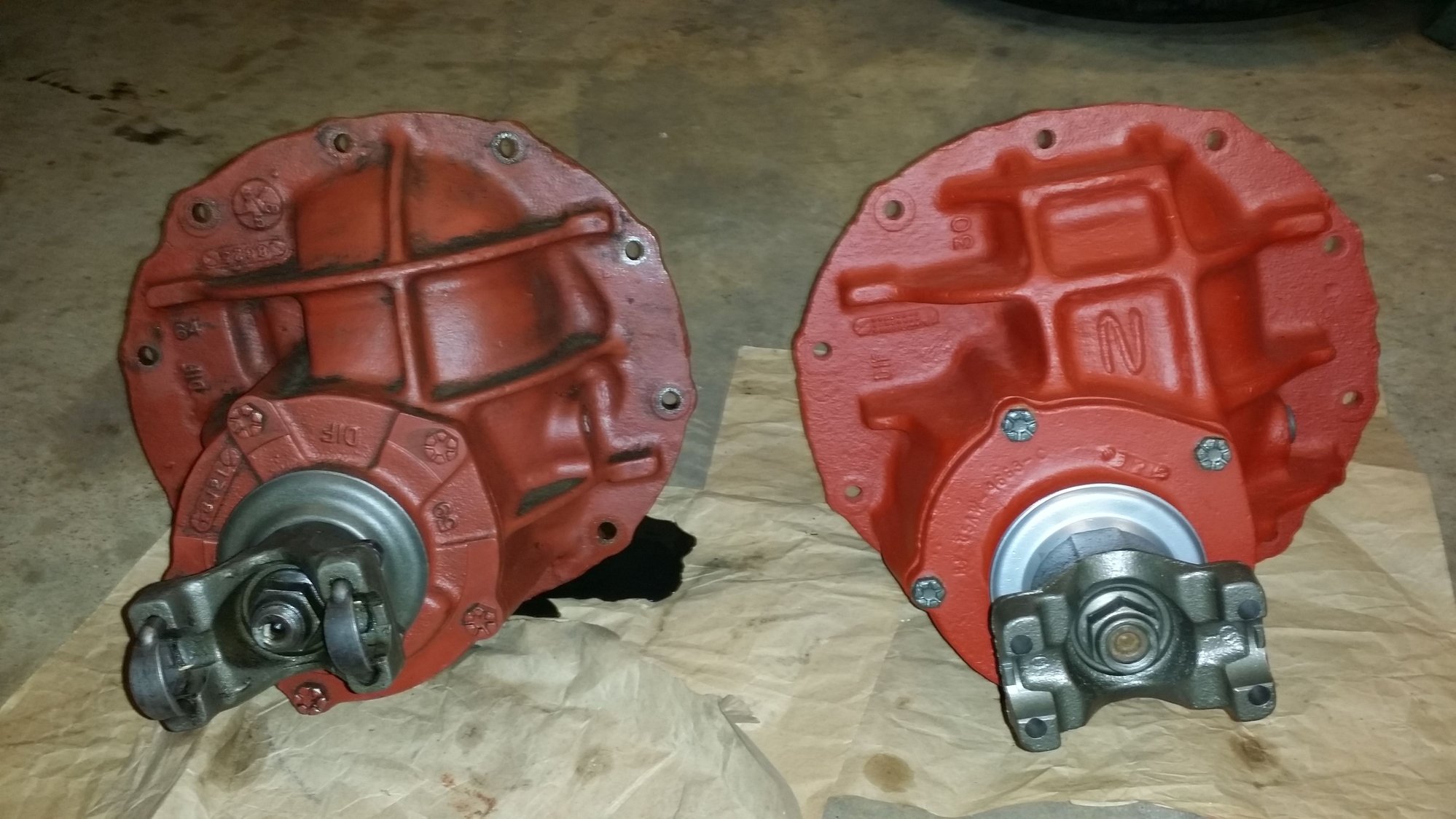

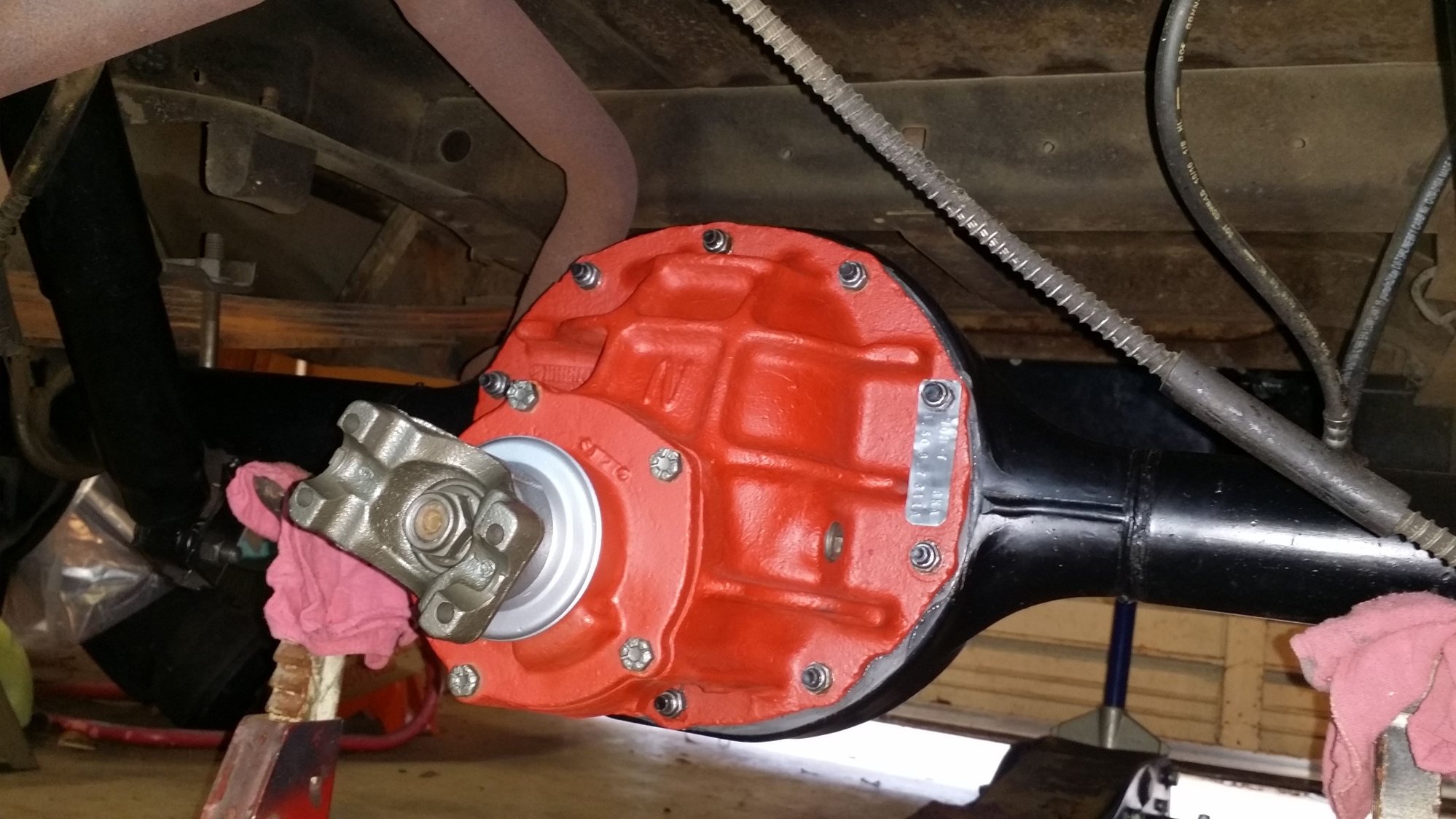

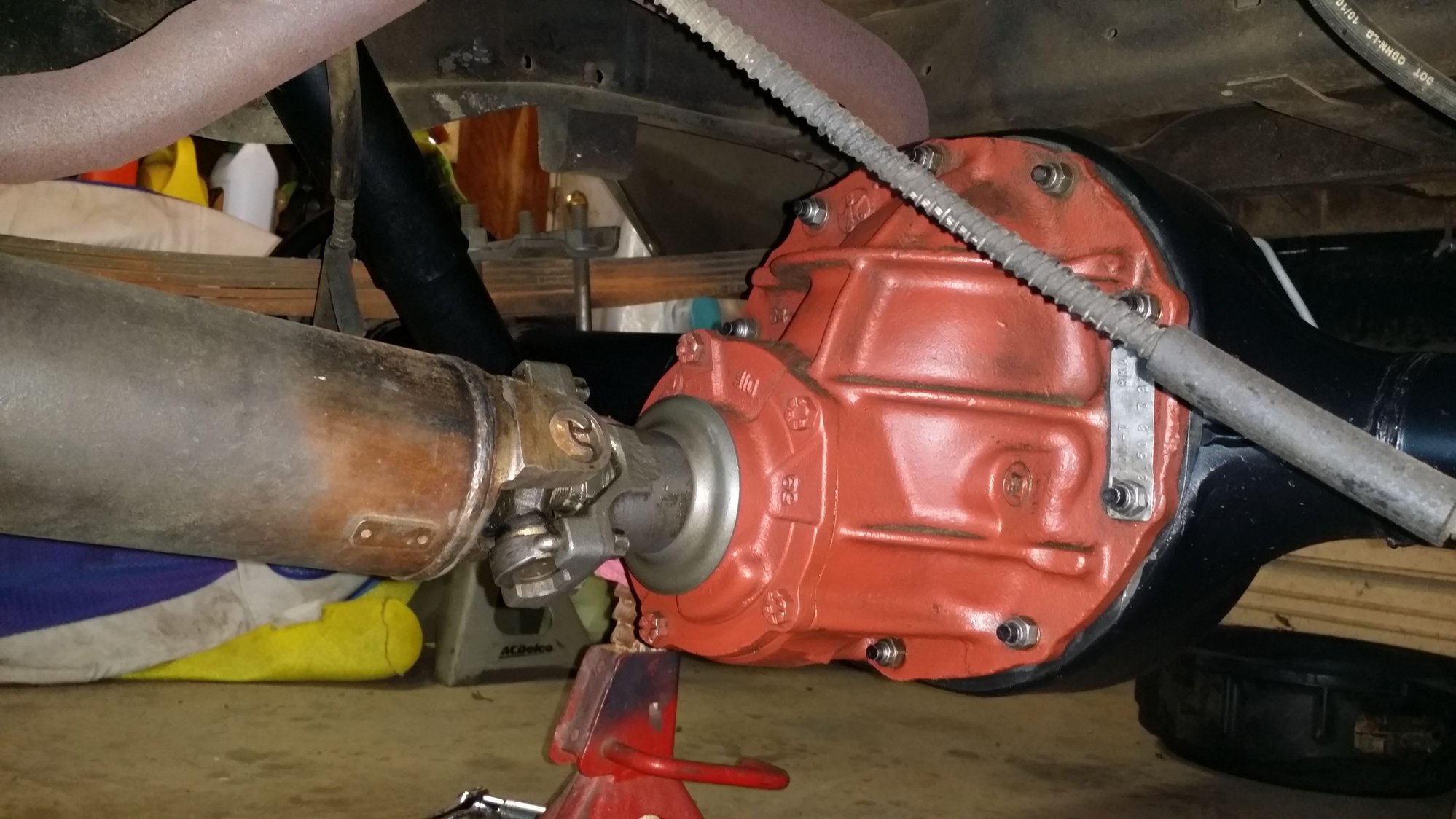

--I also recognize the photo of the rear end you posted. That was the original 9-inch 3rd member with a 28-spline, single track differential and 3.50 gears that came in my '69 F100. I replaced it with a 9-inch N-case 3rd member with a 31-spline, 4-pinion, Traction-Lok differential with 3.50 gears. The Ford 9-inch N-case 3rd member came out of a '75 F150 4x4. The 31-spline axles came out of a '71 F100 that had a Ford 9-3/8" rear end.
Before the 3rd member and rear axle (28 to 31-spline) change in my truck.
During.
After the 3rd member and axles were swapped.
