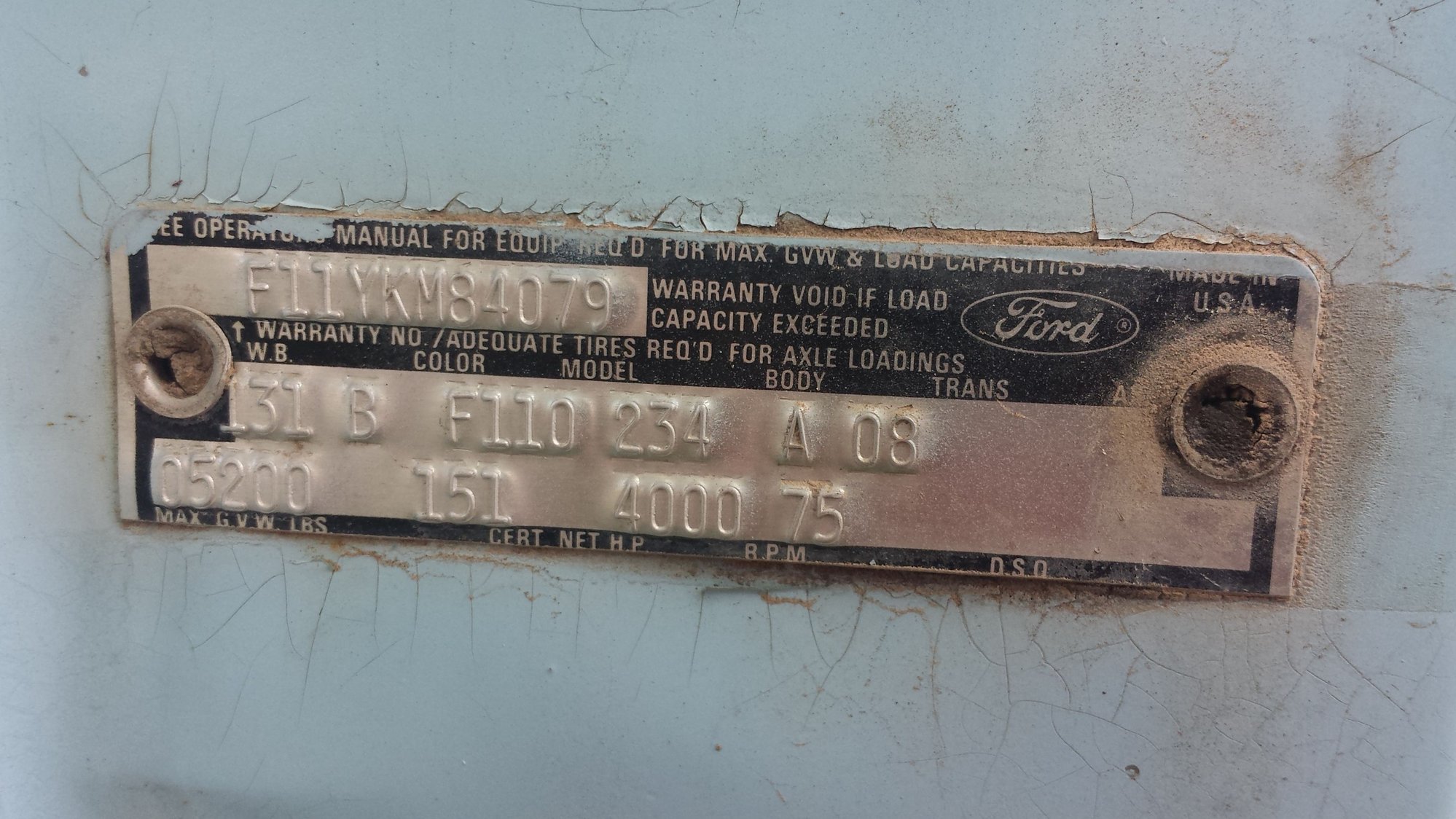

Originally Posted by Wrecklesswisdom
You have the same gear ratio as what came in my truck ("08"). That's a 28-spline open differential with a 3.50:1 ratio.
The other two most common ratios were "17" and "09". 17 would be a 3.25:1 ratio. "09" would be a 3.70:1 ratio.
Two number digits under the Axle heading on the door tag indicates an open (single track) differential. An alpha-numeric, such as "B9" would indicate a 28 spline Traction-Lok differential with 3.50 gears.
If there's still a tag affixed to one of the (10) studs on the rear end housing, the first string on the 2nd line of the tag should read "3.50". If you had had a Traction-Lok differential, the 2nd string would have read "3L50".

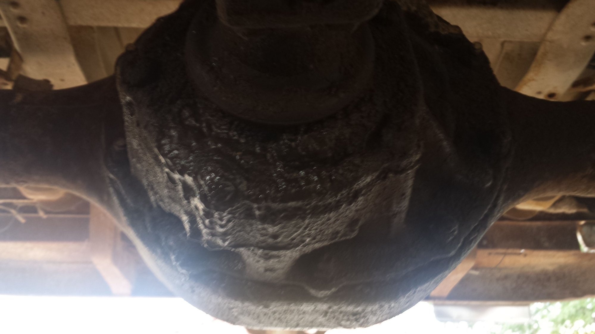

unfortunately the tag is no longer on the differential. But this is good info, most of the truck is pretty original so i would be surprised if it had been changed. a 3.50 seems low for how the truck performs, i mean if i gas it in low gear i just get a bunch of time smoke until it stops, but that could be due to old tires ow what have you. i noticed that its not the diff gasket thats leaking last night, its obviously from a bit further up, so i will probably have to replace seals. :/

Take that diff to a car wash or steam cleaner. It'll help find the leaks when you can see the seals/gaskets edges.

That's a nasty pumpkin. Eww. Do yourself a favor and clean it up. Do it... Working on a filthy, smelly, and muck-laden vehicle is no fun.... it's more "work" than leisure.
Based on where it mucky, I'd put my money on a bad pinion seal. If you're not inclined to do it yourself, find a reputable driveline shop and have the pumpkin rebuilt and set up. You may want to consider changing the gear ratios and/or adding a limited slip or a streetable locker at this time.
While the pumpkin is being rebuilt, replace the bearings and axle seals... maybe rebuild the brakes too. Then install the pumpkin, re-insert the axles, and reassemble the peripherals.
Observe break-in procedures if with new gears and/or traction aid device.
