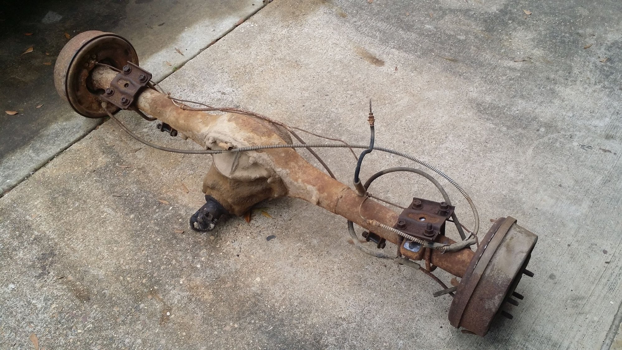

This is the '81 9-inch rear end I have with 2.47:1 gears, 31-spline single track differential and with a 5 x 5.5" lug pattern. The plan is to eventually replace the stock 31-spline 5 x 5.5" lug pattern axles with a custom pair of 31-spline axles with a 5 x 4.5" lug pattern.
This rear end housing has the 'Torino' style large axle bearing end flanges (the 4-hole backing plate bolt pattern is 3.562" x 2.00", compared to my current old style large axle bearing backing plate bolt pattern of 3.500" x 2.375"). The 'Torino' end flanges will make it possible for me to bolt a set of Explorer rear disc brakes onto this 9-inch rear end housing.
I would get the front rotors machined from the 5 x 5.5" lug pattern to a 5 x 4.5" pattern. Once everything was swapped over onto the truck, I would have power 4-wheel discs and a LOT more and nicer wheel choices to choose from than the limited number of wheels that are available for the 5 x 5.5" lug pattern --since currently, I'm just running a stock set of (black) '92-'96 Ford F150 wheels.
