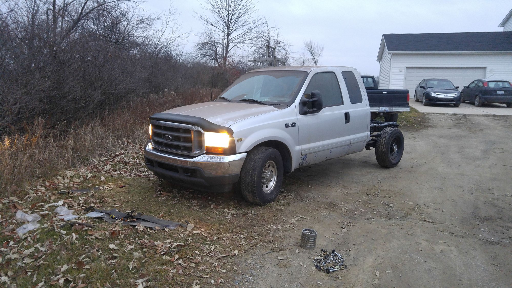

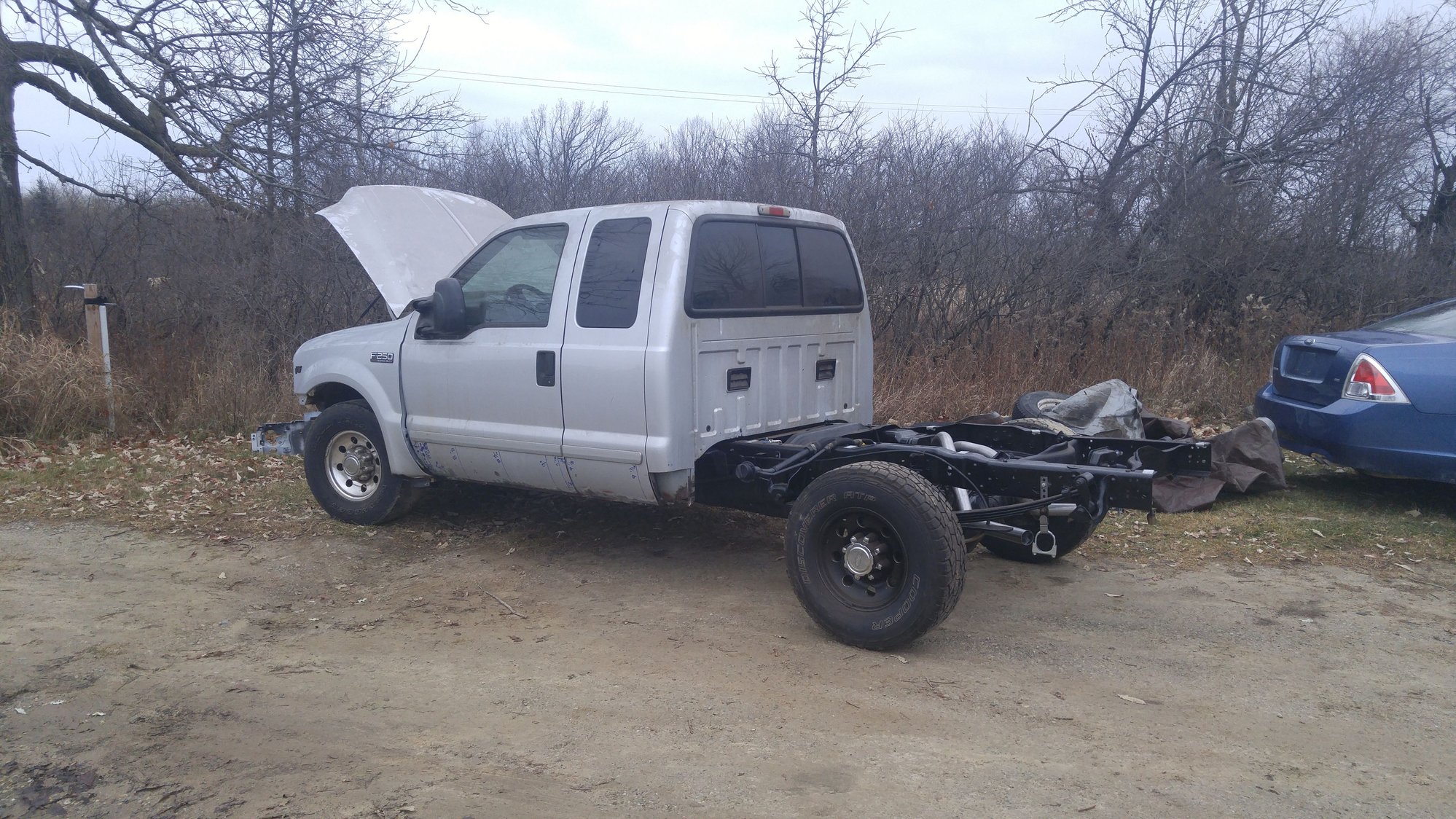

Well I got the truck finally started yesterday and she ran great after I put on a couple vaccum hoses I had fogot... The Gibson dual extreme exhaust Sound a good too!

Pics/video

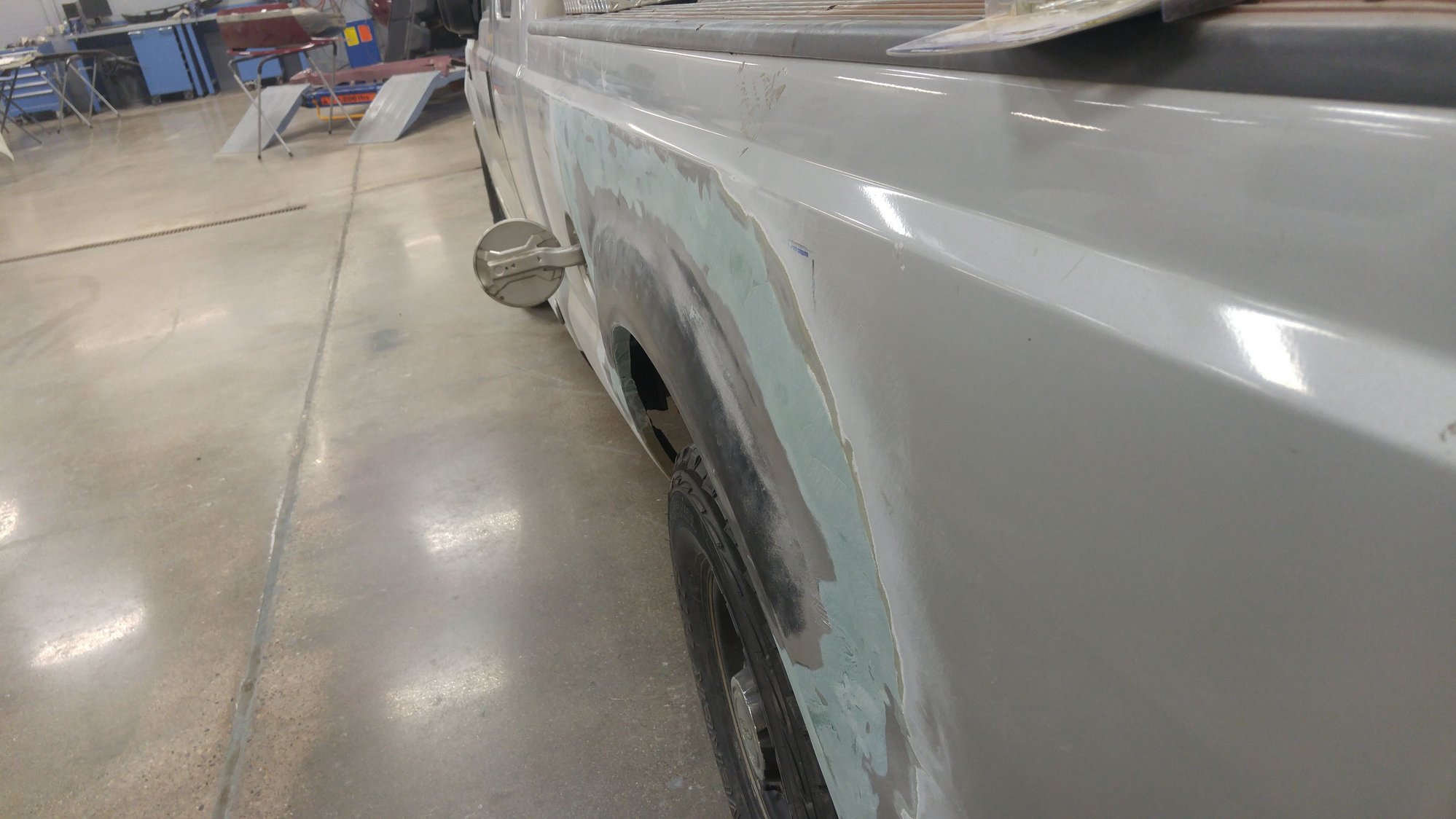

Well i finally got the tierods done and got my truck to the college last week... I also had a problem with the truck hesitating when u would accerate hard and was able to fix that by changing two of the coils... Anyway i got a little work done on the truck: got all the pinholes in the passenger wheel arch filled and duraglasses that side( not done yet)... I also got the drivers arch in and the inner wheel arch in using panel bond and got the exhaust cut and got the tips where i want them....

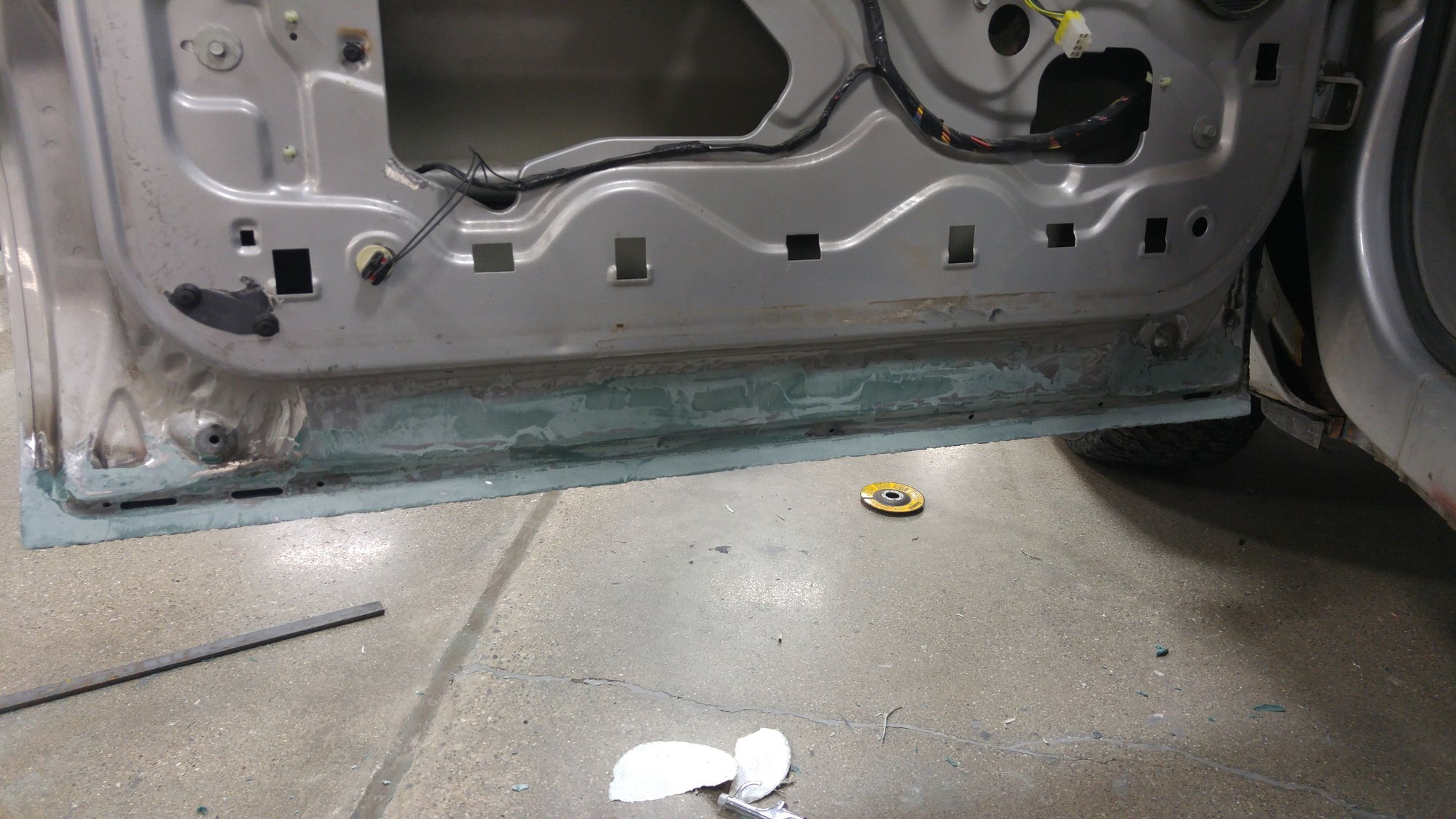

Hey guys, got some work done today had to weld the inner wheel well to the outer because the panel bond didnt set that was a pain in a**..anyway got that welded up and ground out, duraglassed that wheel arch along with that lip and got some sanding done..I also fully welded the bottom of the drivers door and got the rear door almost done too....

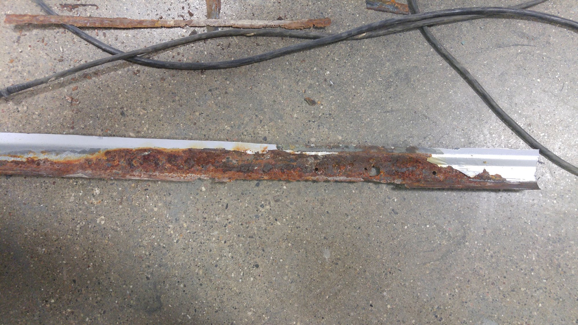

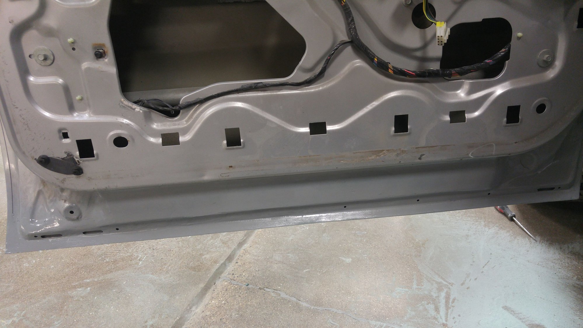

Hey guys got anouther update for ya... I got the passenger sheet metal patch made and panel bonded in as well as i cleaned up all the rust on the rear passenger door and panel bonded it back togeather. I also got some duraglass on the drivers door bottom. I still have a lomg way till its even close to being done.... Hopefully next week i can get passenger inner wheel arch in, the doors all done with body filler and the wheel arches close to done....
Piece that came out of the passenger door...

Pour some bar and chain oil in those doors before you reassemble. Or motor oil. Or Fluid Film. Anything you can coat in the bottom that will prevent the problem from happening again.

i plan on seam sealing it on the inside plus spraying some undercoating or truck bed coating plus spraying some oil in it...i dont want them to EVER rust out again....

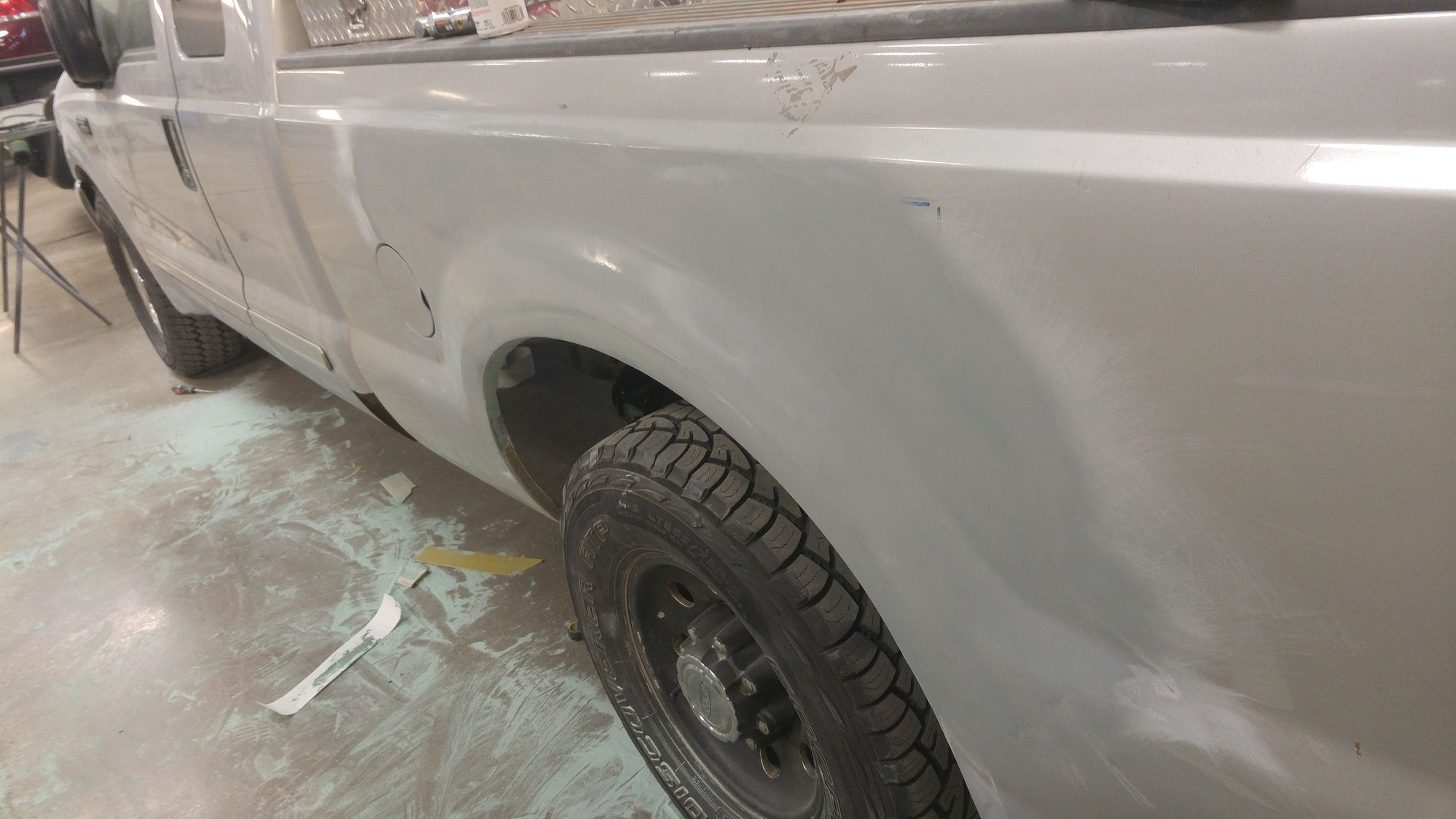

Well got anouther update for ya: im not as far as i would have liked to have been, but she getting there..... I got some body work on the door bottoms done... The drivers side are getting pretty close...I ended up getting a new leaf spring(which ill install on monday during my mechanical electrical class). My truck was leaning to the drivers side by more than inch and was driving me nuts and thats what my teach and i determined to be the problem....

Hey guys, she is slowly but surely getting closer to being done... Tommorrow i will hopefully get my new leaf on and she will hopefully sit even i got most of thw body work on the doors and the drivers wheel arch done today and got some guide coat on her... There is still some work on them but they are getting close....

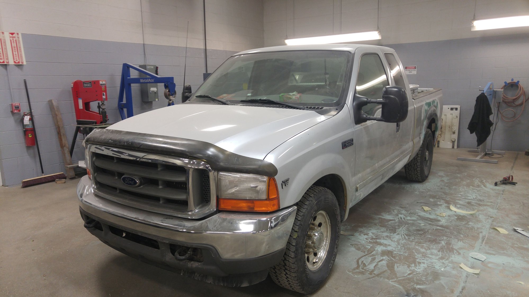

Hey y'all long time!
Here is how the truck sits now! Still some work to do here and there. Also did the interior all red and black. I love my truck.
