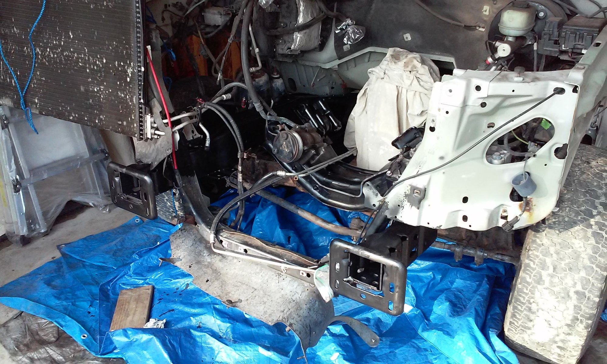

status update
hey guys got a decent amount of work done the last couple days to my truck... got the gas tank off, the fuel rails, started cleaning up the frame and got the engine out also since i live on 10 miles of dirt road and my dad has a black truck and car its impossible to keep them clean so i have decided im going to go with white for the exterior of the truck and a set of custom bumper ill make up....
Great work so far despite the rust issues you may have had it looks good just clean up frame a little and you be good to go!
