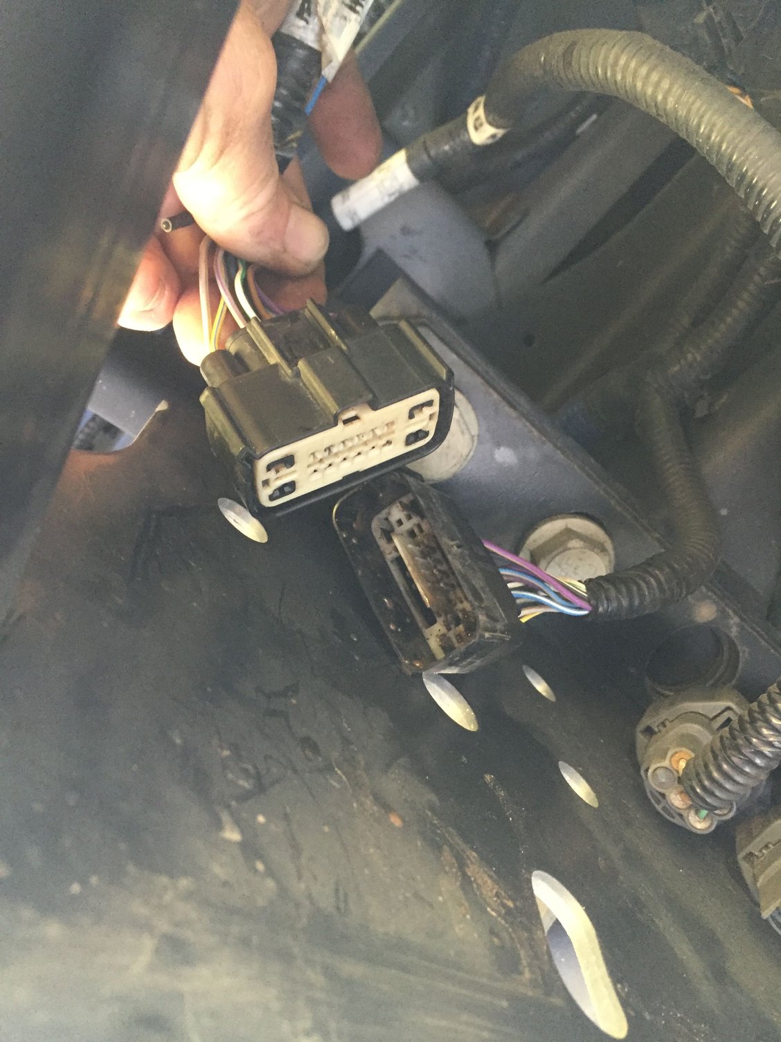

Problem solved
I finally got my camera working again. There are 2 plugs, one plug is to aid in tailgate removal, the other is on the driver side against the hitch frame, inside the frame by the spare tire.
Both plugs were saturated with water/dirt/mud. When I pulled the connections apart they both showered me in dirty muddy water and the prongs/sockets were soaked and showing signs of corrosion. I cleaned them up best I could, applied di-electric grease liberally, and plugged everything together and the camera signal is working. Picture quality is normal again.
