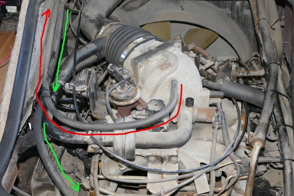

But now ..... there is a loud "sucking sound" from the engine.
I traced it down to a line that runs from the manifold to ?????. When I put my ear to it, you can clearly here the sound is coming from this tube. It looks like it has been replace at some time (looks like fuel line).
Then there is a larger line running from ??????? to two plastic boxes placed back along the frame.
The larger line is literally falling apart, but it does not seem to be leaking. I am going to replace it in the next few days.
So my questions ....
1) Is it normal for this large sucking sound through this tube? Did I just not notice it before?
2) What is the ???? device that the small tube goes into and the large one comes out off? Is it working? Should it allow this much air in?
3) What does this large tube do ( what are these two plastic boxes under the RV along it's frame)? I did not get a chance to see if anything comes out of these (maybe to the tank)?????
I have included two pictures. The first shows small vacuum line (red) going from the manifold to the ???? device (this is where all the noise is coming from) and the larger tube (green) going from the ???? device to the boxes under the RV. You can see the new coils and some new vacuum line (I used 1/4" fuel line) on the left.
The second picture shows the ???? device and the lines coming in and out. Behind the ???? device can be seen the cruise control device (yellow) and the cable comes out of it.
Thanks so much ..... Mike

I'm not familiar with the RV configuration but what you have pictured appears to be the EVAP valve and the hoses going back to the charcoal vapor canister.

Your truck may or may not throw a code for EVAP failures, like "insufficient flow" and the like. It may not have the sensors to tell, or it might not throw a code even if it does notice a problem.
The idea for the EVAP system is that while running, the PCM will open that big valve (unknown device) to purge the charcoal canister of any gas vapors, and burn them by routing them into the intake manifold by the smaller vacuum hose (red line). When the engine is off, any vapors that come out of the tank (under low pressure) would go to the charcoal canister and be stored. Once the engine is started the PCM will again use engine vacuum to purge the canister of any vapors.
You shouldn't be able to hear it, at least, I've never heard one standing near any. And it shouldn't be doing it all the time.
There's usually a purge solenoid, and a flow sensor. Not sure what that thing is you named the unknown device, but it sure looks like it could be the solenoid (valve)

The device is listed (check Autozone and Rockauto) as "Emission Control Canister Purge Solenoid" and is listed as "Vapor Canister Purge Solenoid/Valve allows fuel vapor flow from the EVAP system".
It looks like there is no flow sensor in this line since the vent line goes into this solenoid and then directly into the manifold (with a small vent line off the solenoid going somewhere). There is only two wires going to the solenoid.
I have the engine heating up right now. I will pull the wires off in a few minutes and see if the valve shuts. If it does not, I know there is something wrong with it.

Well the valve must be working.
I pulled the wires off the solenoid and the noise stopped ... put them on and it starts so the computer must be telling the valve to open.
Funny, the sound is loud.
I had the engine hatch open and the RV was running. When I opened the door (to enter the RV from outside) first thing I noticed is not the engine noise but this sucking sound.
Anyway, looks like I don't have a problem ... or if I do it is a broken line from the solenoid to the canisters or gas tank.

Keep looking for the real source of the noise - the valve could still be bad - internally venting the vacuum to atmosphere, for example. It kinda looks like a diaphragm being so big and round.
Gas vapors not being properly purged can be bad in an RV
