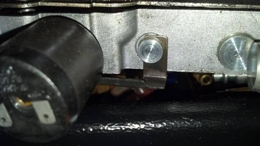

Check the EPC solenoid, make sure its in its bracket correctly and that the bracket is not broken, also make sure the end plug for the 2-3 shift valve is correctly installed, if it's in too far it can cause the shift valve to block the oil to the low band and you will have no reverse.

ok, the plug was in too far, I had to take the valve body off to correct that, so hopefully that should take care of reverse. While I have the valve body off, is there anything else I should look at regarding the other symptoms?
