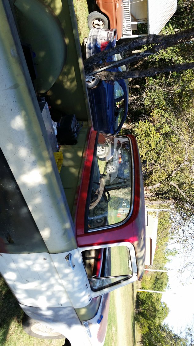

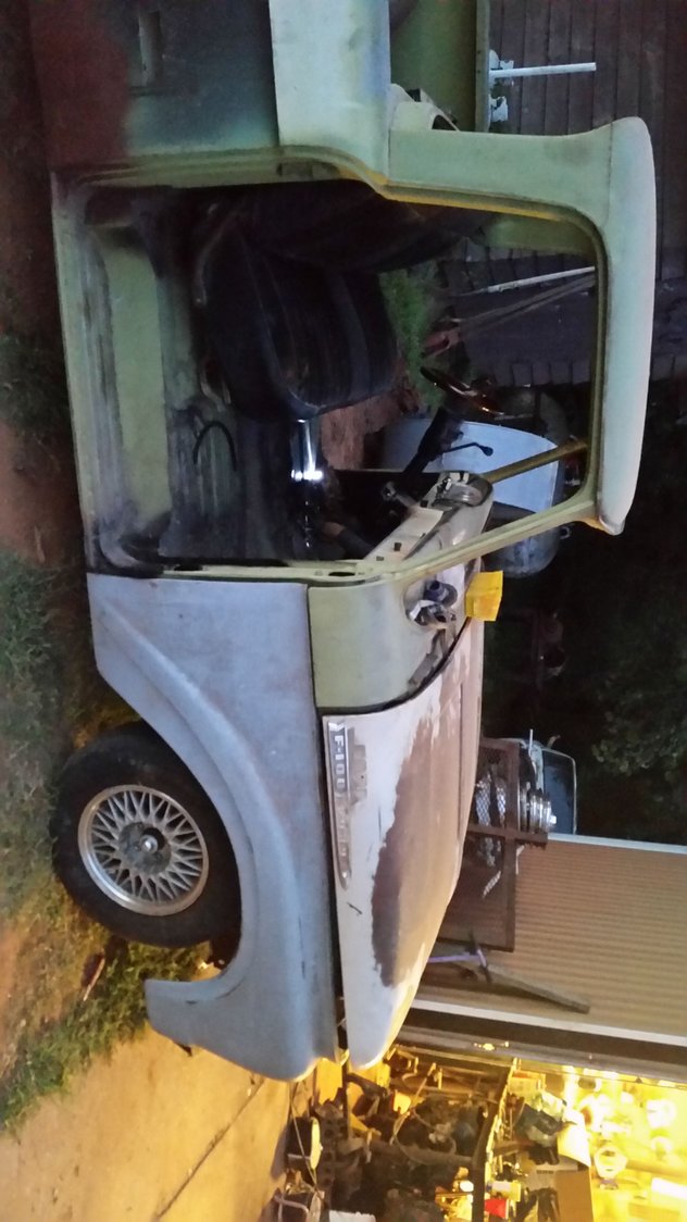

Kinda shows the ride height. I did push it forward one inch
With the glass in

Your wheel looks pretty centered and is the look I like so ill have to move my centerline forward another 1/2in.. Thank you all for the input and pics, I ended up emailing Helix about the detailed instructions and they gave me exactly what i was looking for. Im planning on getting the crossmember installed this coming weekend and will try to post pics as i go..
