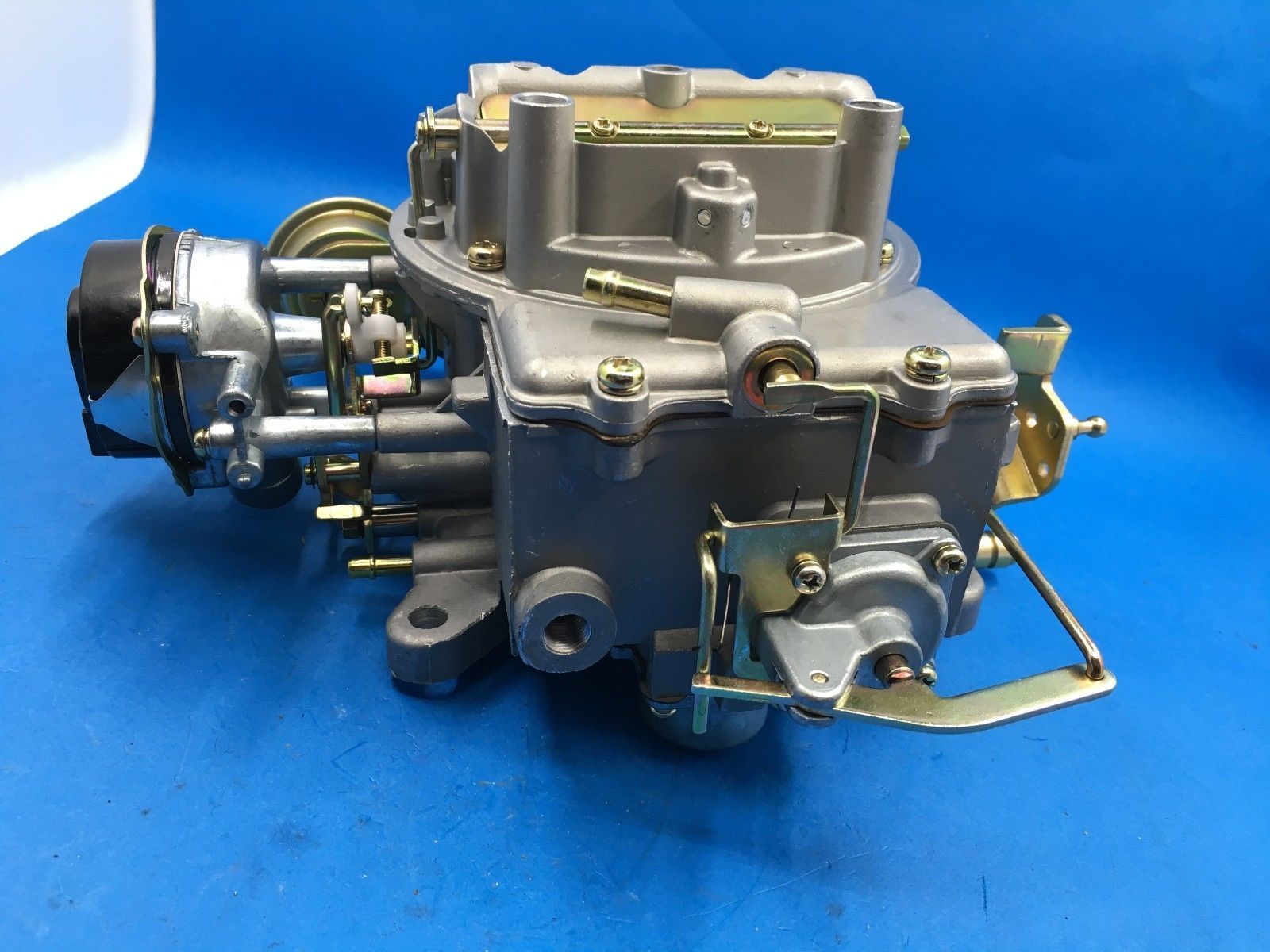

I know there are some obvious differences but it looks a lot like this motorcraft 2150 from a Jeep. Other 2150's look different from this. I wonder if a 2150 rebuild kit will work to fix it up. Check the choke pulloff diaphragm and other moving parts that are not included in a standard kit too:
