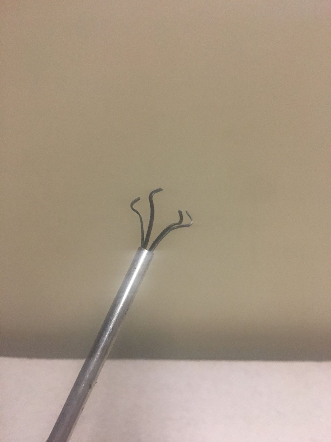

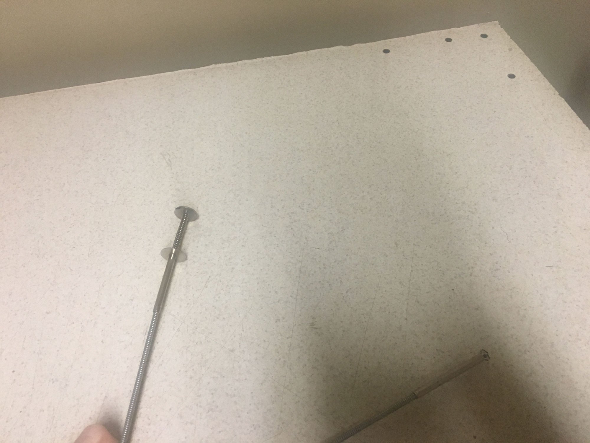

Here's a good tool to grab lost items from dark holes. It's never let me down.
