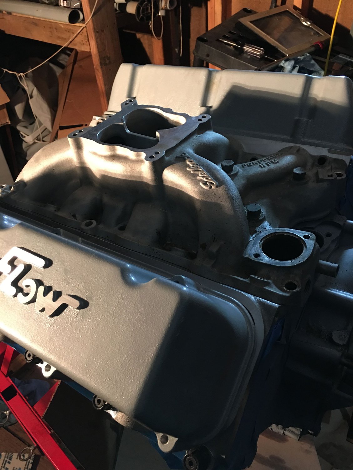

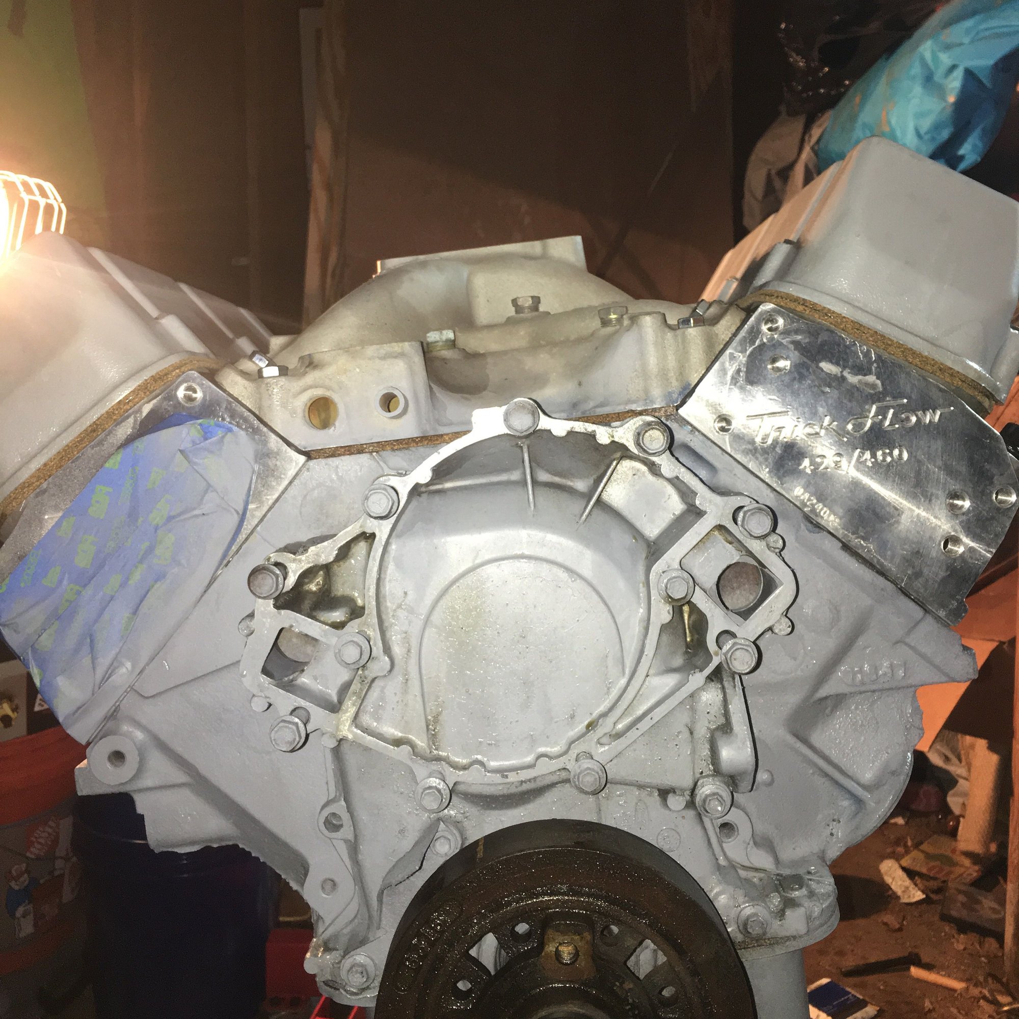

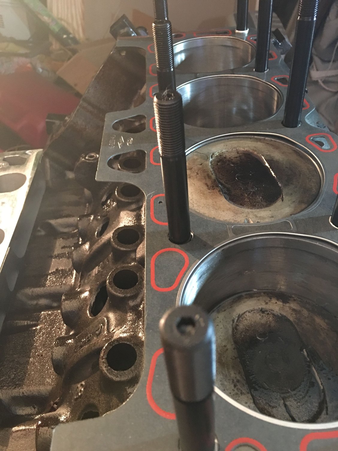

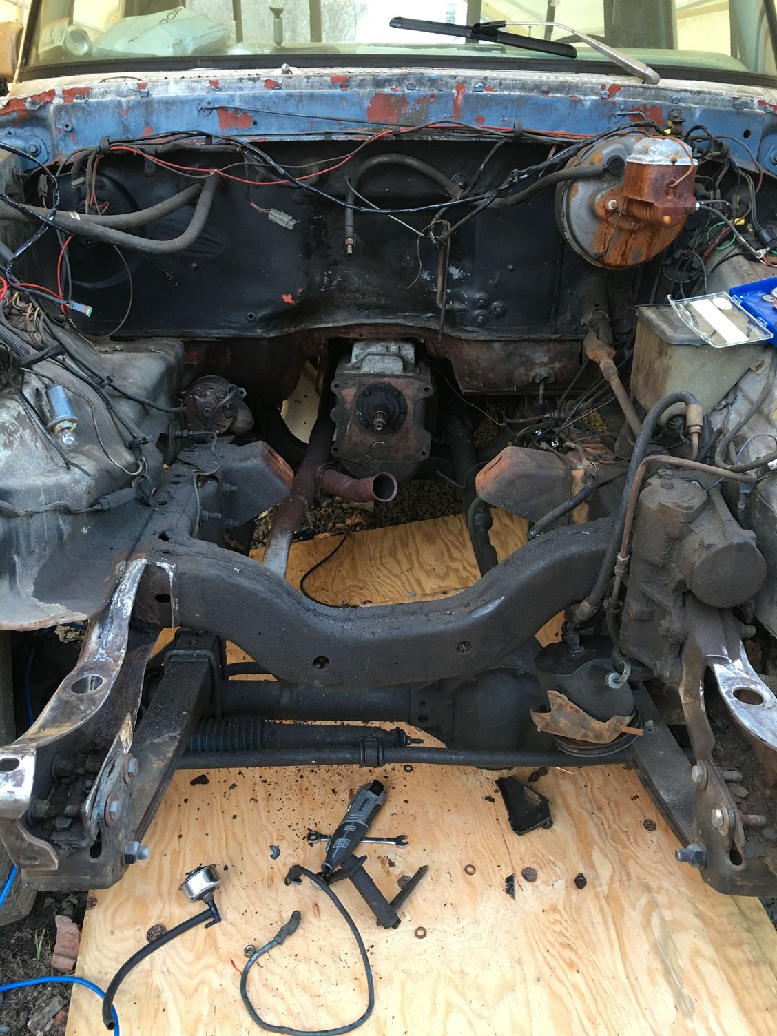

Good evening. I am working on swapping an EFI 460 into my 1978F250. I have rebuilt the engine for carb use new
heads etc. I am just about the point of installing the alternator (1 wire powermaster), water pump power steering and tensioner. Does anyone possibly have the 7.5L belt diagram handy. The guy I got the engine from said it was a 1995 F350 plow truck. It had an air pump that ran off a separate Vbelt the rest I think was a serpentine belt. I switched phones and lost the pictures of the engine prior to disassembly. I do not need modern emissions because it's going in a 1978 so the air pump will not get installed.
Thanks!!
