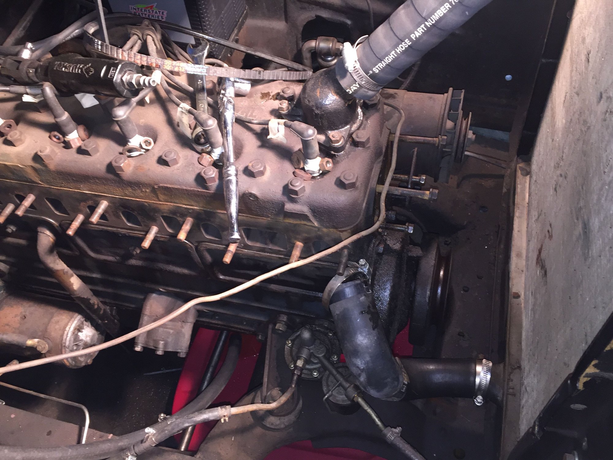

Could not wait till Thursday, Woke up 4am to pull those four bolts!!! Water pump off in box!

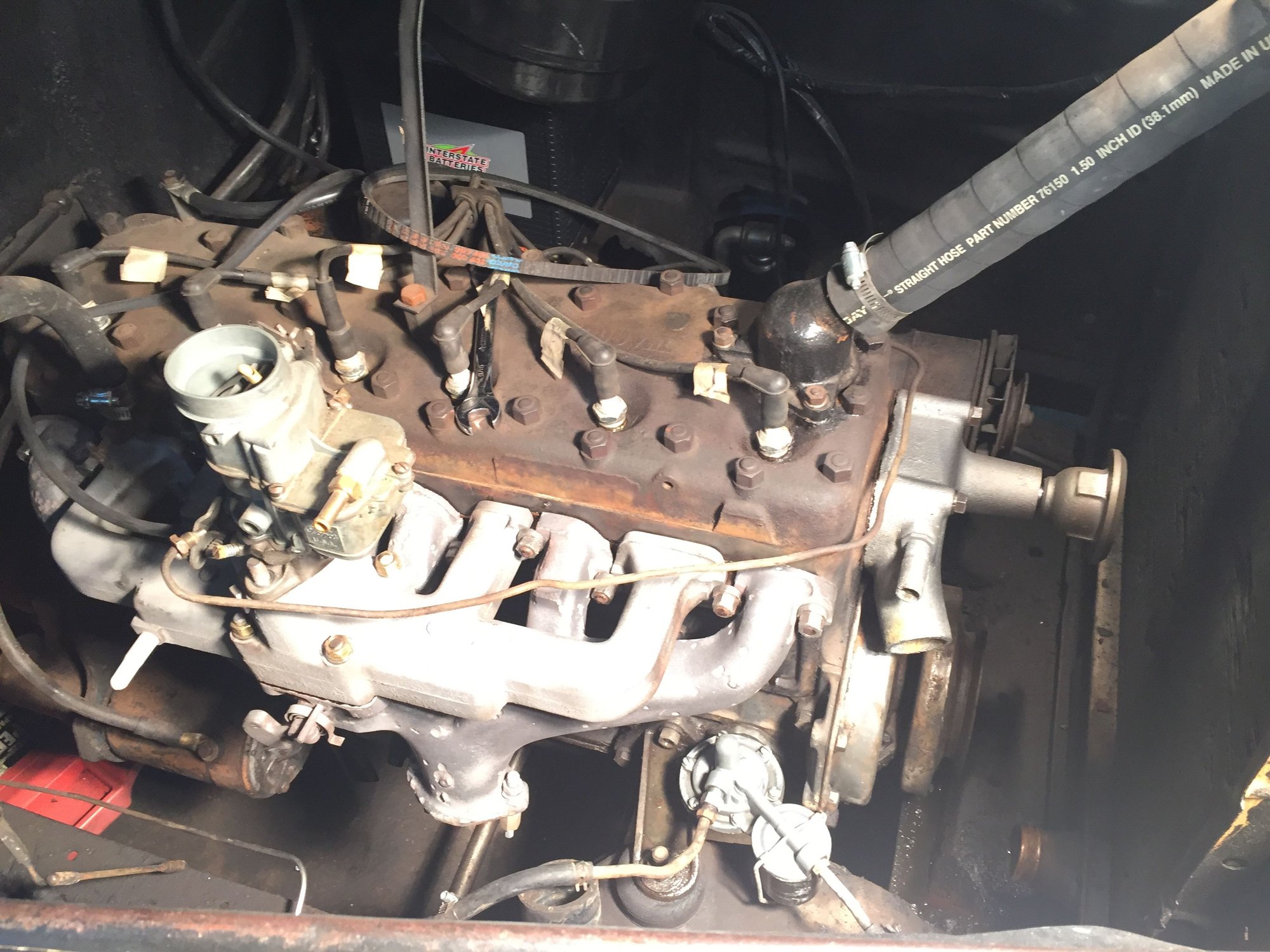

Water pump is back and on the truck tonight I put the intake and exhaust manifold back on the carb... AND DRIVE!!!
Question tacky gasket sealer on new manifold gaskets? yes/no

Putting carb back on previous owner had 4 gaskets under carburetor any reason to shim a carburetor with that many gaskets?
I think the carb needs to be spaced fairly high off the manifold. I know mine was using several gaskets.
And the parts book shows B6A 9447-B as the gasket with a quantity of 6.

Thanks sir I didn't tighten nuts I'll put them back on in same order it came off
