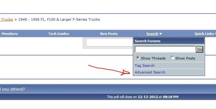

Need some help navigating website looking for past post related directly to steering gearbox when I type in the search it tends to want to jump out of the classic trucks
You need to use Advanced Search. That allows you to limit your search to this sub-forum.
