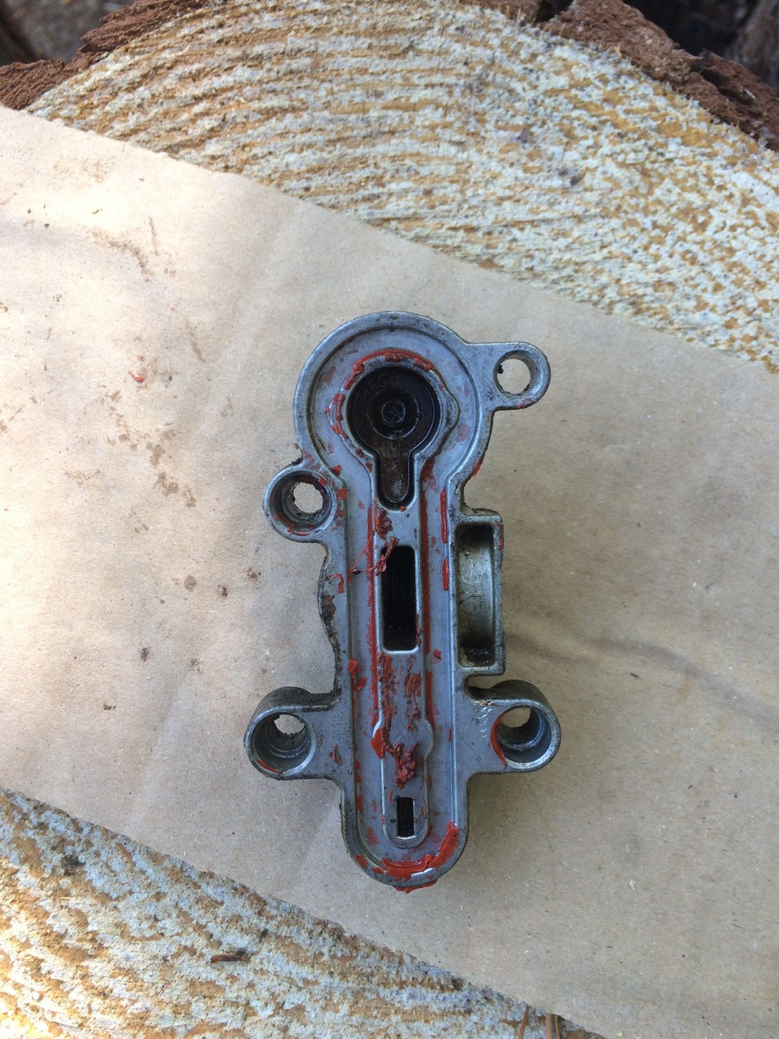

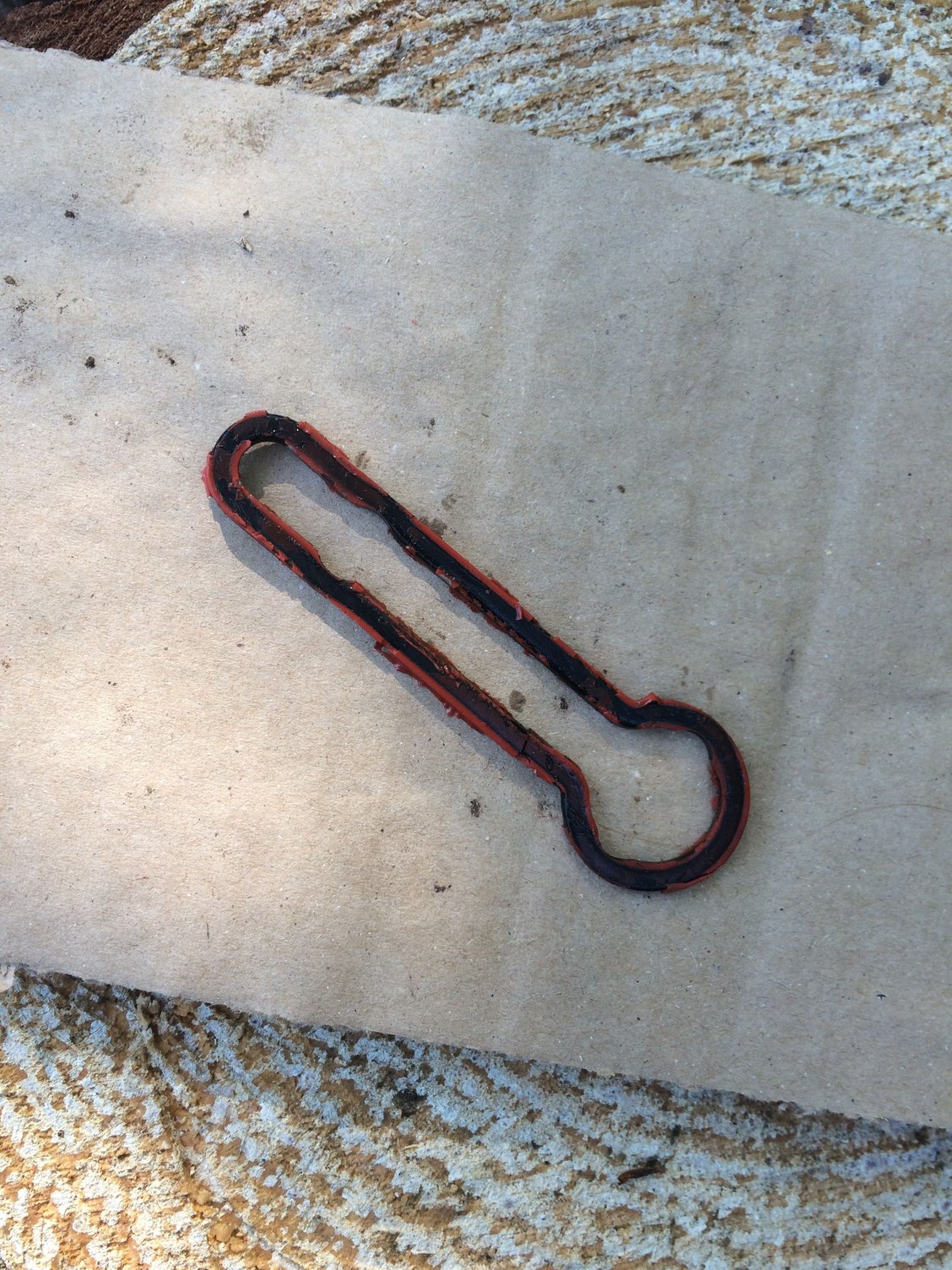

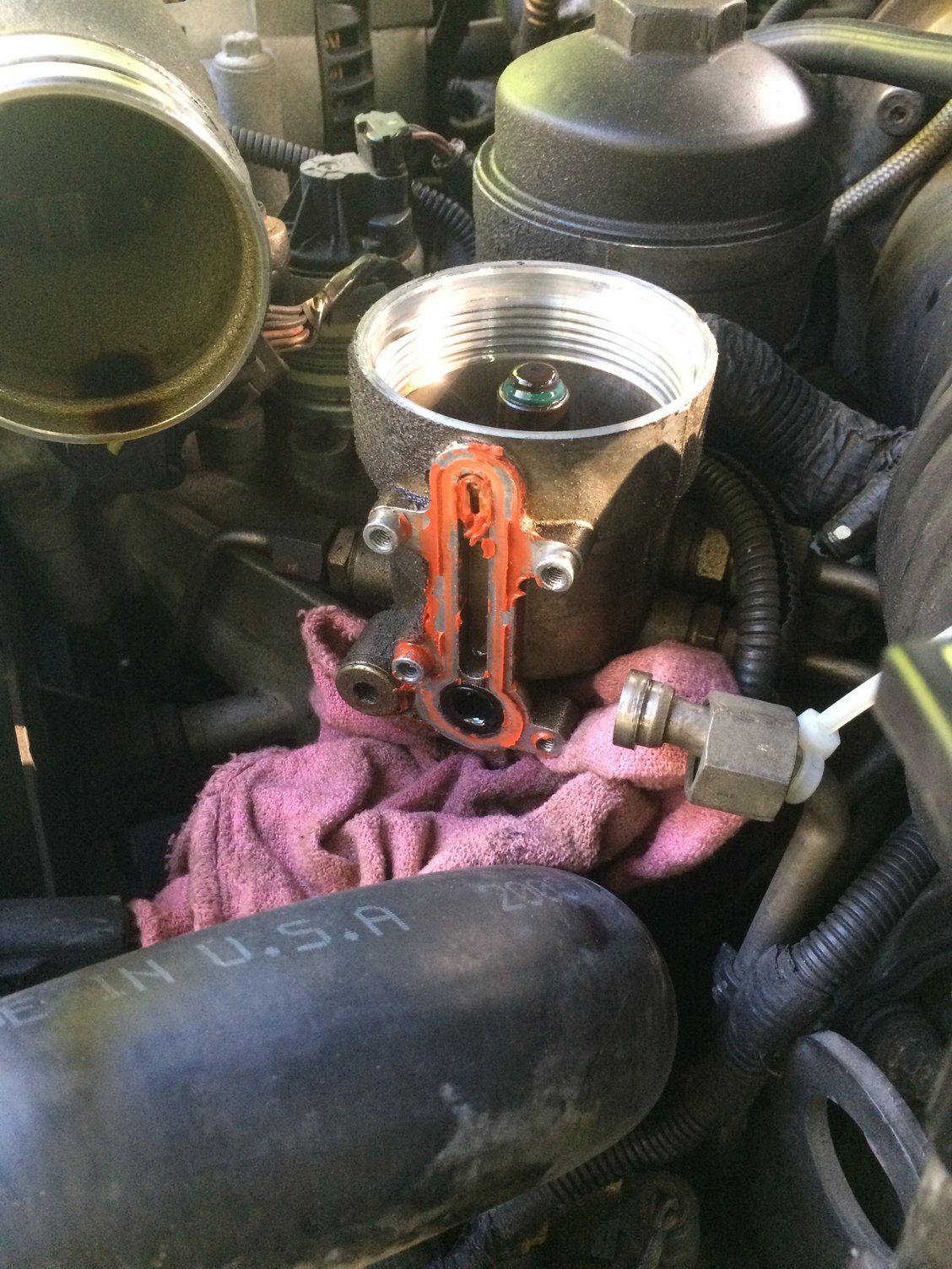

I know that I don't visit or post here a lot, but this is a very useful forum- especially for the inexperienced. For any and all newbies here, if you here the phrase 'blue spring upgrade' please research it. And it is worth doing for a $50 fix. DO NOT do a "cheaper" fix such as RTV because you believe "it is just as good". I have never did the upgrade or did anything with the fuel regulator since we have owned our 350. However, whoever did do the work did the "cheap" route. I am surprised that fixed lasted this long. Here is a visual for when you fix something do it right the first time.

WHO IN THE HELL WOULD EVEN THINK OF, LET ALONE DO THAT TO A PART OF THE ENGINE THAT IS SUPPOSED TO SEAL IN FUEL UNDER PRESSURE? HACKS.

One root beer to many to look like that, but on the bright side its red.

Who would do that? An inexperienced diesel forum member who used a "how to" thread, maybe buying a spring alone without the gasket kit, or maybe just trying to stretch the spring as some did with 7.3L trucks. (Stretching a spring only breaks steel molecules making the spring fatigue shorter). They probably worried about a leak, or a "fix" because it did.
It could have been worse, no o-ring at all. BTW, did it ever leak?
The only reason a Blue Spring or any spring replacement is necessary is if the fuel pressure is out of spec.

After looking back at the closeups I see the original gasket is actually broken, hence the red silicone 'gasket'.... prolly trying to save $20 bucks by just stretching the existing OEM spring and nothing on hand to replace the o-ring with after breaking it taking the cover off.

Have you checked the fuel bowl/filter for pieces of that 'redneck gasket'?

I'm not sure why or who? I just know it wasn't me. I grew up around vehicles and the montra was, "If you're gonna fix it, fix it right the first time." We bought the truck used in 2011, and this is the first time I cracked that opened. When compared to the new gasket, the old one seemed flat and brittle. I have put too much time, money, and energy just to see stupid stuff like stop my truck.

We made sure to clean the bowl and double checked the filter. Whoever opened that up the first time possibly use channel locks and not line wrenches.

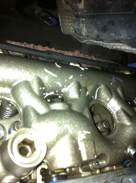

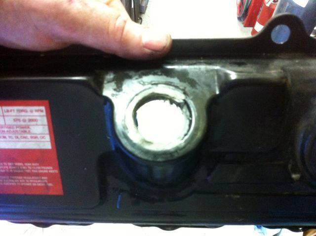

Could it be t he clown that did this to me?
One of these two guys
did this to mine.
They had also used the same grey RTV on some flat O-rings in the cooling
system. You can see some of it in the cooling fins inside the oil cooler on the
coolant side in the video. They did it to the block drains and the outlet pipe
for the heater supply. All cases of flat or missing O-rings.
I cooled down a few weeks and the next time I was near that dealership I
had around a 30~45 minute chat with the service manager. He turned around
and offered me the job. I thanked him, But said no thanks.
I think that is what happens when the lot child wants to move from washing
cars in the lot up to working on them. I have sense found other "Issues".
