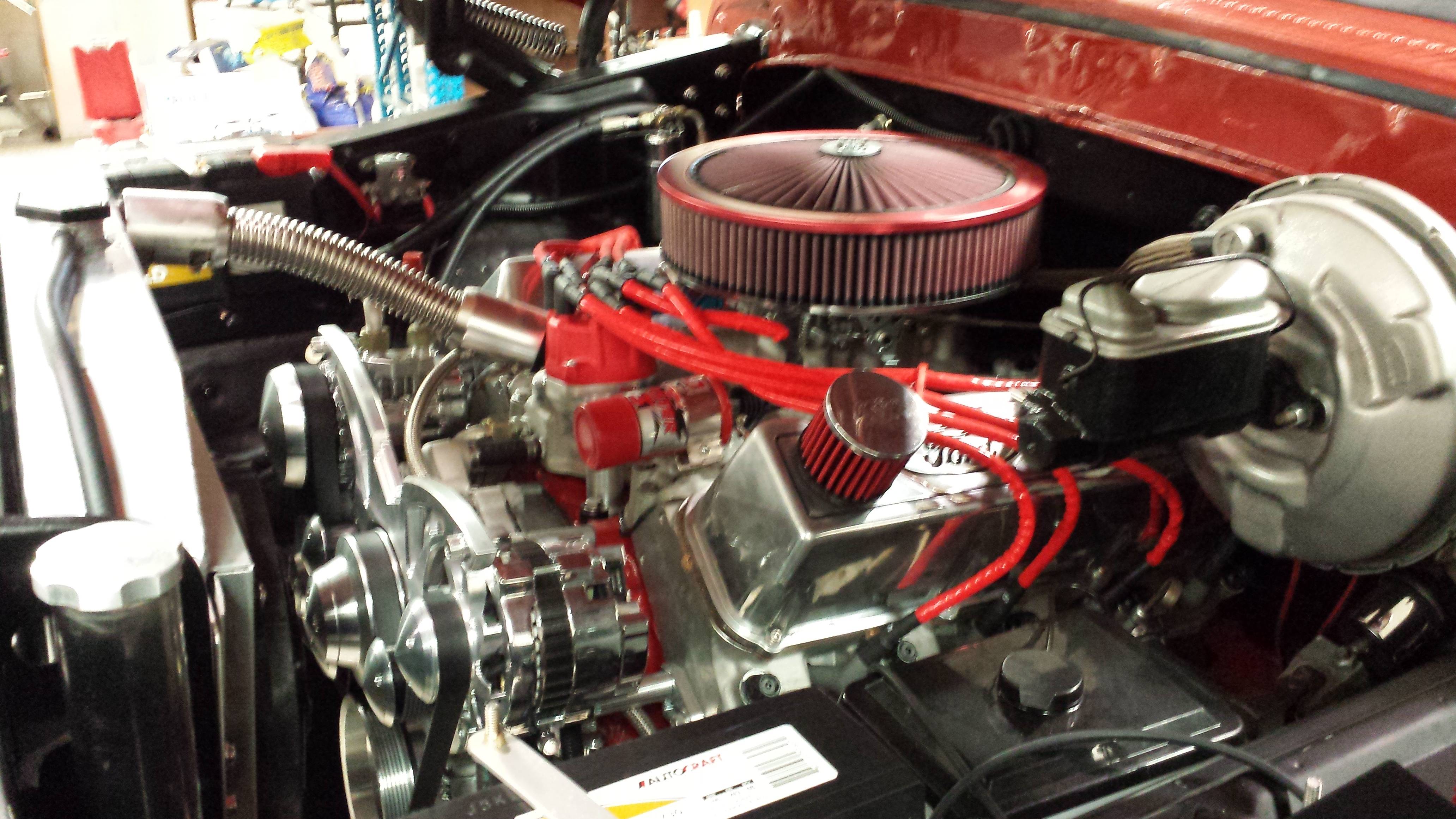

What hail destroyer said!.....was a worn out but capable 460, now a 650hp+ 521 strokin' diesel killer! Hold on to your lug nuts!
Attachment 288662
btw: I own or have owned every diesel truck, 7.3, 6.0, 6.4 and the 6.7's....my fav's are the 7.3 and the 6.7. If your a diesel head (nothing wrong with that at all) I believe there are several who have made these swaps, it is possible. Your real question is just how much work are you ready to do or how much money are you ready to pay?
