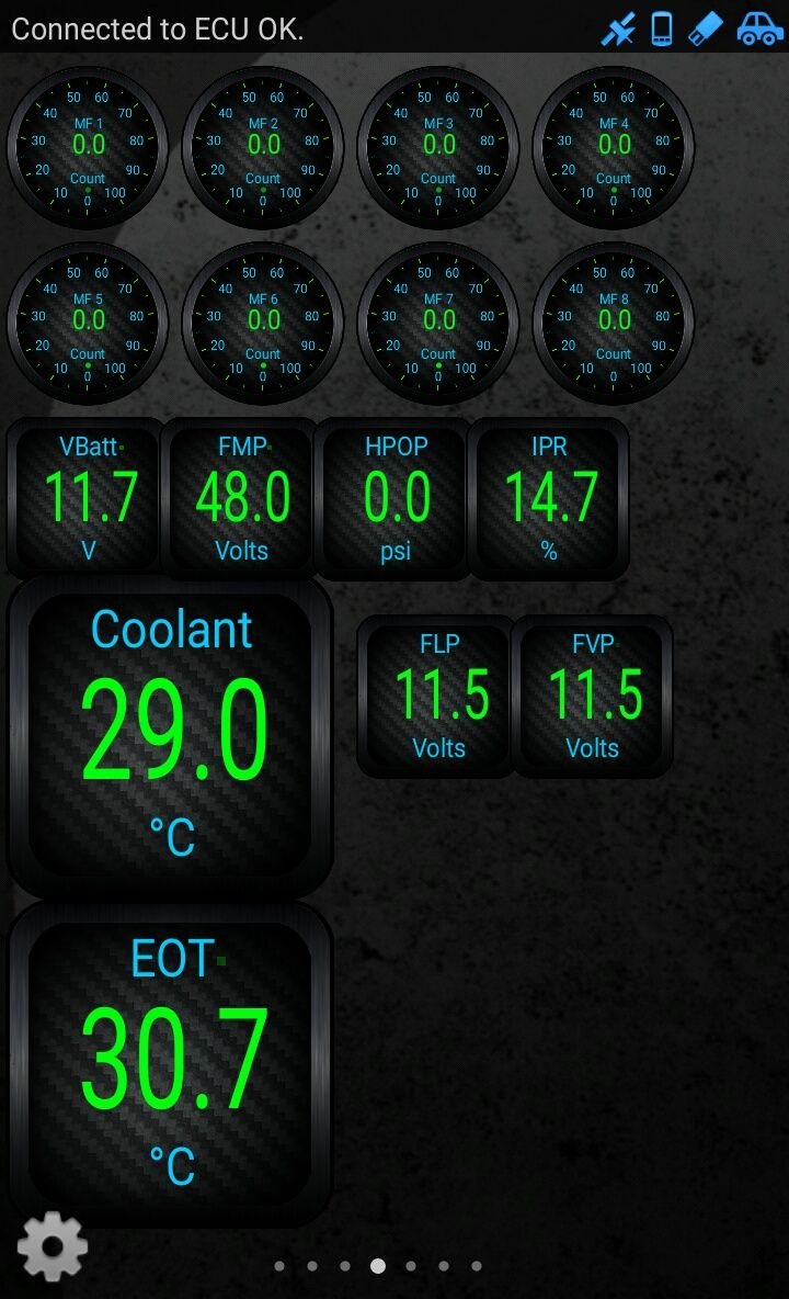

So below is photo when I got in truck with key on no start.

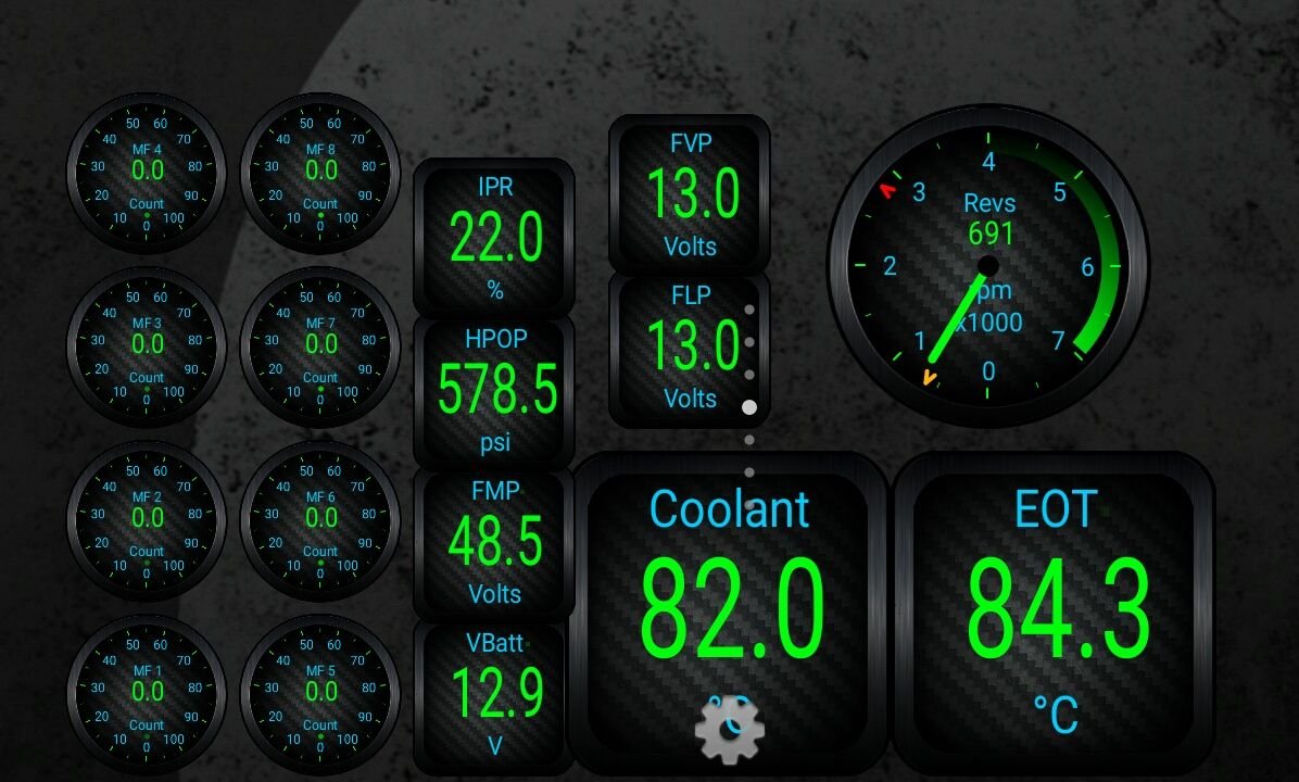

Cold start engine running below!

After ten minutes to work also when I'm not loading or throttling the truck I did notice the FICM defiantly drops down but when I put truck under load it comes back up. Damn it lol but okay its a start and at least this way excuse to get Atlas installed.

FICM reading 42V means you need to call this guy today, he'll do the Atlas for you:
FICMRepair.com - FORD Powerstroke 6.0 FICM Repair, PHP Tuning and Truck Parts
Not for sure the cause of a no start, so we still need to see that same screen cap at hot idle, and if possible while it's cranking during a hot no-start.
88*C would be operating temperature. Does it ever get to that level?

We have your Key On Engine Off FICM voltages, but not your voltages during cranking when it is not starting. My strong guess is that your FICM main power voltages during cranking during a no start condition are dipping materially lower than the 42 volts.
Regardless, what we know for an absolute fact is that your FICM is damaged and needs to be repaired. You can use the numbers from your testing thus far to fill out the intake form available from Sending Your Module In and ship your module on in.
If you can't afford the downtime, you can also just order a pre-programmed and ready to rock FICM using our Exchange program. To start that process, just visit Exchange Program.
As you are having a FICM issue though, PLEASE yank out your alternator and batteries and have them bench/load tested to ensure that they are okay. SOMETHING caused you to have this issue - finding out what will prevent a recurrence. Just because an alternator is charging does not mean that it's good.

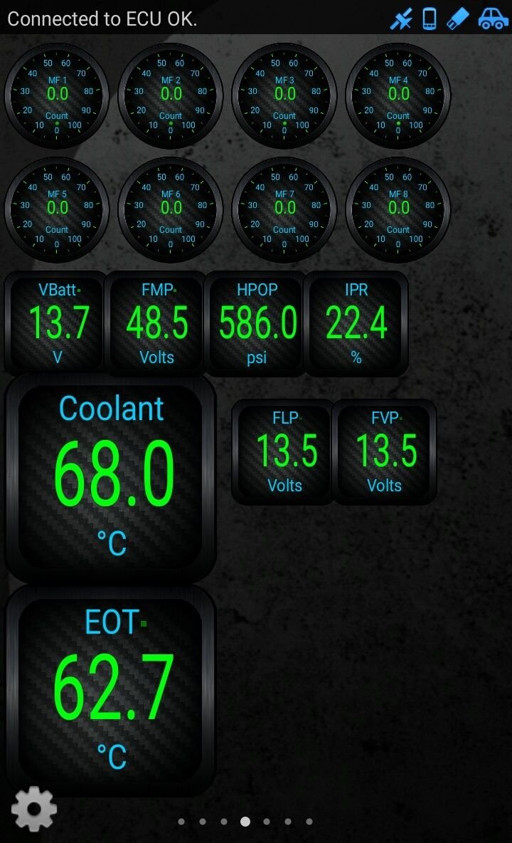

Drove truck around for about 20 minutes last night and here is my readings. My Coolant temp climbed to 85 but slowly dipped so maybe taking it on the highway it would come up higher but from what I understand at least my deltas are not too far gap of one another or I would have more issues.
Question though wouldn't the coolant drop overtime when fan comes on and engine cools down. I mean it would go way down because it's always doing to be working to cool engine/oil but if it climbs too high that would be bad. Is it really bad if it doesn't climb to 88* normal operating temp but it's close like 85*? I can change thermostat was thinking of doing mishimito one anyhow heard good reviews and when I scrape the money I will replace radiator with mishimito one as well. Right now though my focus is getting truck running normal.
At least as normal as it can be for now.
After that drive last night I drove truck home shut it down and started it back up few times no issues. So far not able to repeat no start issue which probably won't happen now until I'm out and about leaving me stranded again lol.
