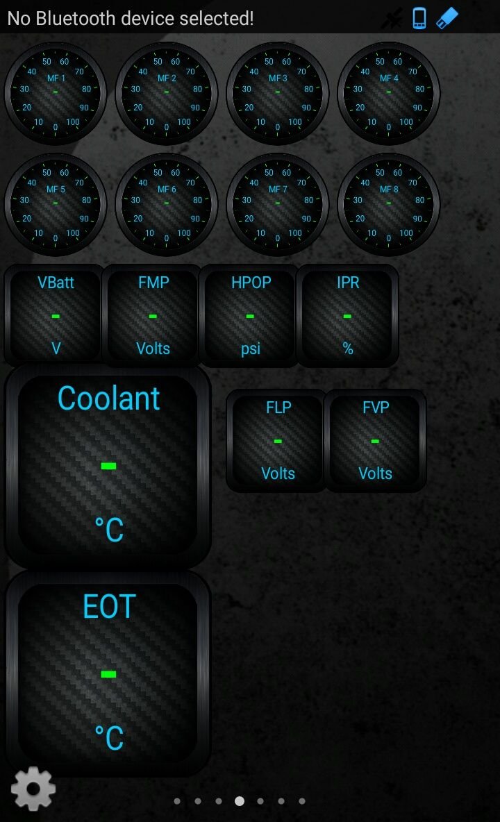

Okay done I also created my layout so far I have EOT, ECT, IPR and ICP, FICM which I wasn't sure which pid would give me the voltages I needed so I added all three for now, also have cylinder misfire was thinking this would tell me if my injectors were not working? Unless that's not accurate but see my screenshot layout let me know if you think I should check anything else.

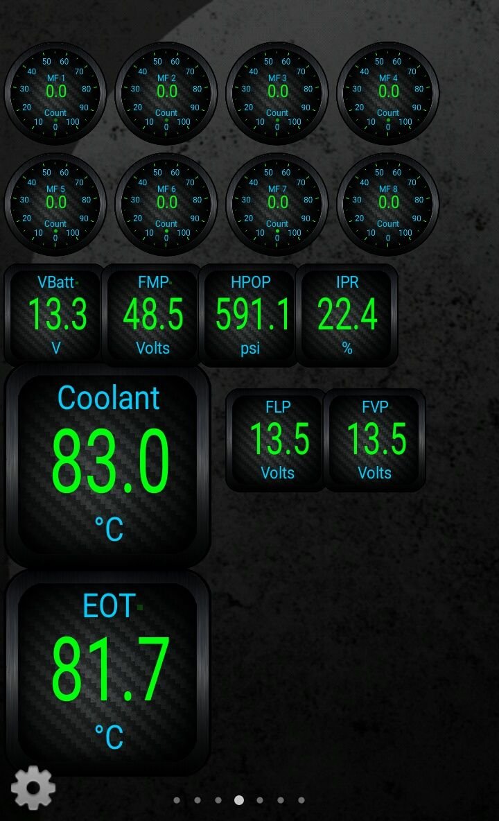

Okay got adapter managed to hook it up tonight for short test but clearly seems everything was okay but truck wasn't at full temp yet either. So Friday or by this weekend for sure I should be able to drive truck around long enough to bring it up to temps.
I'm still not finding that other IPR pid only the one for duty cycle.
And then my ICP so on my layout the HPOP is IPR duty cycle and ICP is obviously ICP.
My FICM voltage at startup when cold was about 43 and climbed up to 48.5 think was the highest I seen it go in a ten minute drive.
I shut truck off started up immediately but again didn't get it to full temp.
Deltas look great and voltage on battery steady 13 or so.
See photos of screen shot.
In addition though I pulled codes even without a Check Engine light I have P0667 which is Cylinder #7 Glow plug Circuit or so the search online says so. Would this cause no start like I had or no because faulty glow plug harness or glow plug itself won't keep it from starting unless it was more than one?
If anyone knows of custom PIDs so I can load those in for both IPR readings that would be awesome. Immediately on first startup though my HPOP read over 600psi.
Any thoughts so far or should I defiantly test longer?
Your FICM volts shouldn't be dipping down below 45 - like ever. That said, I am skeptical that this is the cause of your no start issues (though stranger things have happened). We'd need to see your values when it is not starting to get a better idea.
Ultimately, I'd say that you have a FICM issue minimally. As you aren't finding anything else wrong for now, you could certainly start with the FICM as we know that it's bad at least. Thanks for the consideration!
