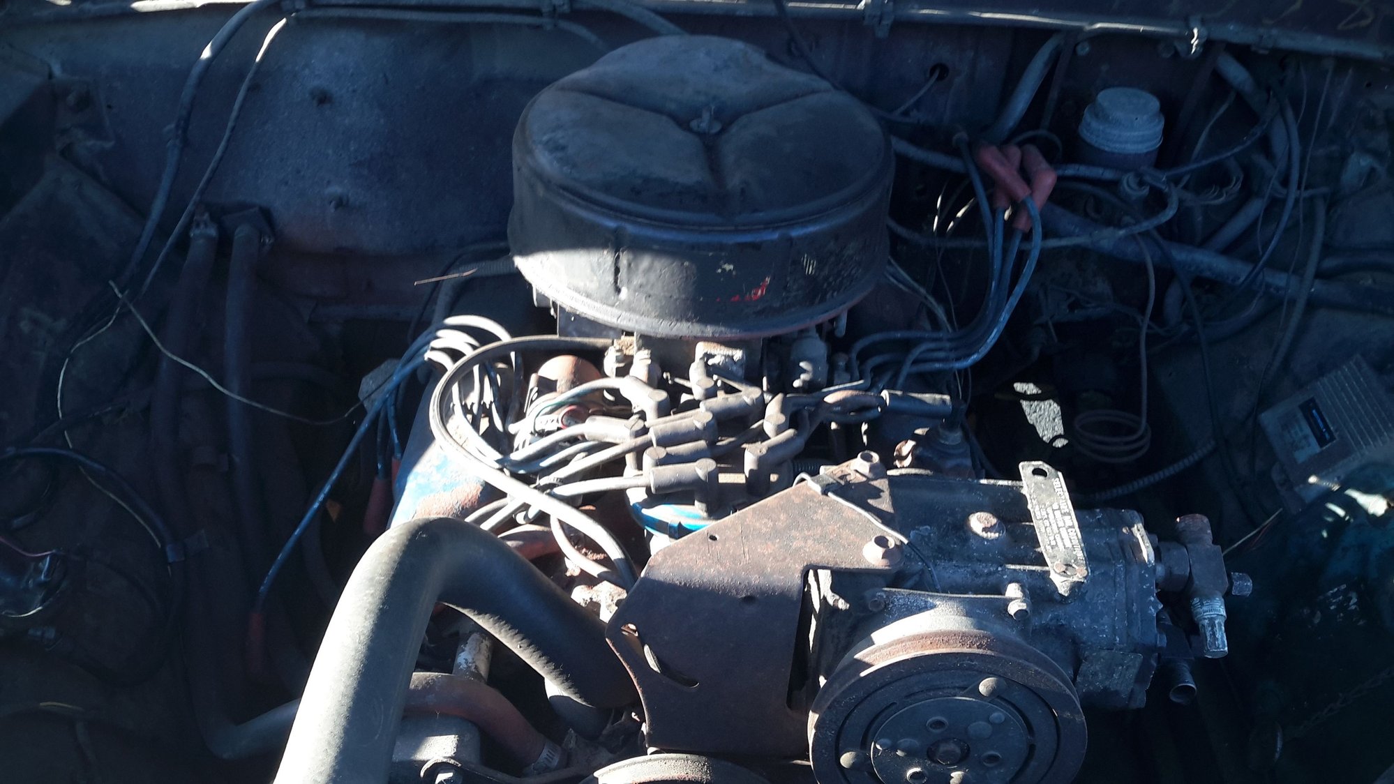

Thanks for info, but more poking around seems that there was a transplant at some time. From the valve cover color discussions here (gold pent shaped, blue rounded etc) and that the labe
l on driver side cover says 302, meets 1977 emissions stds
