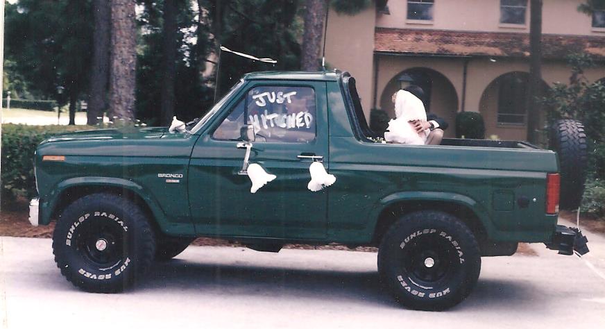

I know this is a very old thread, but some may search for this topic that weren't around back then.
I used to take the top off my "86 regularly, never had issues with leaks, and my buddies would usually fight to get dibs on riding in back. We even drove off from our wedding topless: http://www.pastordrew.com/WeddingBronco.jpg
The bolts were a pita to remove/replace due to their number and fine threads, I wish I had thought of BillyBob's idea of swapping them out back in the day
More often than not I removed it by myself since it is only a 2-man job (my body + my brain =2). I once had it on my back as I was backing out the tailgate and went a bit too far, flipping it off the back of the rails upside down onto the ground. d'oh! (my brain was on break at the time). I was extremely pleased to discover how tough it was, not one thing bent or broken. After that I rigged up a hoist system in my lean-to equipment shed.
