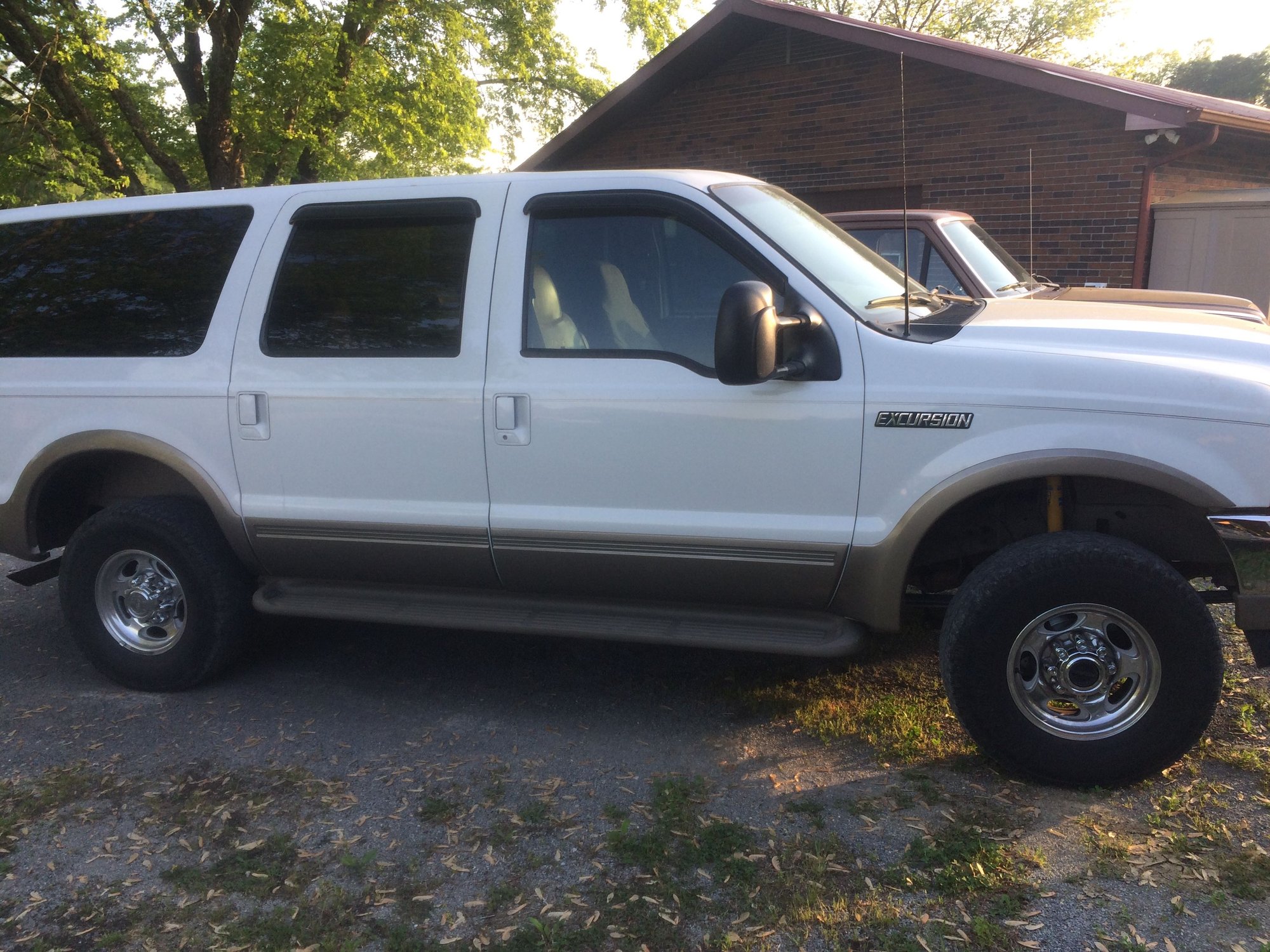

Springs and Shocks done
Here is a pic with the V/B springs and new shocks. Also replaced brake lines, pads and front calipers.
After springs and shocks
Might be getting a white grill from a 99 SD. Friend is looking for a chrome one for his truck.

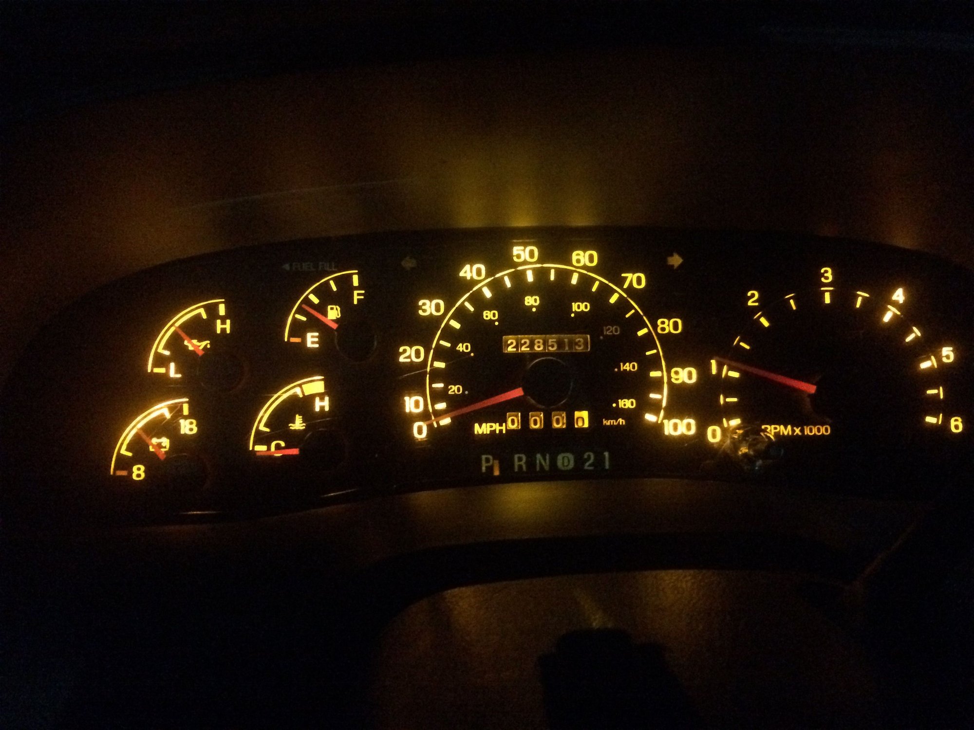

LED Instrument cluster lighting
Just got the instrument cluster fixed up. Some bulbs were burnt out, so went ahead and replaced with amber leds. Of course I had to modify the guage face sheet to remove the green tint. That took awhile and looks like I missed some spots. This is the first time I had it on in the dark, was just using backlighting while doing the work. Well, hopefully I can get the cluster out of a wrecked one and will try it again. This time I know what to expect and hope to do a better job. Some variation in lighting is the phone camera, some is hotspots of using leds. But I think it looks pretty good.
