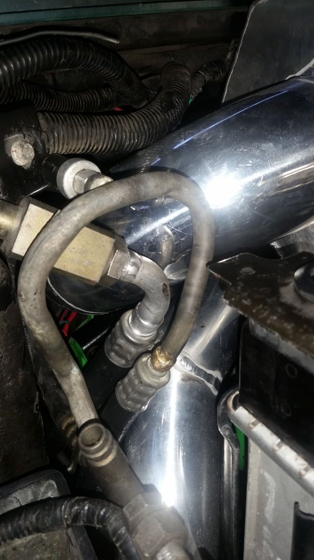

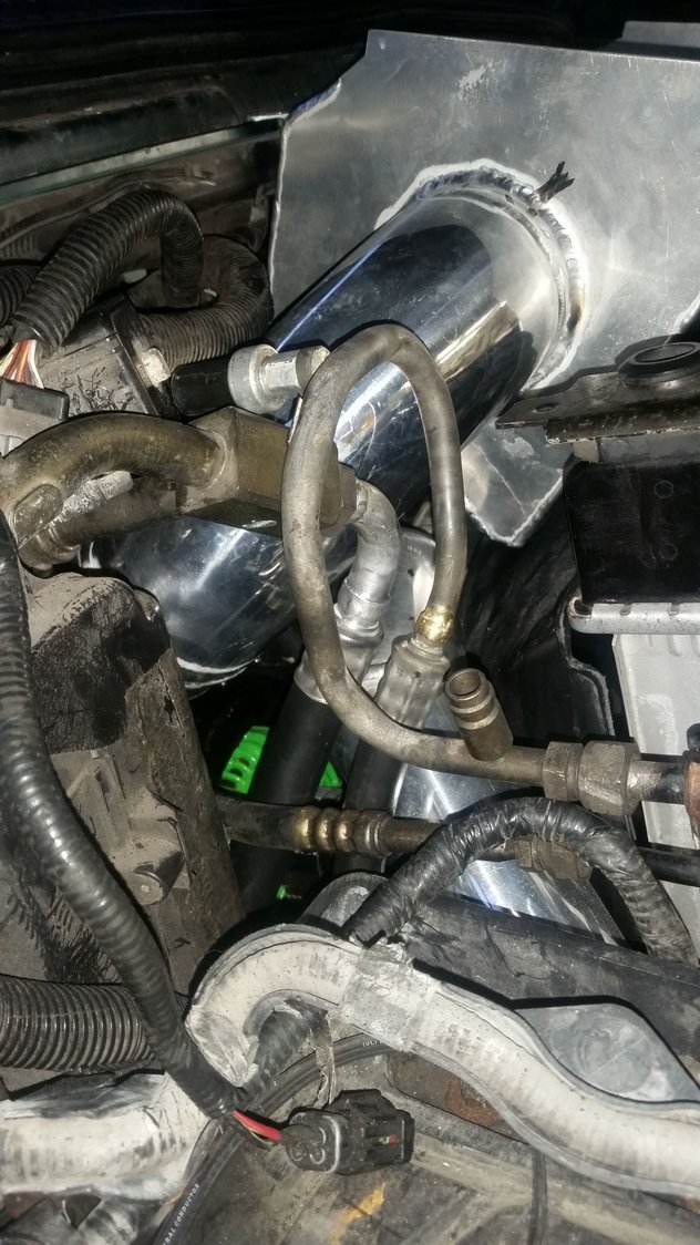

Well, i think i got my most recent nightmare out of the way. Definetly not an enjoyable part. A/C lines are in and barely fit. There is no doubt in my mind that i have used up every possible inch of space on this side of the engine bay. I never would have thought this part would have been such a pain in the *** and cost me that much. The final tally on just the a/c line assembly came out to $250 bucks

We have the engine in and just finishing up the custom stuff now. This is slow and not cheap. As pointed out, getting A/C lines done up right will cost. My guy is very particular about how he does stuff. Wants everything to look neat and factory. Plus, pay now and do it right and don't worry about it.
