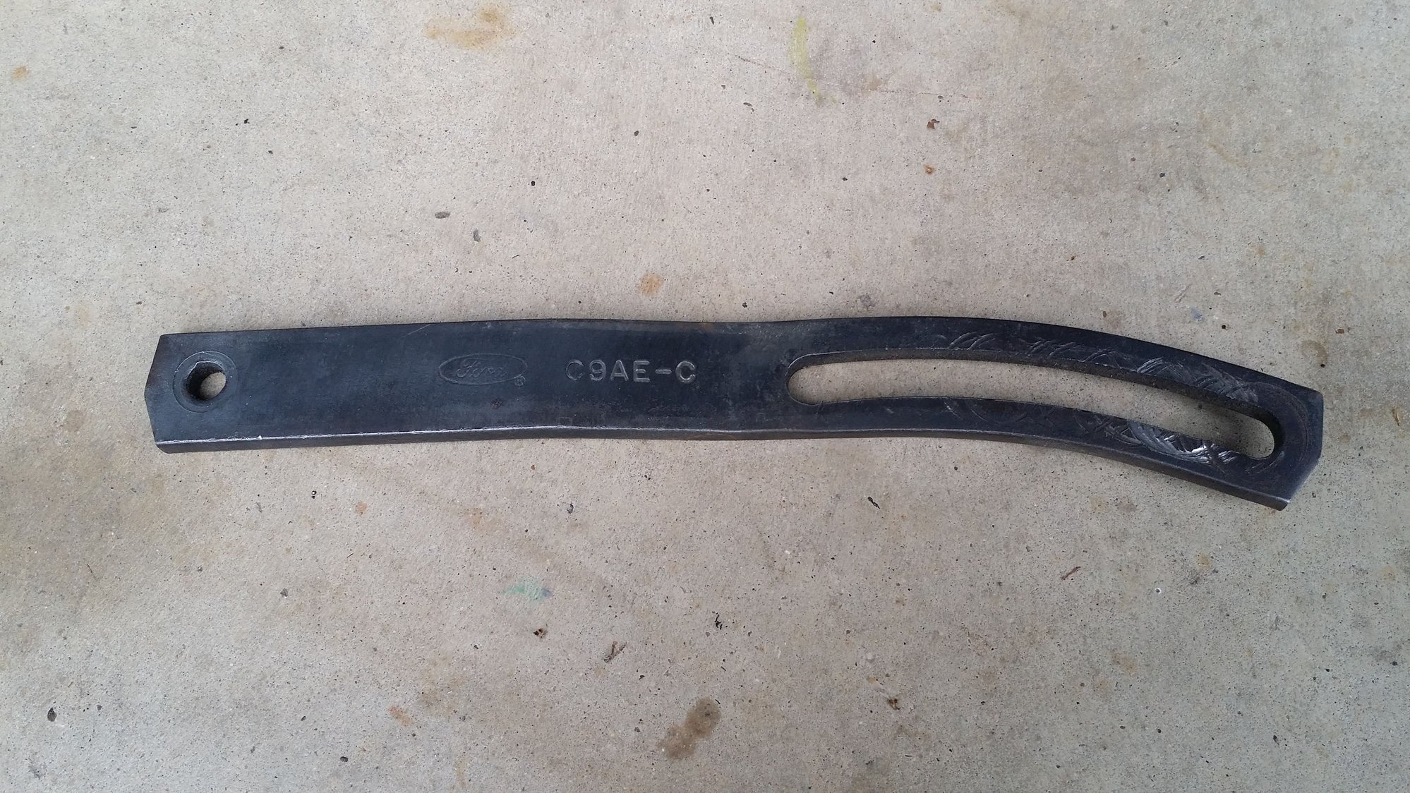

The only number I do know is for the lower alternator bracket for a 240/300 engine. On my '69 240, the lower bracket number stamped on it is C9AE-C.
This is my original lower alternator bracket.

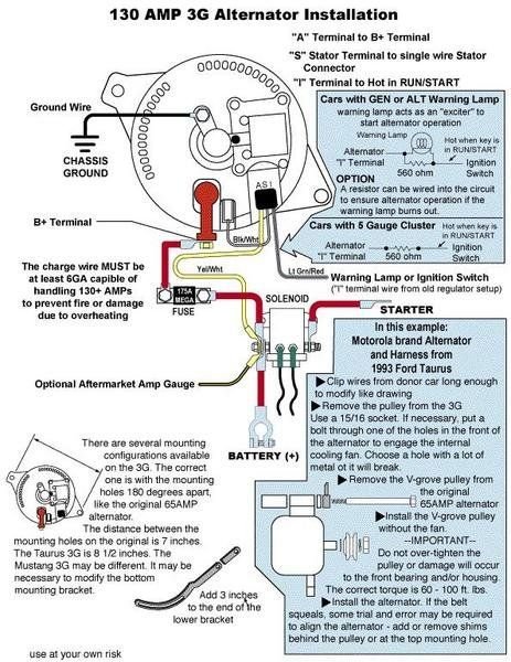

This bracket will need to be extended for the installation of the 3G alternator. In the following instructions, it shows to add the extended length on the end of the bracket that attaches to the engine....

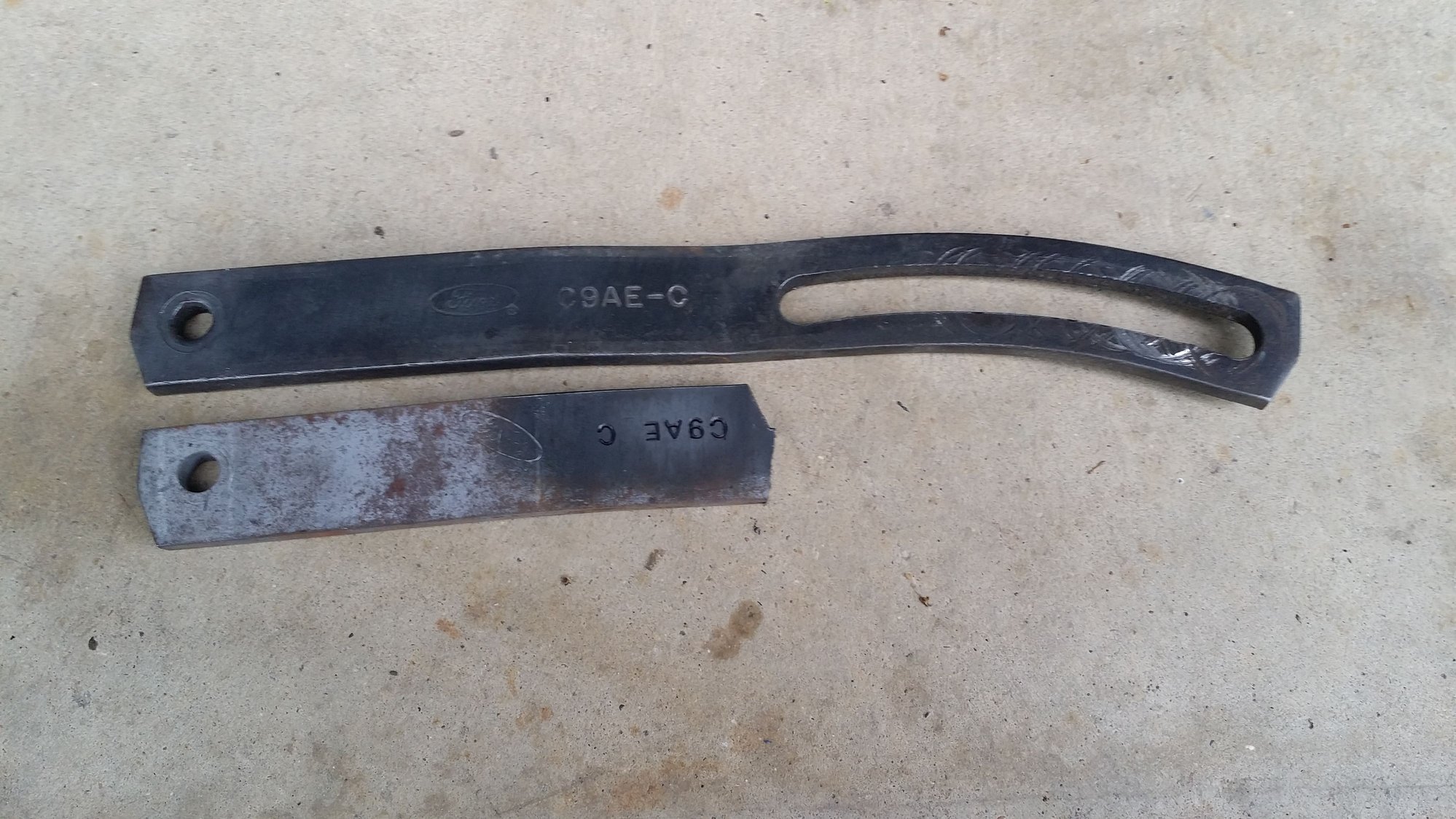

....I went a little different direction and didn't do it like this. I extended the length of the slotted end. I didn't want to cut or alter my original lower bracket. I found two lower brackets at the wrecking yard with the same identical C9AE-C stamping on them. I cut the slotted end off one of the donor brackets and butt welded it to the slotted end of the other donor bracket.
Slotted end cut off one of the donor brackets....
....and I welded it to the slotted end of the other donor bracket.

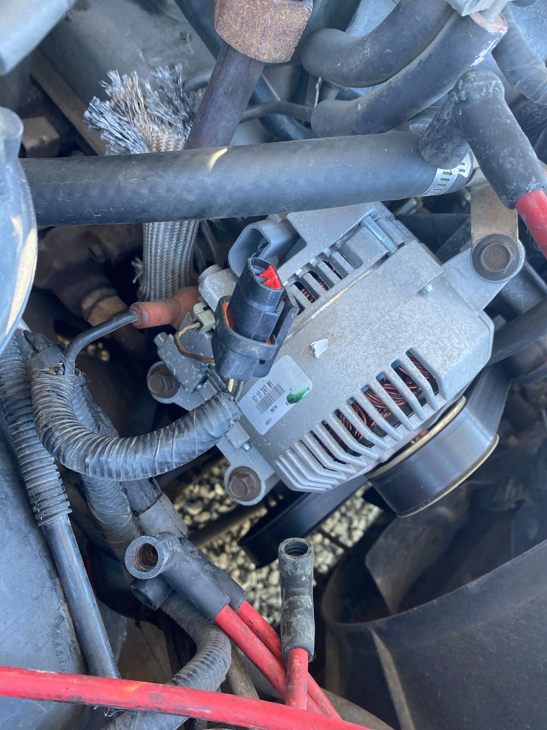

Hey guys I hope I can get a response promptly but I found this at a junk yard and think it would be cool to use a 3g alternator for my 86. This is a 96 f150. Can anyone confirm this to be a 3g and if it’s worth picking up even if I recently put a new 2g on my 86 bronco? Thanks

From the picture it does not appear to be the correct bolt pattern - won't bolt up to the old style brackets. Try Mustangs, some Taurus models, and do a search to find donors. If you look at the pulley end you can see a series of holes that will indicate the amp rating. Keep hunting...

Yeah you don't want that one. Has to be the swing pivot style case
