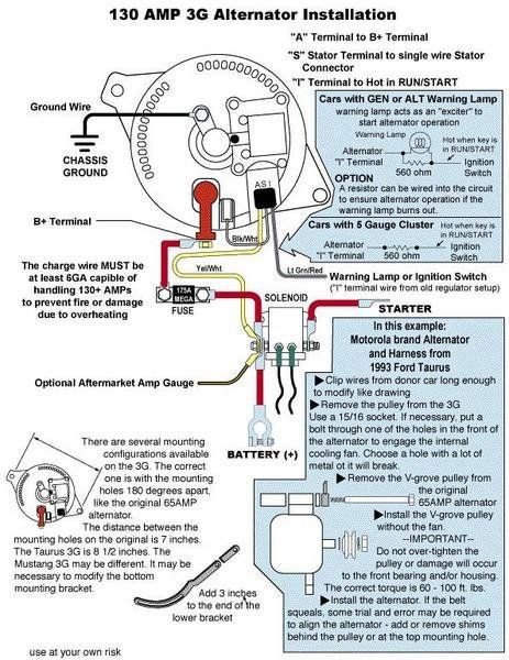

The 3G came in several different mounting configurations as well as two different amperage ratings. There was a small case, 4-hole 95 amp 3G alternator and a larger case, 2-hole 130 amp 3G alternator.
The "4-hole" and "2-hole" is in reference to the sets of holes you'll find in between the pairs of ribs that radiate outward, every 120°, on the face of the alternator. Here's an example of the 2-hole case 130 amp 3G alternator I'm talking about on my '69 F100.
You can see the 2 holes (in between each pair of ribs) on the front of the case.
Different case configurations you can find on the 3G large case 130 amp versions.
3G exploded diagram.
Terminal connections.

You guys are awesome. I checked my bronco but it has a side mount alternator in it, so that will not work. So some more hunting. The schematics you attached are great. I had found them and already printed them out. Its about time I started my build thread. It's going to be a journey. I figure a few years depending on funds.
