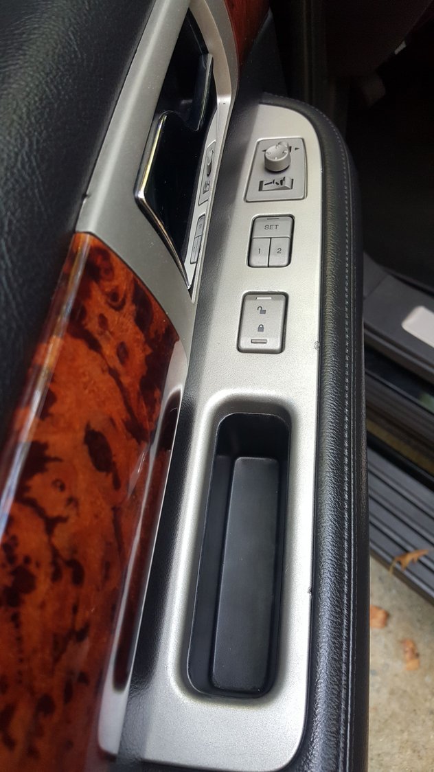

Sorry it took so long but I finally painted the trim pieces on the driver side door.BEFORE
AFTER
BTW the previous owner thought you could remove the controls with just a flat head.
I guess color bond was a match I'm going to tackle the center bezel next!

Very nice. Did you clear coat them to help prevent the color from wearing off too soon again?

Hi 5.4T. Sorry to resurrect an old thread but I'm planning on getting Some Colorbond 536 for an 06 Navigator I bought a few weeks ago. As you can Imagine pretty much all of the Satin Nickel could use a repaint. Just few questions. How has it help up since you did yours about a year ago? What did you do for prep? Adhesion promoter? Degreaser? Did you clear coat after? How far will a 12oz can go? I'm planning on doing the cup holders, center bezel and inside door pieces.

honestly I just used some mr.clean magic eraser first. Then I washed it with dish soap and that's it lol. It was more of a test run really but to my surprise it came out looking just like factory and it still holding up! I didn't use clear coat because in the past I had to repaint a panel on another vehicle and after I applied clearcoat, it did not match up. As for the can, it will last you! I did the driver side controls and center console/bezel. I will redo the bezel as I didn't apply enough paint near the navigator letters but it will have to wait till it warms back up.
