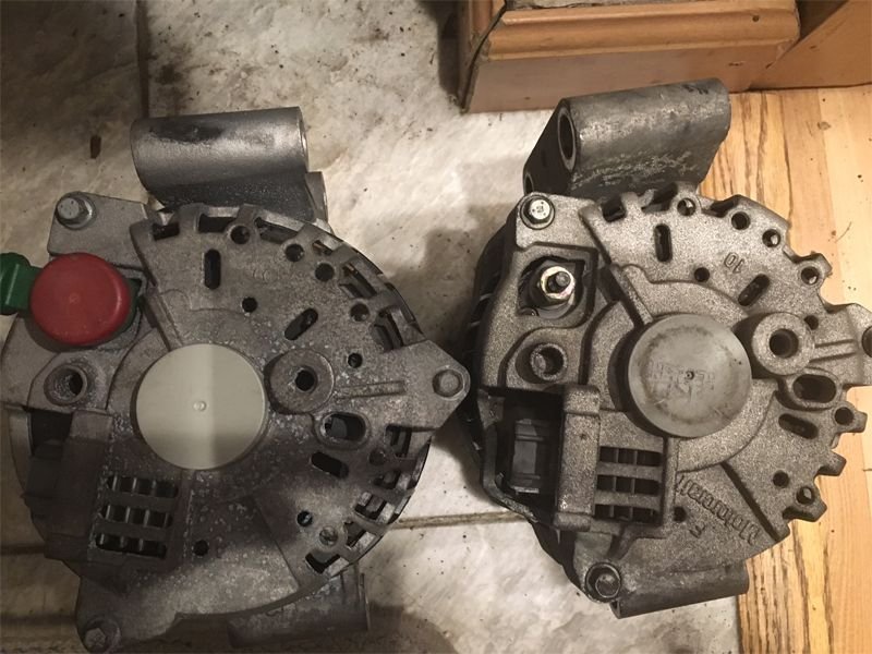

Is This a Ford Alternator
The Ford 110 alternator on the right is stamped MotorCraft. The 140 amp alternator on the left does not have the MotorCraft stamp. While I am not trying to split hairs on this alternator installation, if it's not a Ford remanufactured alternator, I will spend the money and buy the Bosch alternator. I am waiting for Diesel Redemption to return the phone call. If it's not a Ford alternator, I am confident Jeff will ship me another as he does not want bad eBay ratings.

I verified the pulleys are in approximately the same position-1 7/16" from the alternator body. Measured same location on each alternator. Maybe 1/32" difference. I don't think Ford would have a different alternator for van fitment. Hard to believe!

They may, you can check part numbers between the vehicles. I’m in Boston so working on a little screen.
I may have to shoot you with the T dart.
if you look at my alternator pictures my assembly line 110a does not say Motorcraft. Also your 140a case looks exactly like my Bosch case (screen dependent). So it may be a Bosch, it may be a Ford. I’ve not been able to confirm it, but the Ford and the Bosch May be from the exact same supplier. It may be Bosch, or it may be Visteon supplying both Ford and Bosch, private labeling to Bosch.
Another supplier is not going to exact copy the casting unless they are trying to counterfeit. But if you tasked Bosch/Visteon to supply a 140a for where a 110a was in production, the design team would just expand the design for the larger stator. Again, it’s my swag.
During restorations of ‘65-66 Mustangs/Shelbys those type of labeling issues popped up all the time, sometimes assembly line vs replacement, and sometimes just in process of production.

I wouldn't stress about the Motorcraft embossment in the slip ring end casting.
People pick up rebuilds at the wax and oil stores with the Motorcraft embossment on the slip ring end of the casting. And these rebuilt alternators were not sold as Motorcraft branded rebuilds, nor rebuilt by suppliers associated with Motorcraft. It just so happens that the core used in the rebuild was originally a FoMoCo sourced part.
There isn't always a direct correlation between the alternator frame casting and the parts inside. The stator, the rotor, the rectifier bridge, the diodes, the regulator, the slip rings... can all come from a combination of new and reused parts from any number of alternators, whether originally Motorcraft or originally a replica made in Hack Knock Cheep. When I returned my core, it was a box of loosely assembled parts from three different alternators... all the required parts were there in the box to assemble an alternator, but they were the worst, least usable parts in my inventory. The counter guy who accepted the core had a good laugh when I made him look inside before he agreed to accept the core, and then he kept chuckling as he hauled the box off to the back, after giving me back my deposit. It will get sorted out in Mexico, where they have 100,000's of new Chinese and used Motorcraft stamp parts to assemble rebuilds from.
Nowadays, slip ring end and drive end castings cost 40 to 50 cents. The are cast in China and shipped to Long Beach CA and distributed to the rebuild sweatshops in Mexico. I spoke with an importer of these things about a year ago. Think of an alternator as an assemblage of parts. When it gets rebuilt, some parts are replaced. Some are deemed worthy of reuse. Like a box of chocolates, you never know what is inside.
If the alternator you have in hand works, then run it. No since in stressing about getting a used one with a Motorcraft embossment, because the guts of THAT one could have all knock off parts inside, and how would you know?

ok, it is freezing cold with snow and hail, but for a 6.0 brother to sleep at night, I trekked out to the RV shelter and looked at the back of my: ordered-from-the-factory, stock Ford 140A Alt. And there are no markings indicating anything about origin of manufacture (particularly anything remotely like the word "Motorcraft" stamped in the casting). None, Nada, and it has the same off white wiring yours does, coolfeet...
