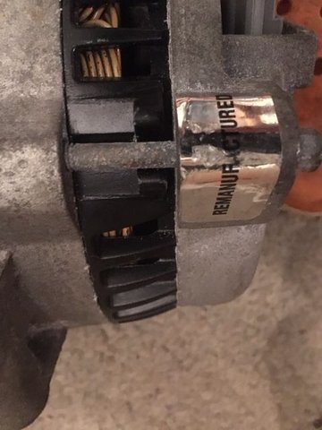

Here is a photo of the 140 amp alternator. It's larger than the 110 alternator. Diesel Redemption says the sticker indicates it's remanufactured by Ford. 2 years ago, he was charging about $160 for the used alternator. Last spring, he said he would sell it for $60 when combined with other parts.

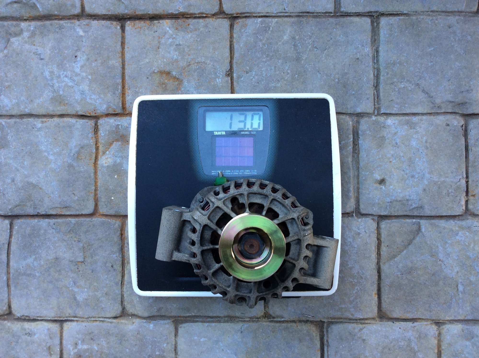

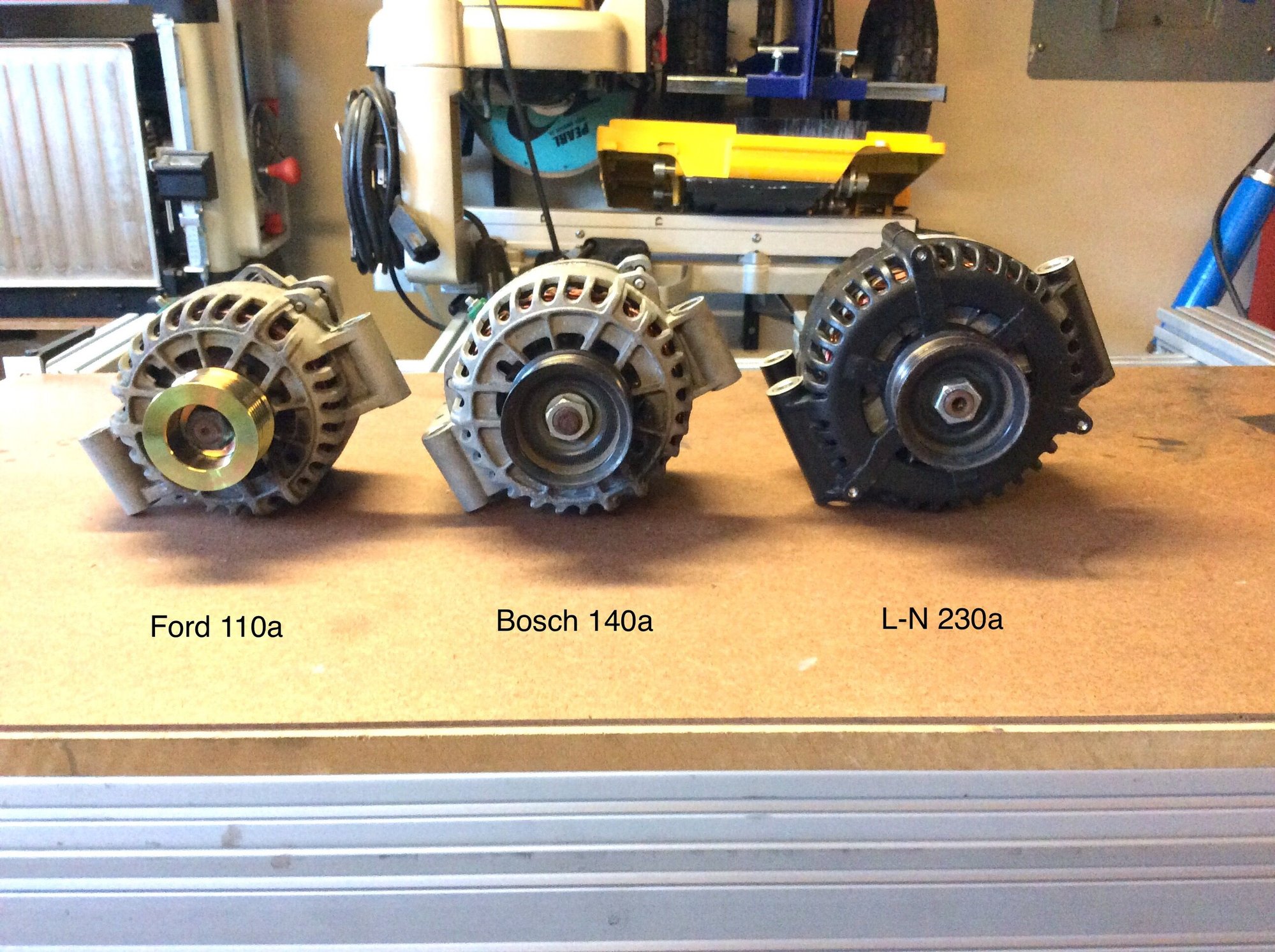

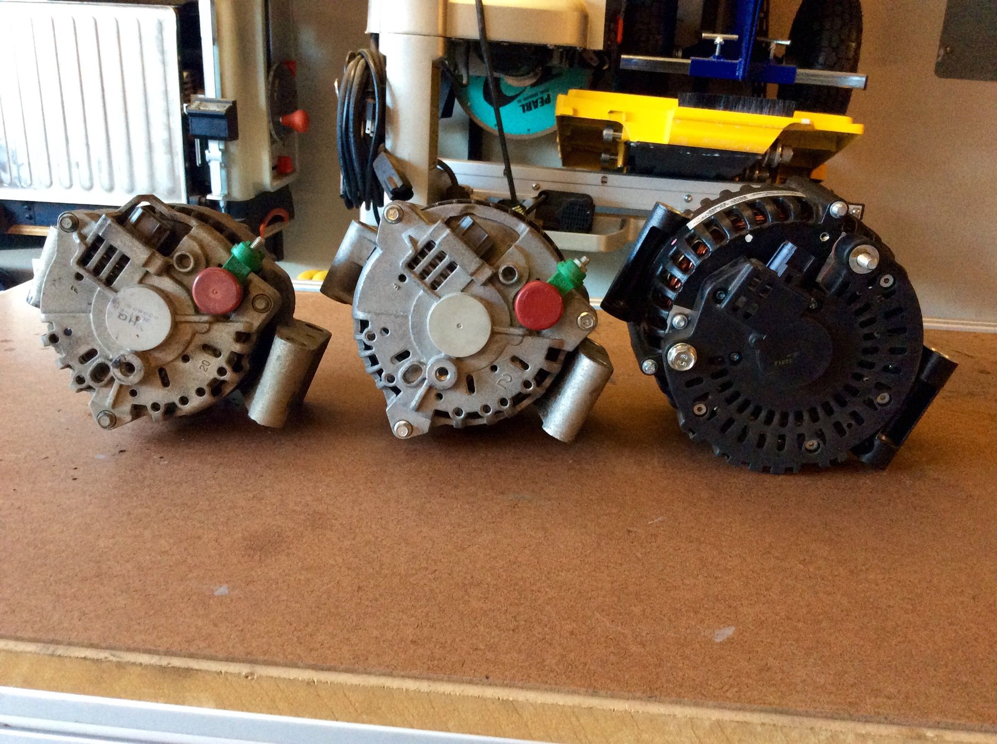

Coolfeet, not a bad plan.

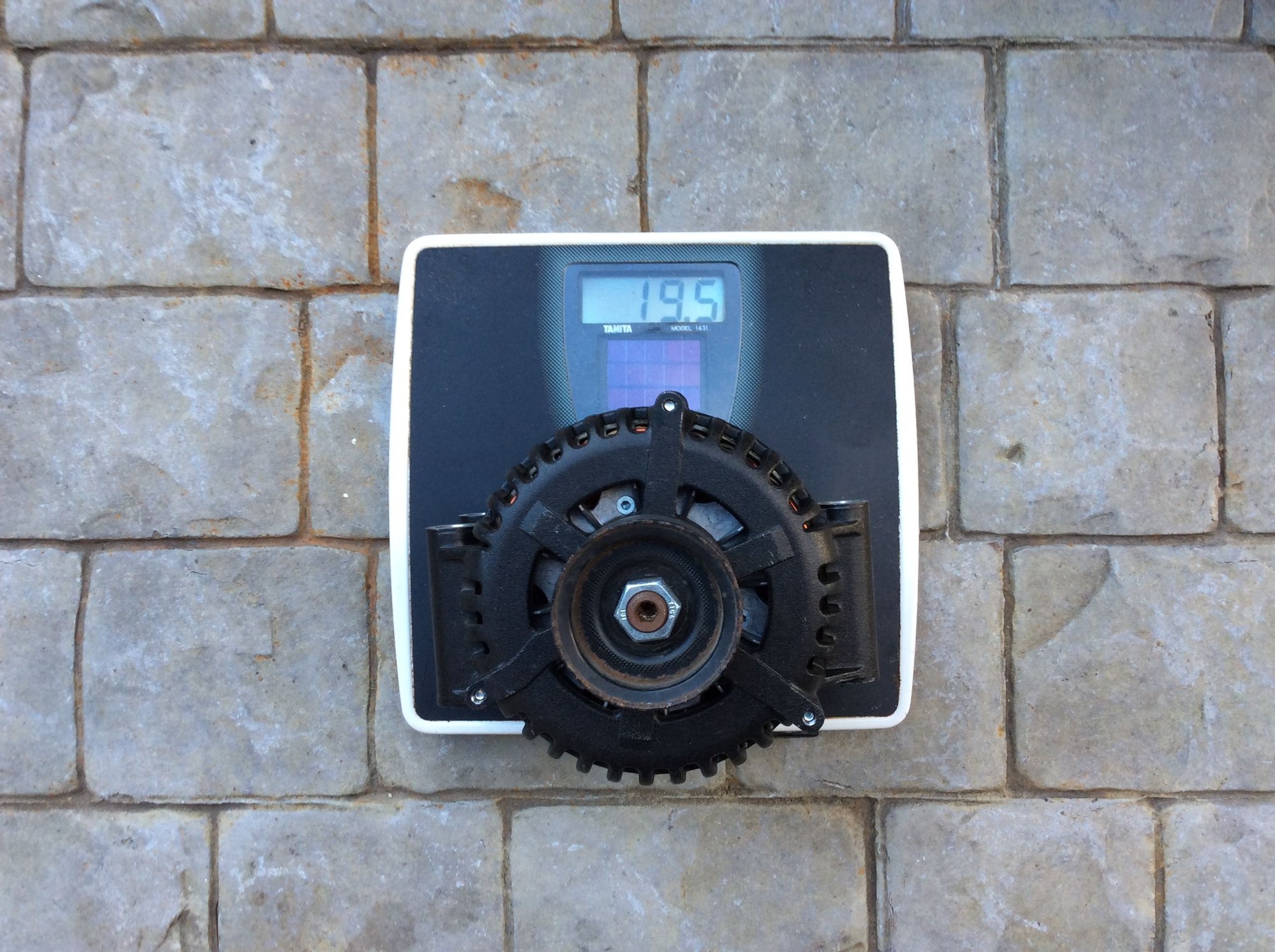

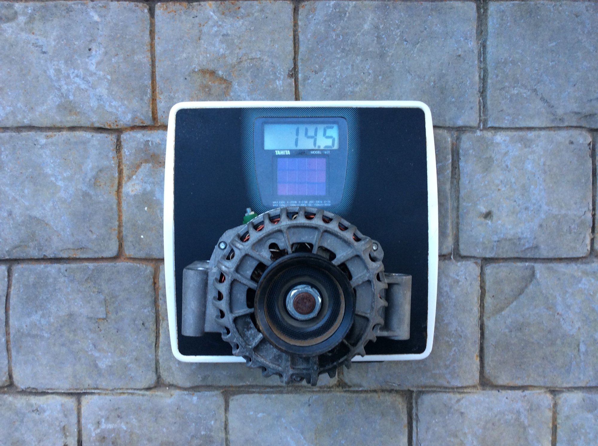

Here are some comparisons between the alternators I have, and no you can't use them in your blog.

Jack is the real deal. Comparison photos? Ok. Front. Back. Top... and... WAIT for it....... WEIGHT.. That's thorough. That's data. That's Jack. That's what I'm m-f-king talking about.

Thanks for the information. What a difference in weight.

No, seriously on the meticulous attention to detail. All the alternators clocked the same way, spaced equidistantly apart. Details that aren't just obsessive, but that actually help the mind map and orient itself between a detail being compared as the eyes glance back and forth between the thickness of a casting at a mounting point, or the distance away from 12 oclock of an electrical connector for estimating wire harness reach.
Not blowing smoke here. I'm constantly frustrated with other peoples so called comparison photos, where turbo A is backwards upside down and sideways, turbo B is forwards right side up and cross ways, and turbo C is still in the dam box. How is that a useful as a comparison photo? Some people don't get it. Jack does. Take advantage of it folks while you can, because he's been known to take down videos just as fast as he puts them up.

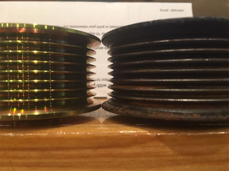

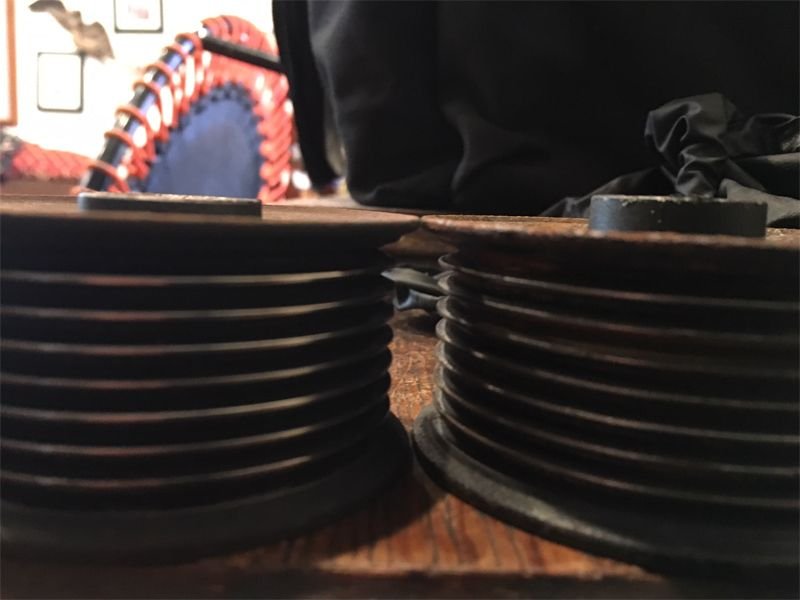

Alternator pulley shaft height difference.
I removed the140 amp alternator pulley with an impact wrench. I need shims to install the smaller diameter pulley. The pulley on the 110 amp is not as tall. Whether I use this pulley or the overdrive pulley, I will need shims. There is a 4mm difference-significant!
110 amp alternator pulley 35mm 140 amp alternator pulley 39 mm.
New Overdrive Pulley just arrived in the mail. 39 mm.
Overdrive pulley on left. Ford 140 amp pulley on right.
