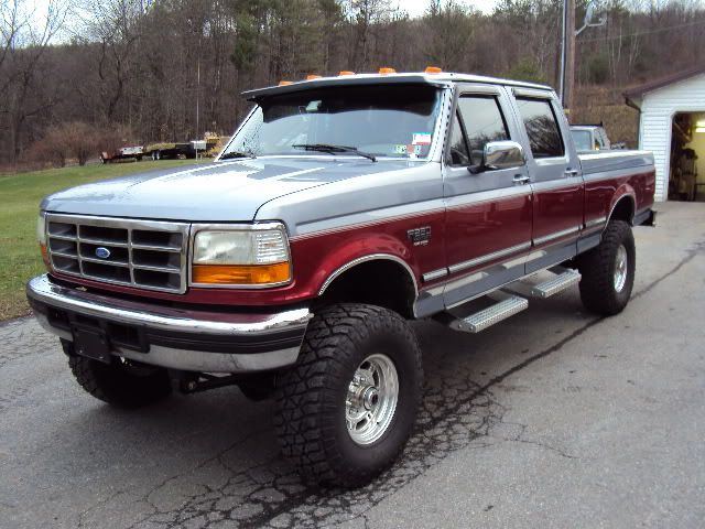

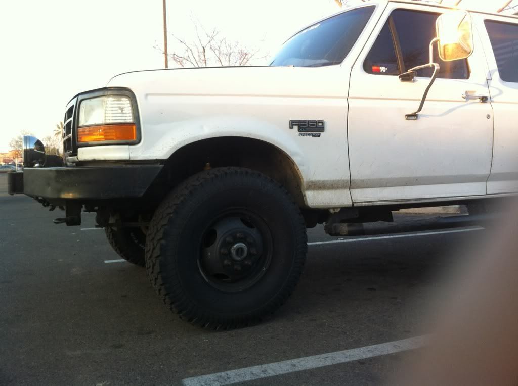

Yeah I think I am sold on 315 75 16 's. There are some sweet pics out there if you search the keyword "f350 dually 315 75 16"
Old Apr 7, 2016 | 07:11 AM
dtgl90vt's Avatar
dtgl90vt
Joined: Oct 2012
Posts: 755
From: Rockport MA
Granted some of those weren't dually or 16" rims but they do look flippin sweet.

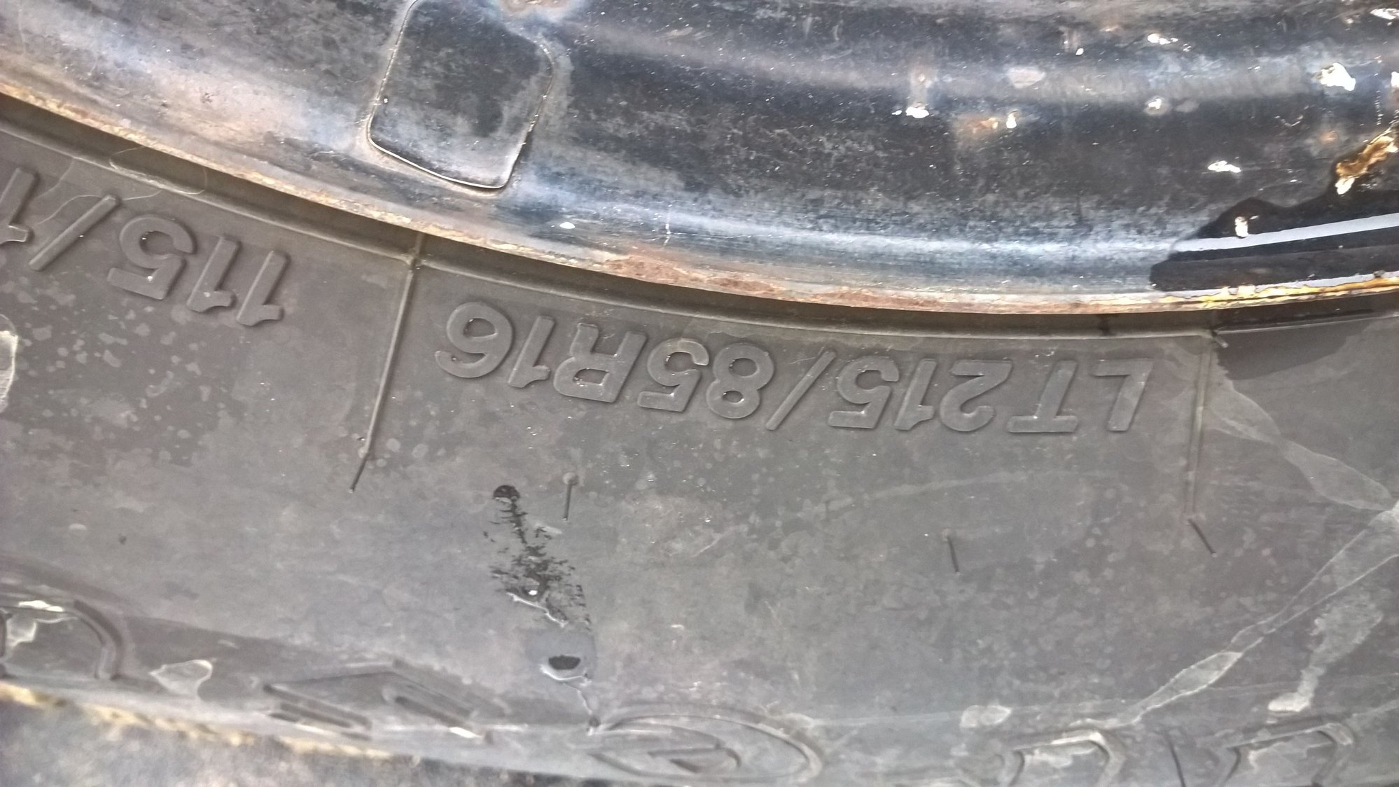

Oh and I realized I am only running at 215 85 16 so even smaller than what my door tag said.
Devin

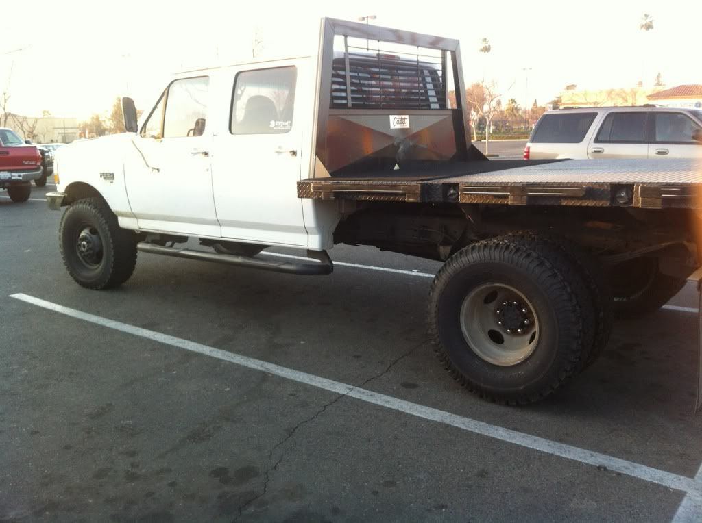

wow yea .. i never see dually's with fat tires ..
and i must admit ... they do look gnarly .. freekin sweet ....
so .. ?? is 2 big fat tires up front and 4 regular width tall tires a possibility ..
i bet that would be a killer combo .. though would throw off the rotation scheme
it would look good ... and probably drive very nice

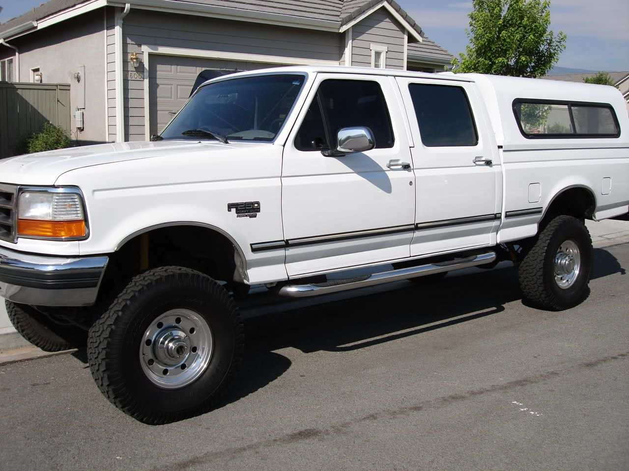

Im not a fan of big tires on a dually.... whats the point? Id say those last couple arent 315s, in fact the crewcab looks to be 255/85s

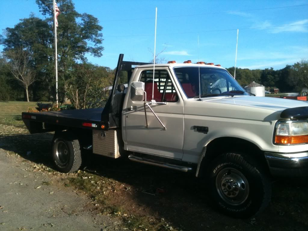

Check out these 325s
http://www.powerstrokenation.com/forums/19-1994-1997-general-aftermarket/112165-lets-see-those-obs-crew-cab-pics-19.html#post1706336
