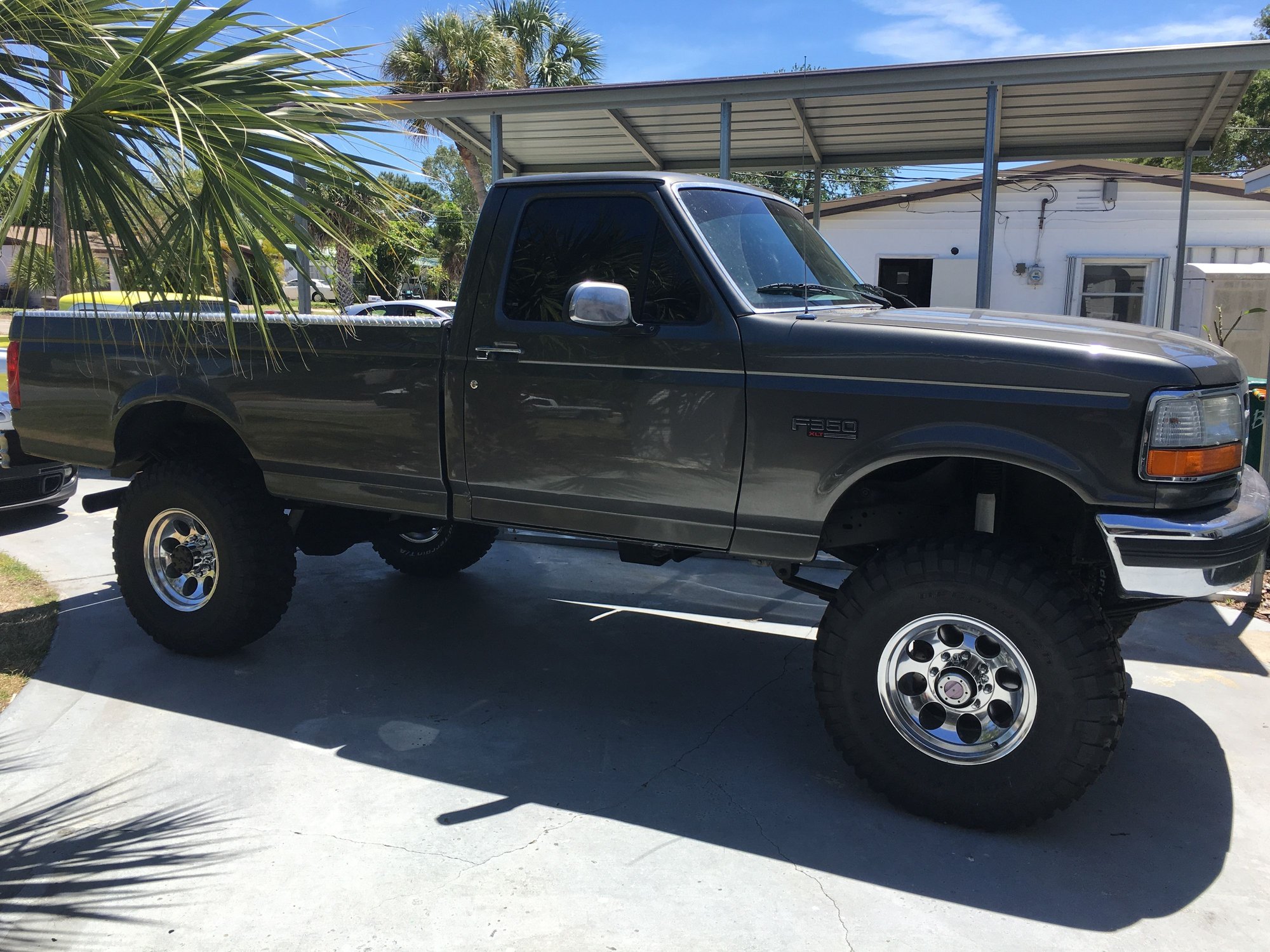

37X12.50X17 on Mickey Thompson Classic IIIs

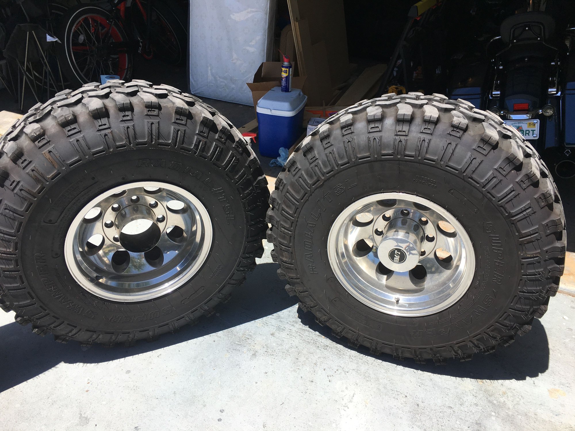

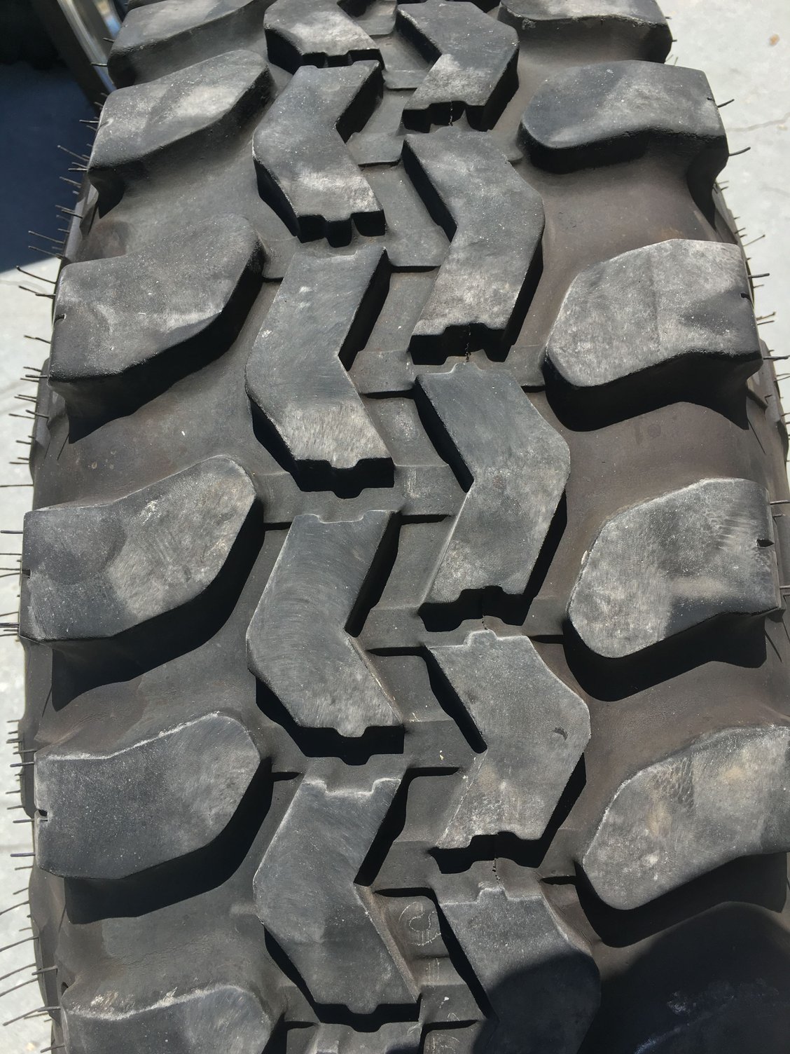

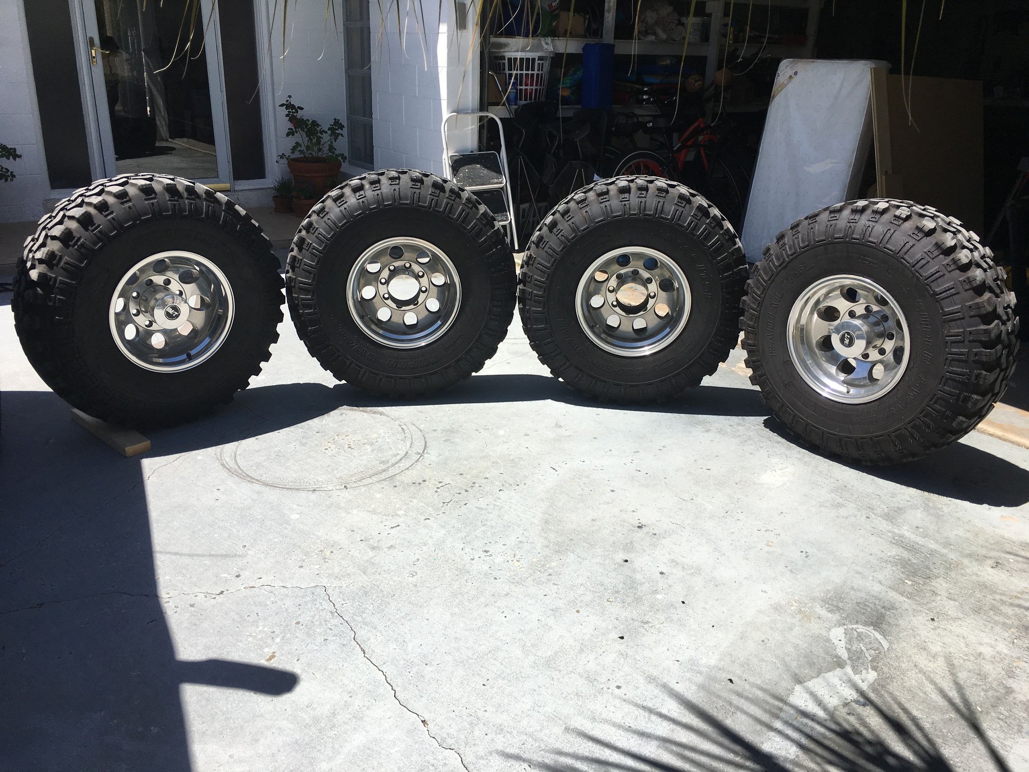

The 36X12.50X17 Super Swamper TSLs on M/T Classic IIs that I need to find a new home for! They are a 8 X 6.5 lug pattern that fits a wide variety of trucks.

Generally: open shoulder tires (like the ones pictured above) will get poorer fuel mileage than closed shouldered tires. You will have shorter tire/tread life with an open pattern (like above) vs. a tighter tread pattern. That being said - I have a set of winter tires like the ones pictured above and they get GREAT traction in the snow!! They self clean and don't plug up like a Goodrich T/A tread will.
