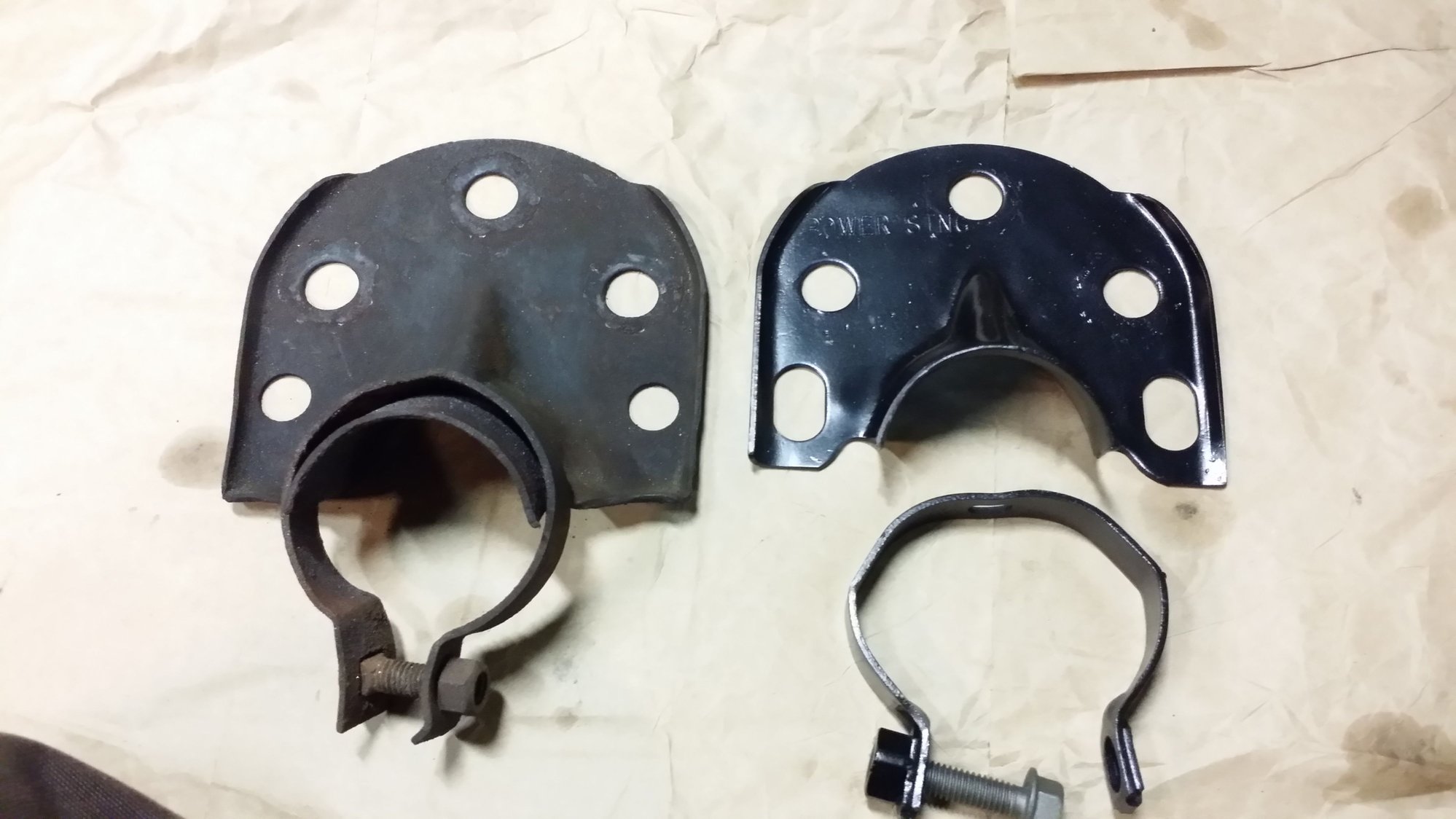

Longer, manual steering column bracket for engine side of the firewall on the left. Shorter PS bracket for a column coupled to a Saginaw box on the right.

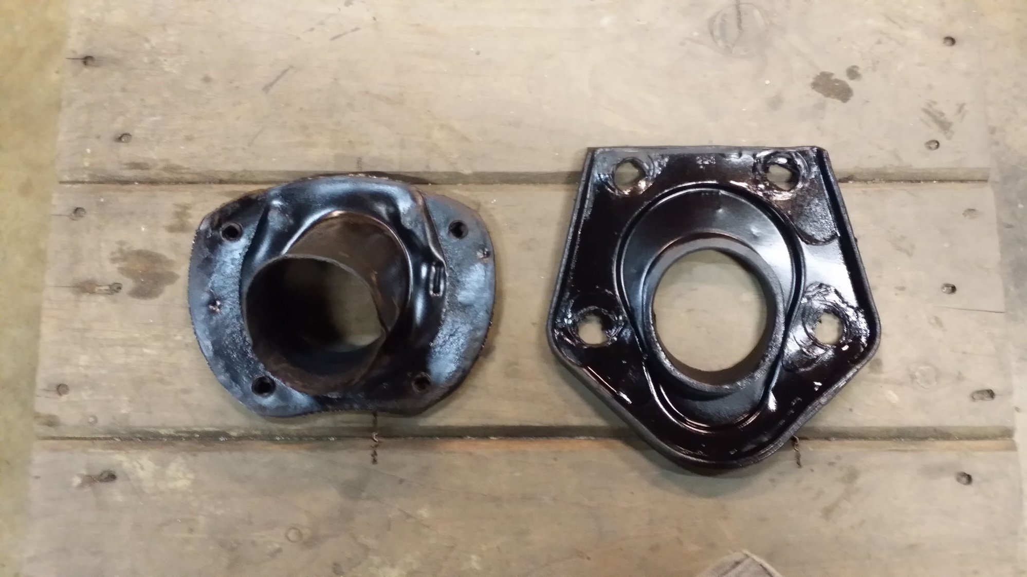

My old '69 F100 manual steering column-to-firewall seal on the left. Larger PS seal on the right for a column coupled to a Saginaw PS gearbox.

What engine do you have, what did the column come out of and did you get the shorter stamped steel column bracket the goes on the engine side of the firewall?

unfortunately I did not get the metal firewall clamp...it was already gone. I still need to go back and get the engine perch and need to find pulleys for a 3 bolt harmonic balancer.

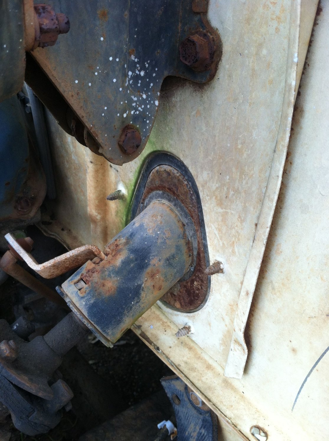

The 4 speed column doesn't use a firewall clamp on the engine side of the firewall. The large inside seal has a steel plate, and screws to the firewall with sheet metal type screws. I put that same column in my 72, and was searching for a "pwr stng" bracket, when I came across a78 f250 with 4 speed which used no bracket. I took a picture on my phone, I'll see if I still have it.

Here's a 78 or 79 F250 I used some parts off of. I was thinking it was a 4 speed. Apparently its not. Notice there is no outside flange. No holes in the inside seal plate for extra bolts either.
