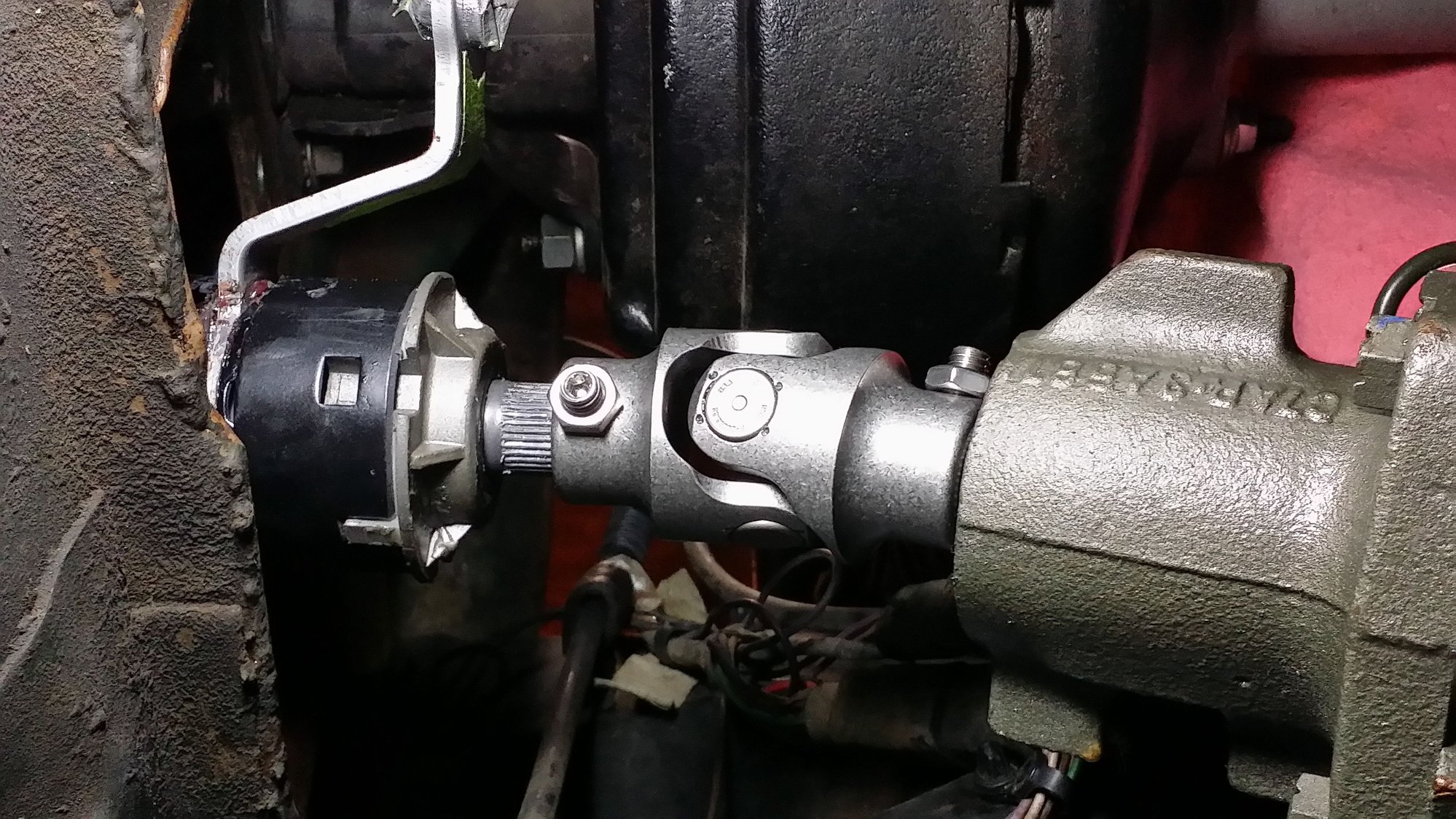

Manual steering gear box or Saginaw power steering gear box? Fixed steering column or tilt steering column? --tilt column wasn't available in the trucks until '78 but, that doesn't mean one couldn't have been installed in an earlier model.
My '69 F100 came with manual steering and a fixed (automatic transmission) column. I installed a '78 Saginaw power steering gear box and tilt column, also from a '78.
On the tilt column, there's a bolted flange (on the column side of the coupler) at the lower end of the steering shaft. This piece was missing when I got the tilt and I couldn't find the correct coupler for it.
I installed a stainless steel 3/4" 36-spline x 3/4" 36-spline Borgeson steering joint instead.
I was in the process of installing the column and the Borgeson joint in this photo.
