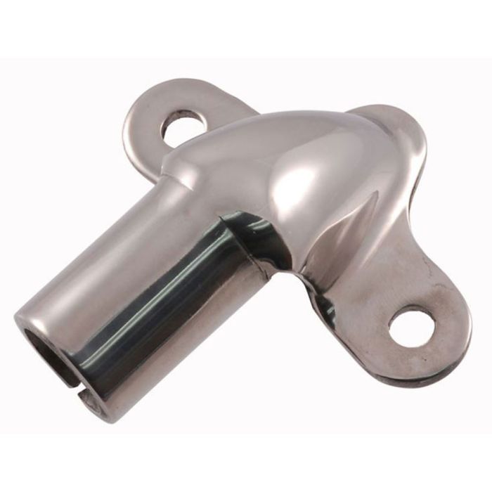

1937-79 Ford F-100 Tailgate Hidden Hinges, Weld On
Curious how these secure inside the tailgate. ANd, could someone fab these up themselves...

The round part shown below is a threaded plug that fits into the bottom roll of the tailgate. It can be welded in place, or a small locating hole can be drilled in the plug and bottom of the roll, so you can insert a punch or awl to hold it in place while installing the bolt in the end.
Yes, they could easily be fabbed up by someone with basic fab skills.

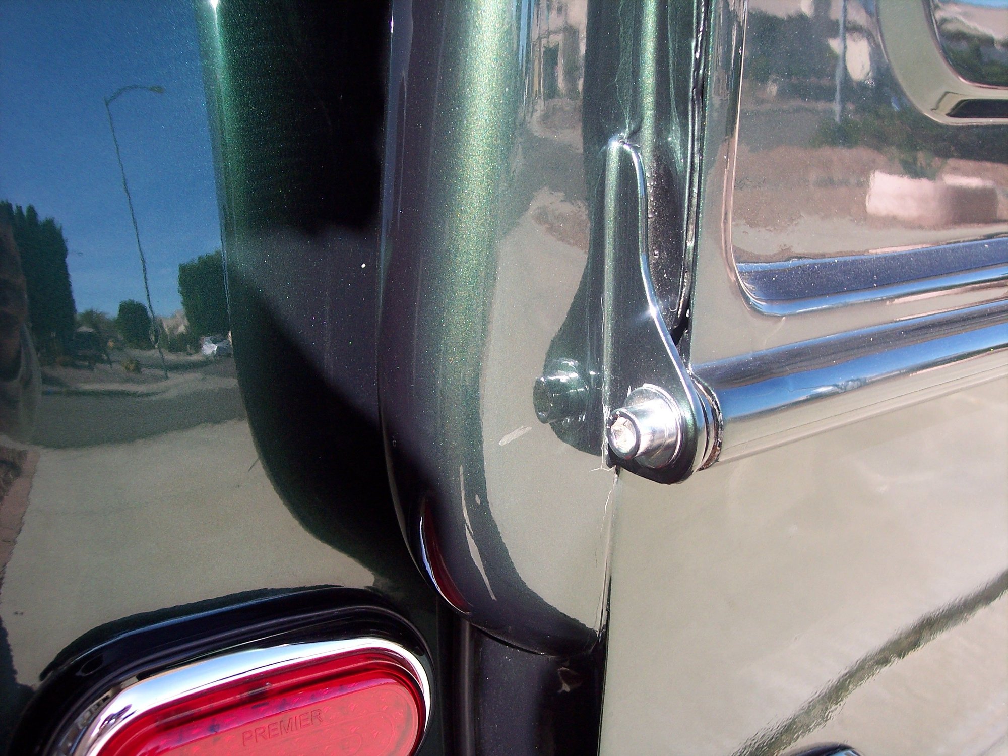

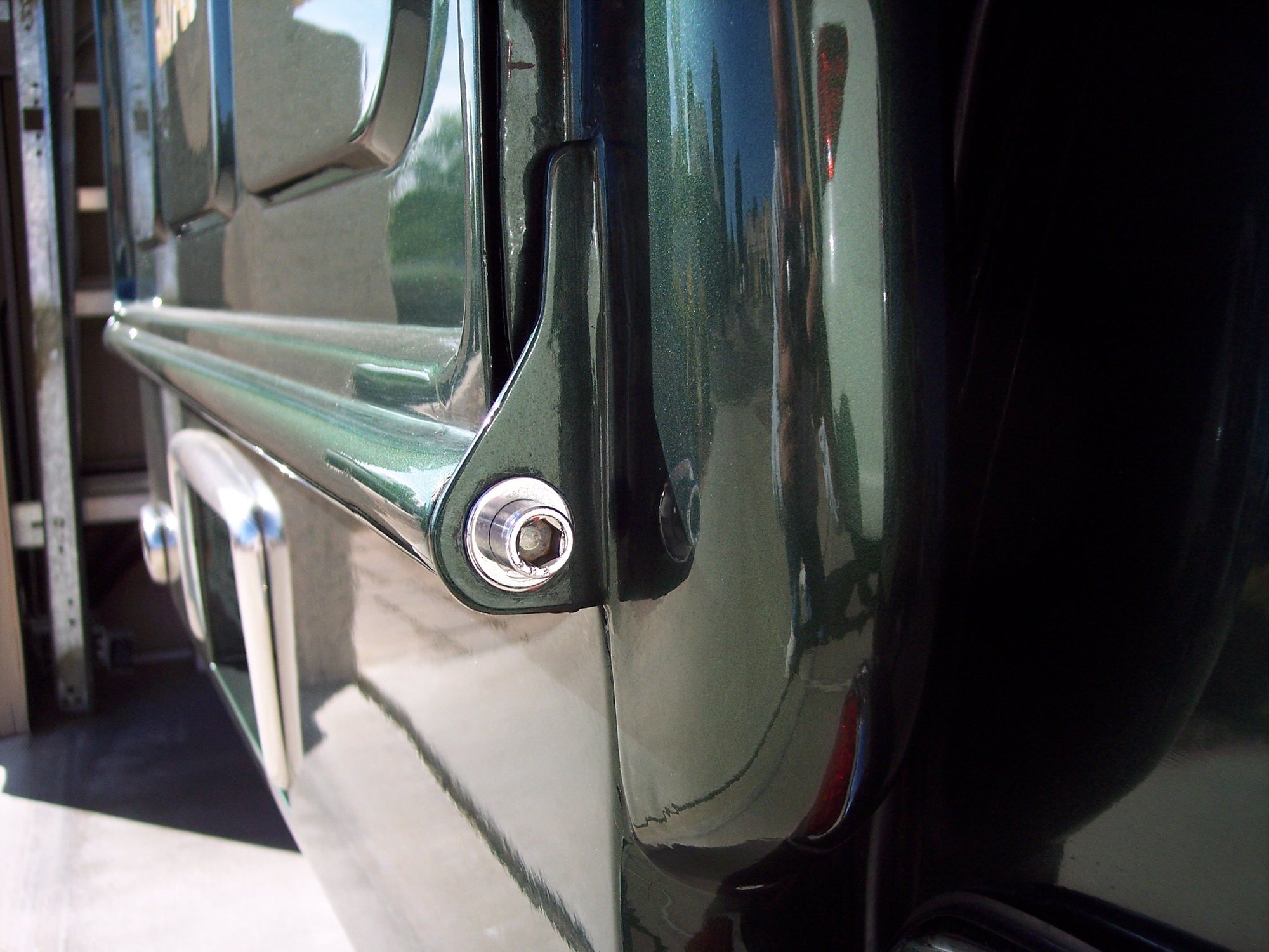

I use them all the time but I don't install them as per included instructions. I weld mine on the INSIDE of the tailgate flange and trim the tailgate as needed to fit them. The end result is that the weld-on tab is much stronger and the whole assembly is more "hidden". Here is a pic of them installed on my 56 bed before paint...
