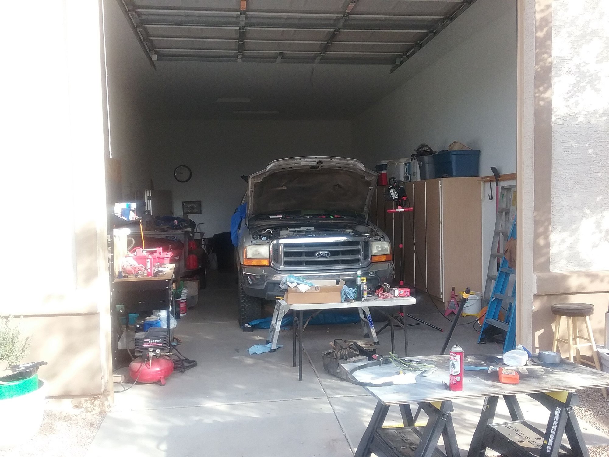

Thanks for the encouraging words guys.Jaime,yes better to be at home than on the road.Truck is safe and almost sound in my garage . I'm rounding third and headed for home.Thanks everyone. Steve

Wish I had a garage like that!
