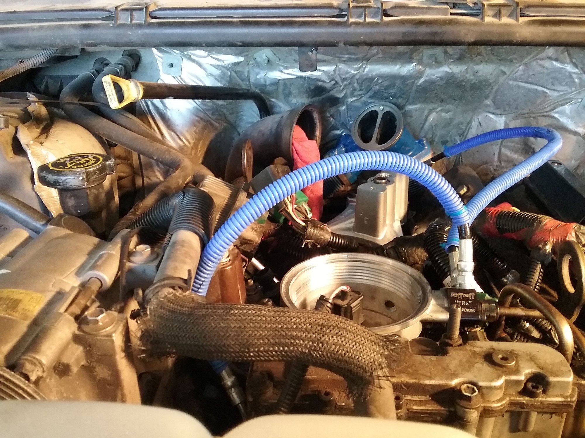

Do have to double 90 at the bowl to get it straight up? Looks like in that picture the drain bowl arm will hit it straight up.
It will hit it straight up.The drain valve has to be removed to install fitting.That was as straight up as it would go before hitting.I don't think it will be a problem the way the sensor is angled.As far as doubling up the fitting,I guess it would work.
you can but I would suggest as minimal as you can as far as adapters, reason being is the more you have the more points of failure your introducing, while they may not fail often, the more you have (POF) the greater likely hood it COULD happen. remember in some cases less is more , this is just my view on certain things so your mileage and views may differ accordingly...

Thanks for the answers. I thought it looked like that. It won't be a problem, it's just some guys say it will last longer in the up right position.

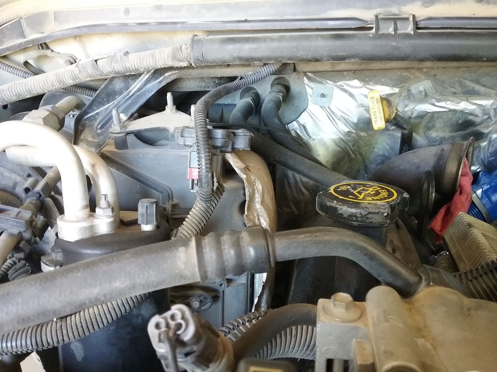

I hope you guys can help me. Can someone tell me what the tube on the left is for?I'm stumped on this,I don't recall removing anything from there

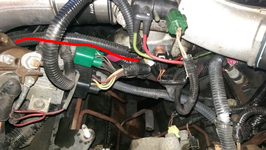

Mine goes up to a splitter connector on the passenger side. Let me give you some pics.
I traced the hose below it in red.
This is the spider side, I traced in red below the hose.
Hope this helps!

Thanks, it looks like we have different set ups.

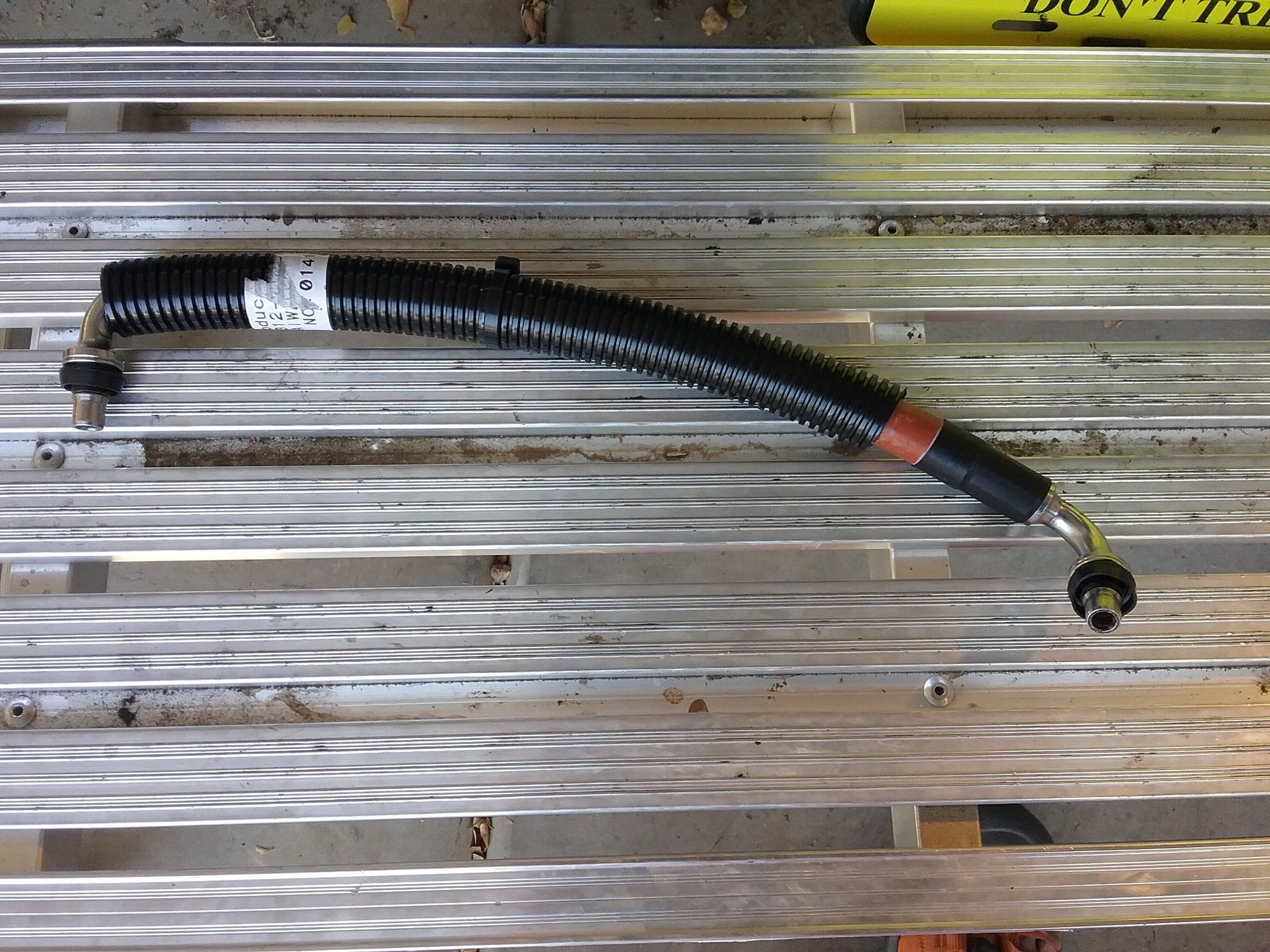

A lot accomplished yesterday. Fuel bowl and new fuel lines,Hpop, Frx,up pipes and pedestal installed
Now I have a question. Pass side hpop hose,I can't for the life of me figure out which end goes to the head and which to the pump,I'm probably over thinking this but I'm really frustrated by this.Any help is much appreciated. Thanks

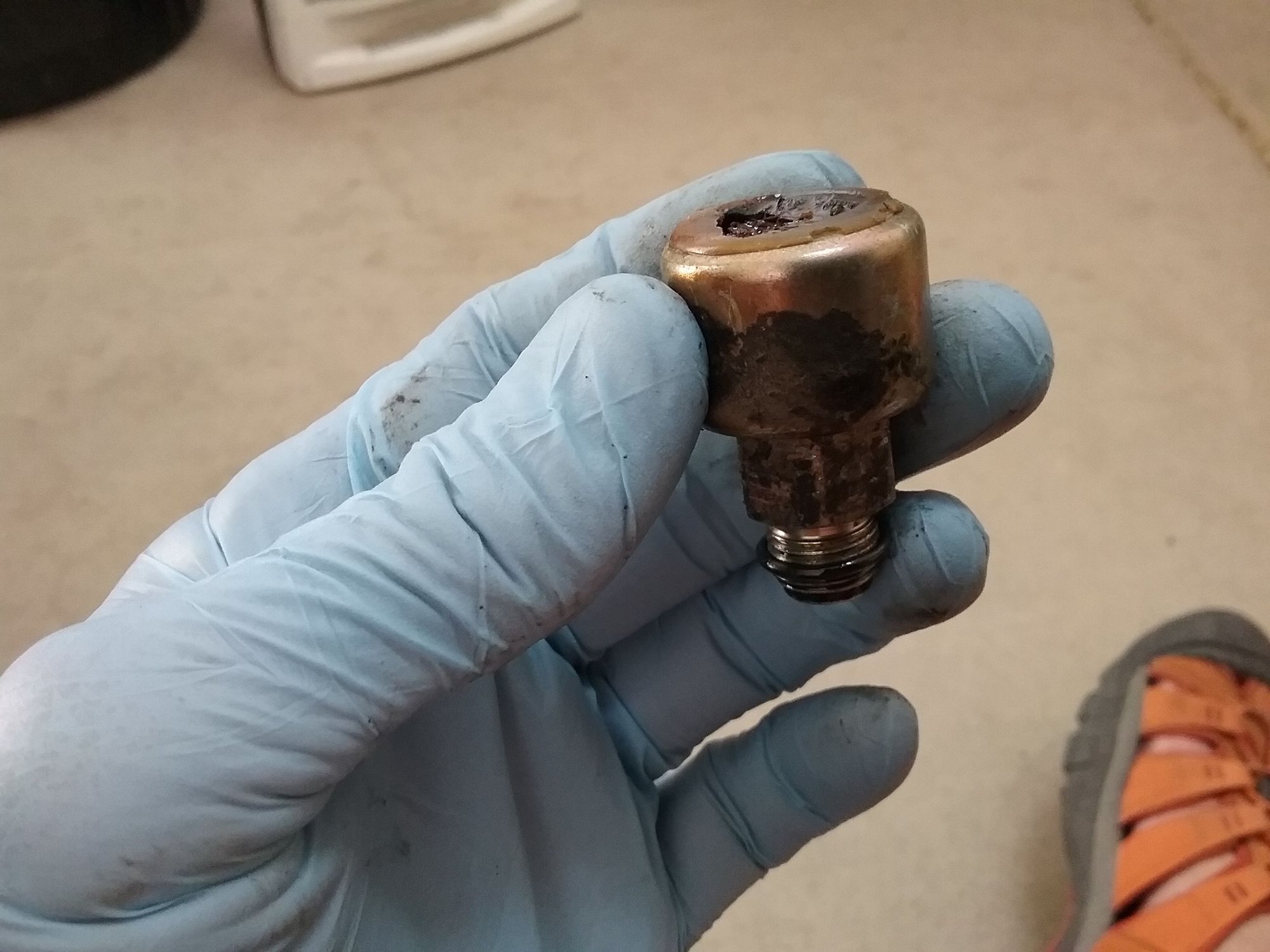

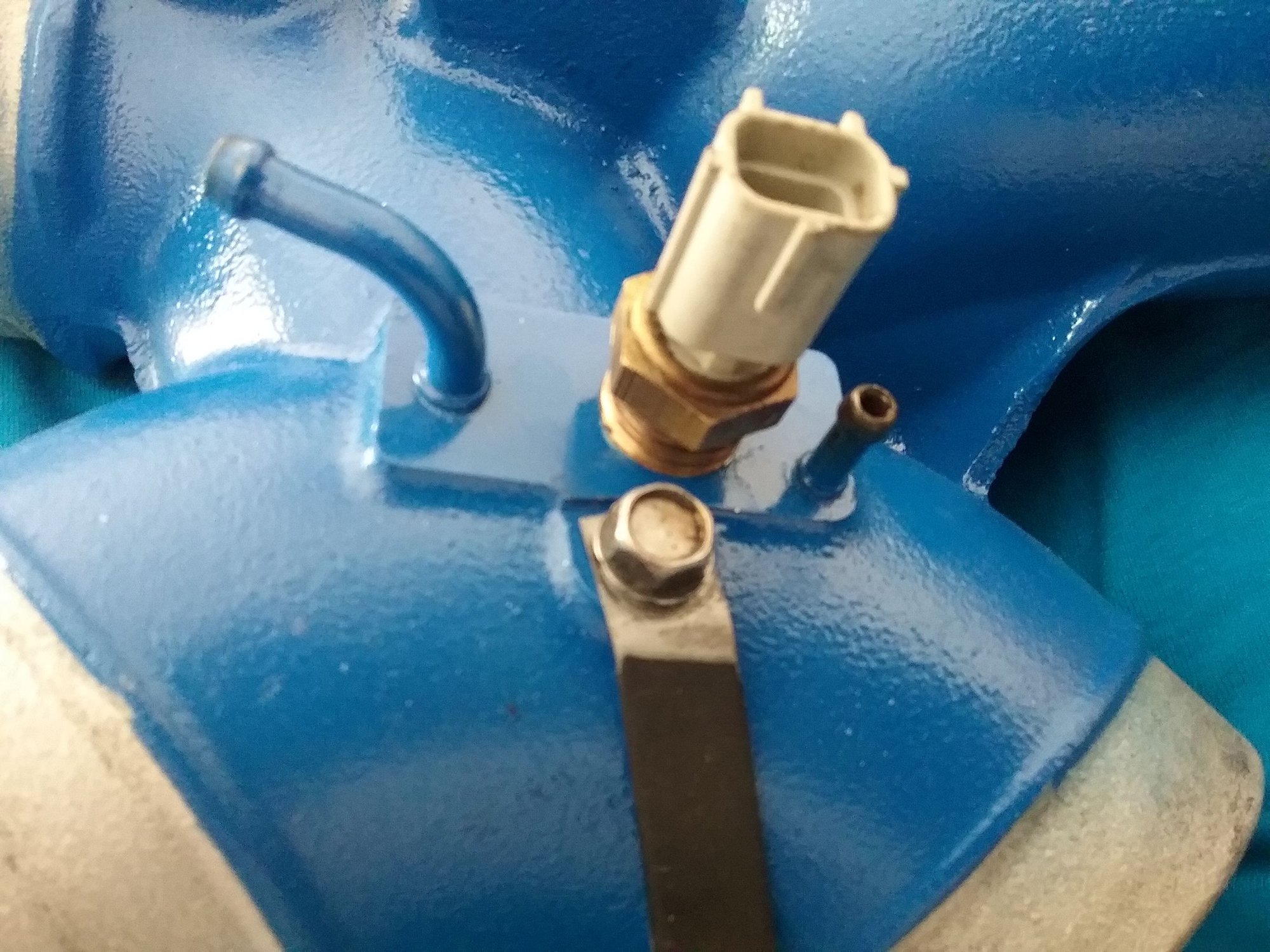

And the saga continues, while fighting with the passenger hpop hose the tip of this sensor broke off,anyone know what it is offhand.Im so livid right now I can't see straight . I've just about had it with this truck.It might be for sale soon . I'm done.
It was on the driver side near the alternator

ICP, Haven't changed my HPOP hoses but it looks the same on both sides in the picture. Just fit it in and see witch way works best.
^^ What he said, ICP ^^
Not to worry, they are troublesome and if it broke, it was probably marginal anyways (keep saying that, LOL)
