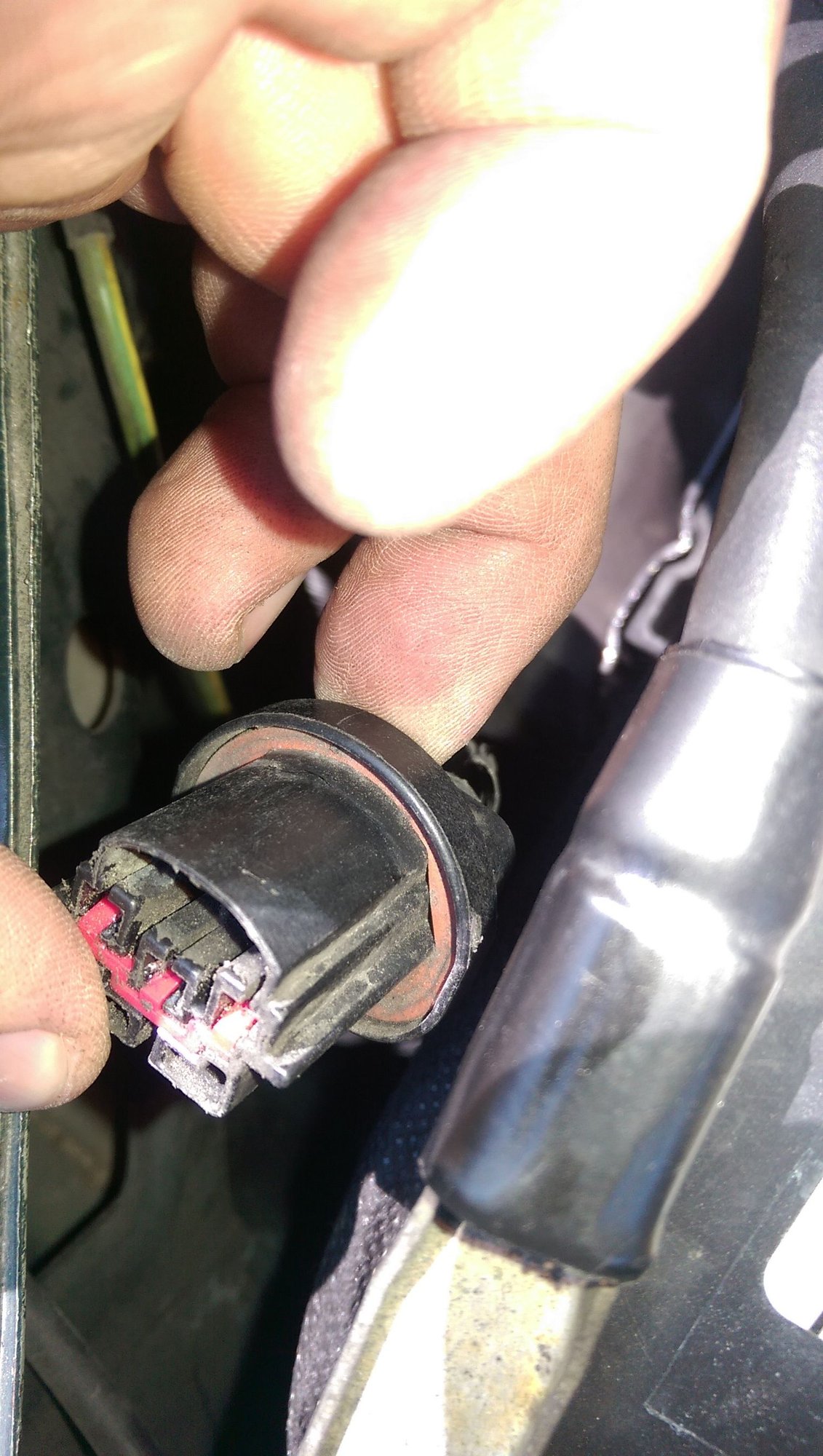

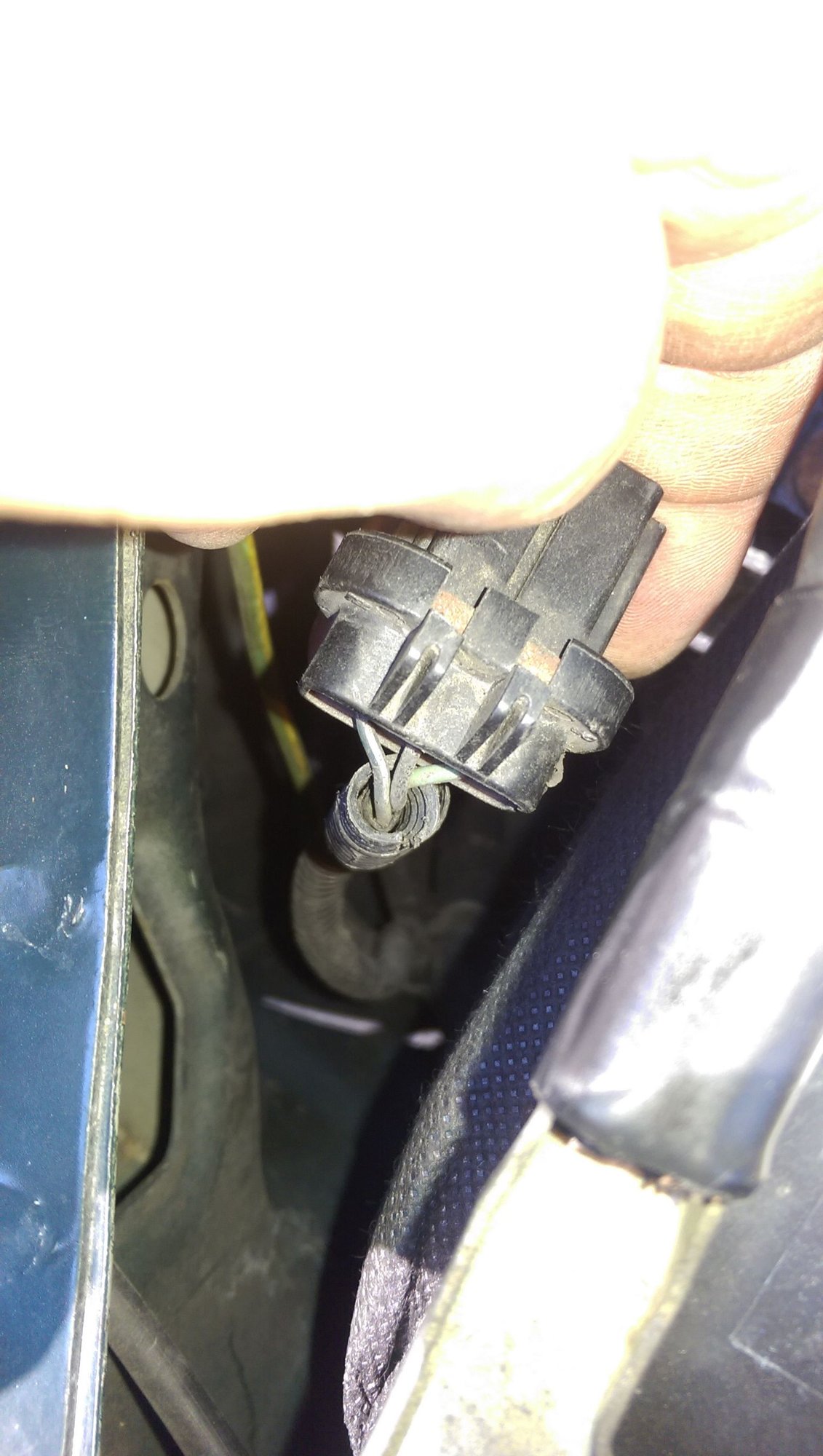

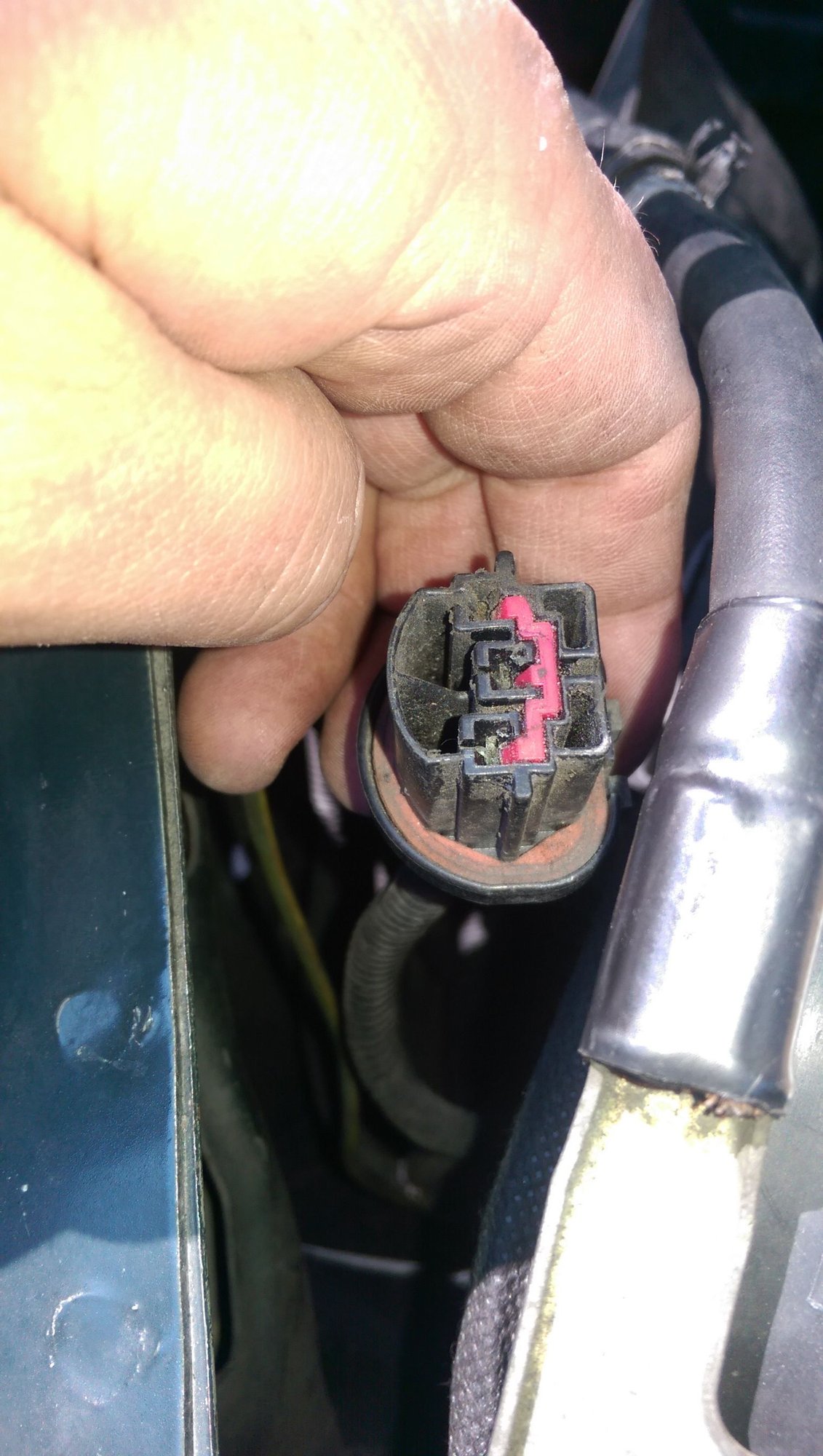

My 2002 Excursion has 2005 H13 headlights. The wiring pigtails don't fit H13. Previous owner had HIDs and wire ends siliconed into the sockets
I need to adapt my harness pigtail to H13 bulbs. Best/fastest/decent $$ ???
Don't worry I have pics, so you won't have to rely on my lack of headlight terms and such

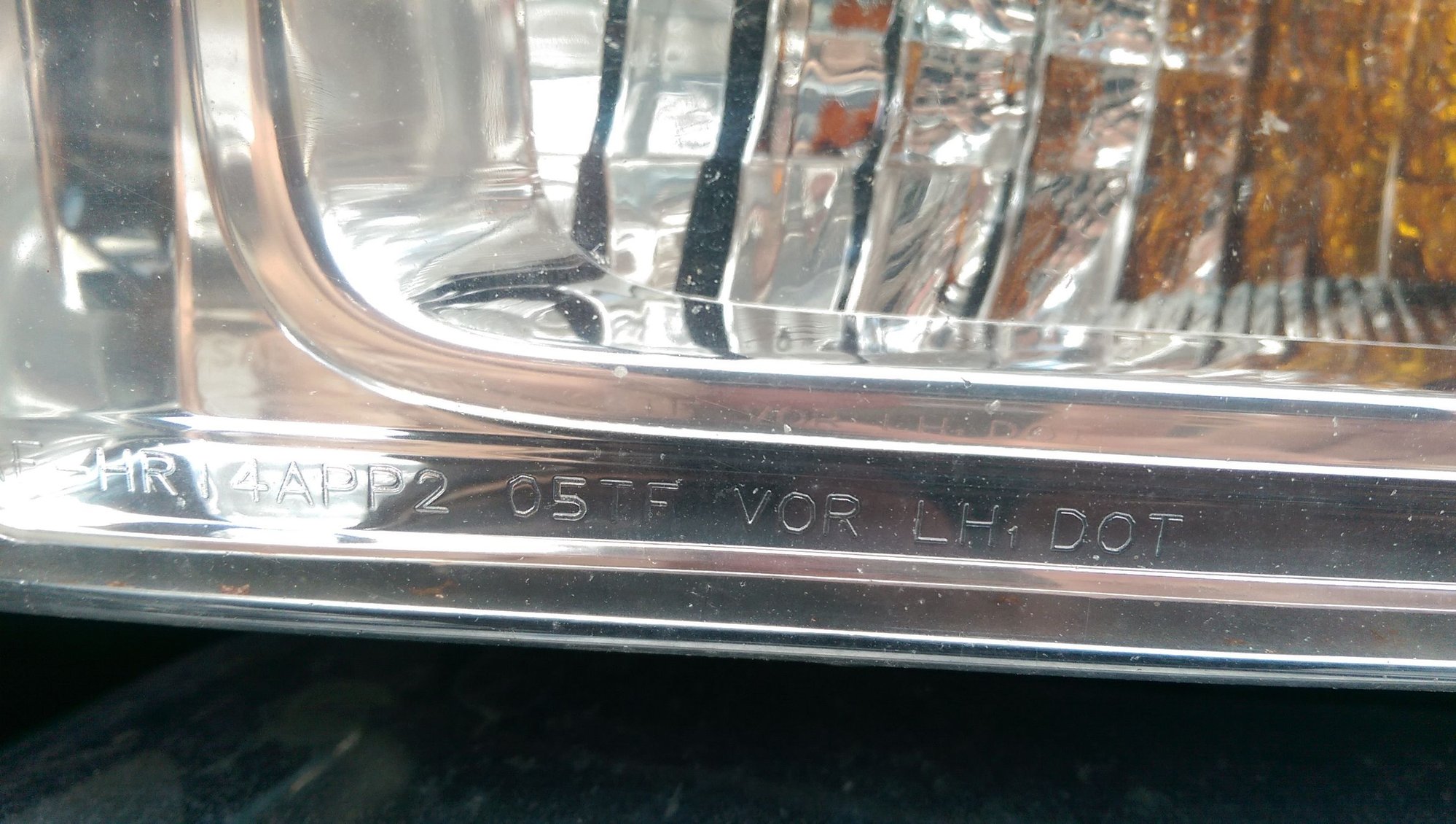

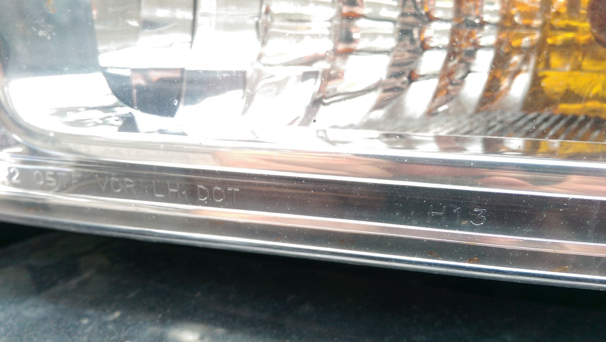

The headlights have the numbers right on the front and say H13.

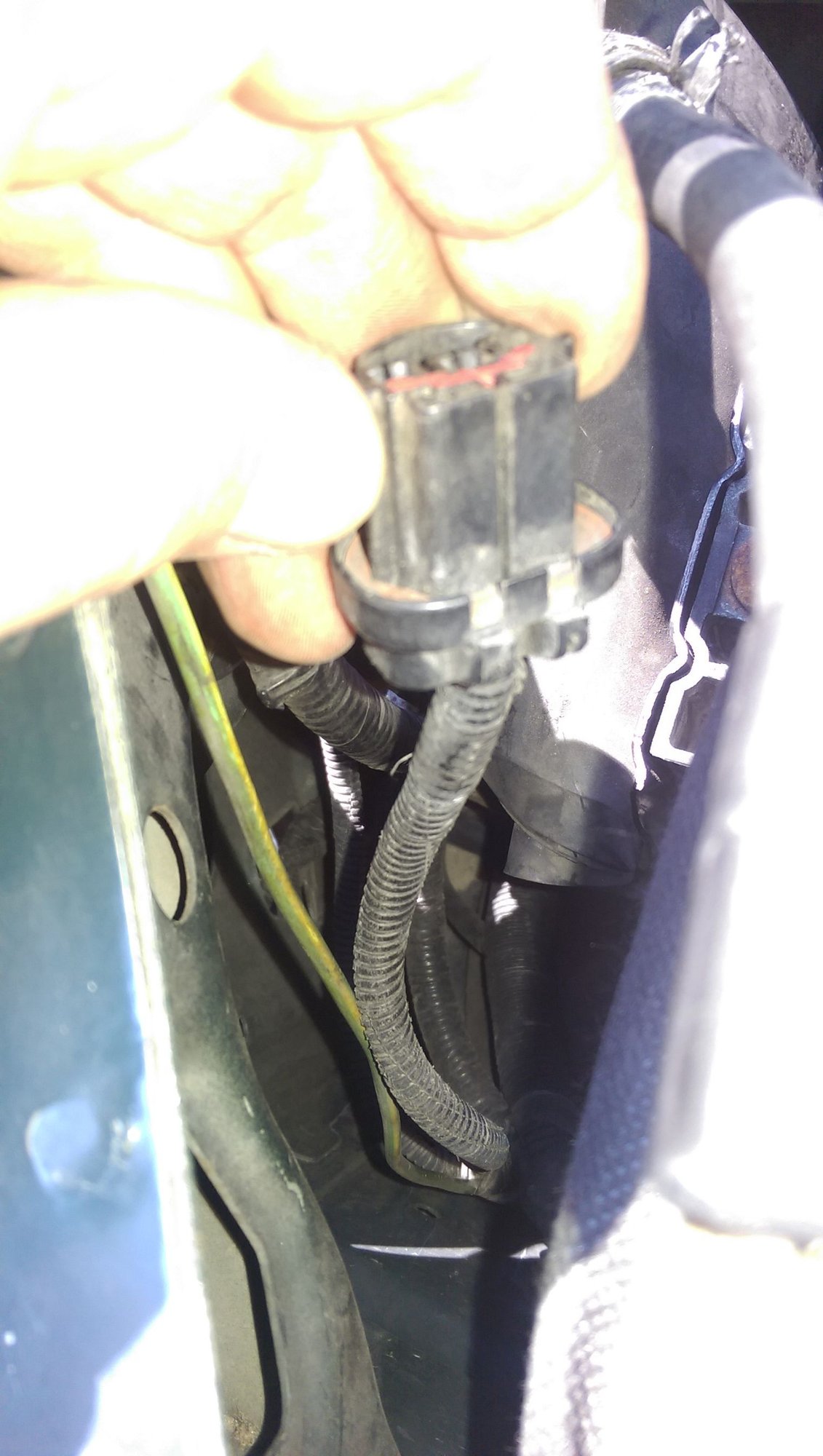

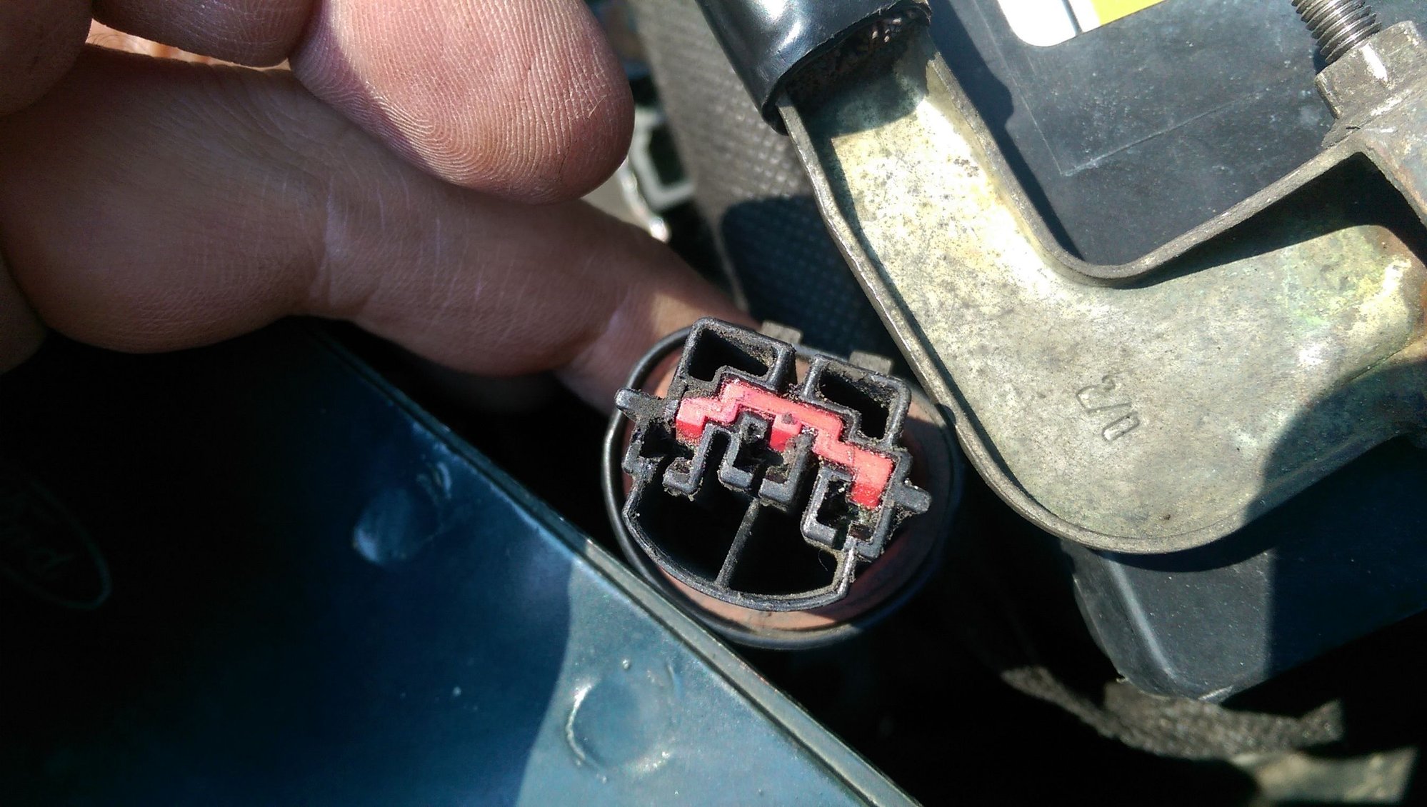

Here is my Excursion harness

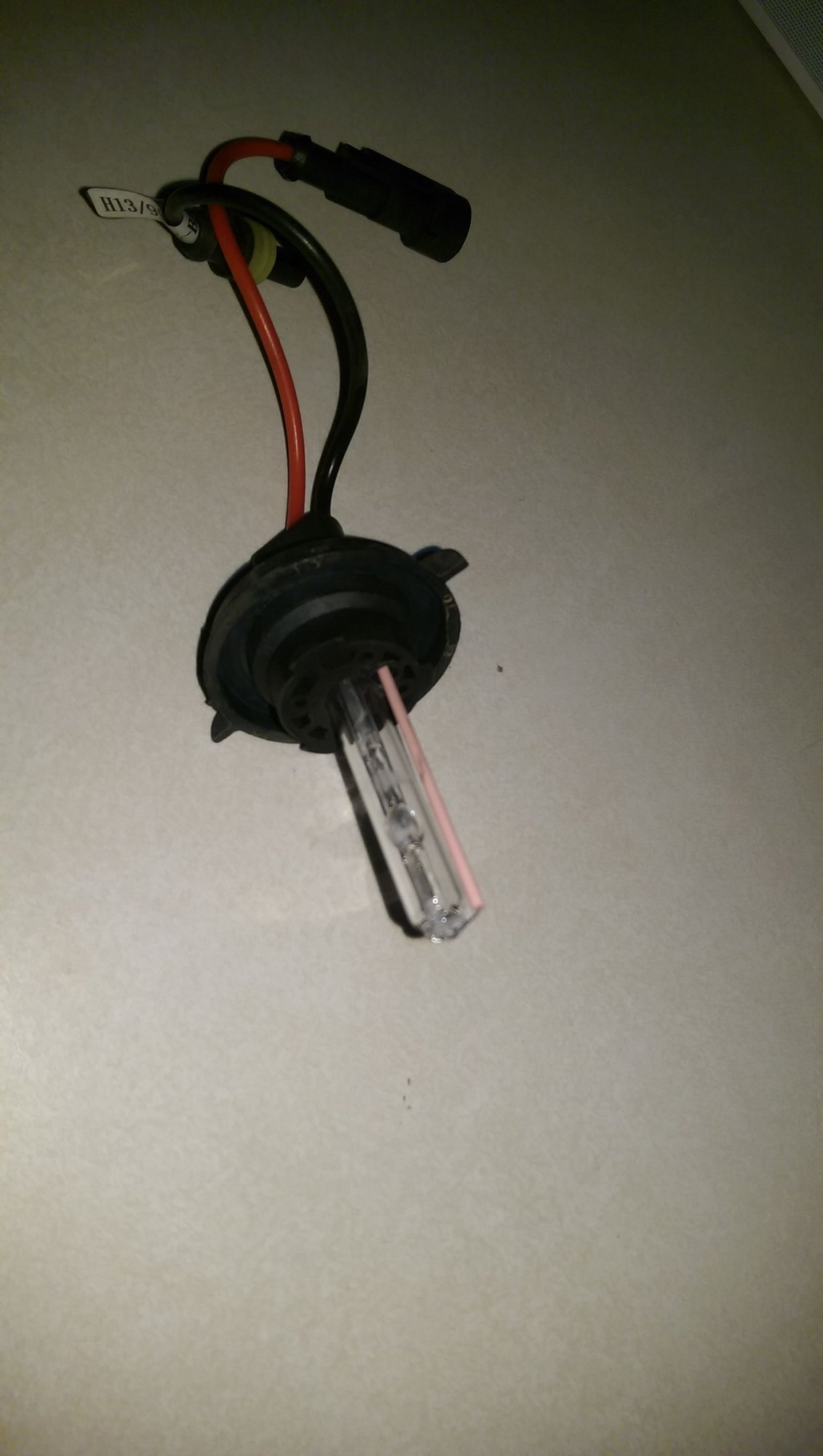

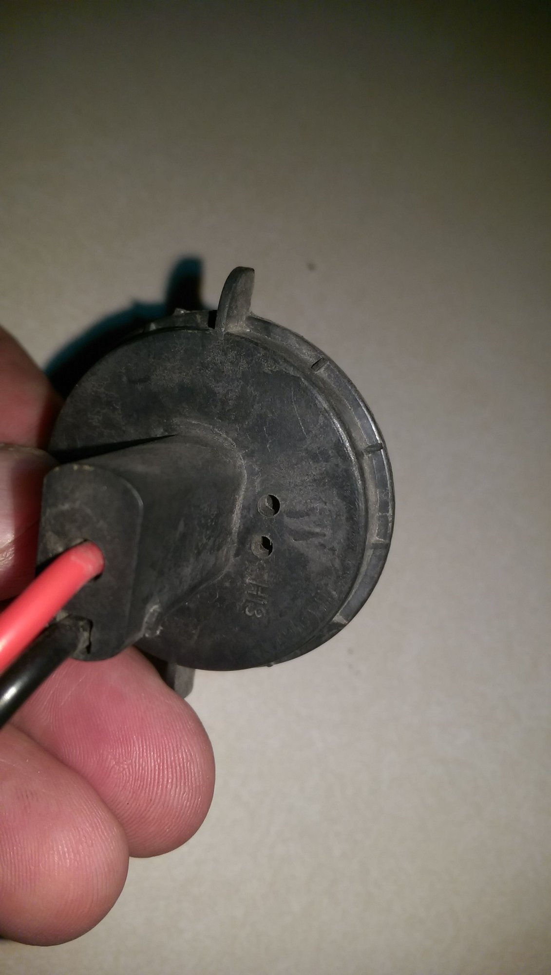

Here is the HID bulb that was in the headlights.
They were "low beam only" HIDs, so this should be a pretty good improvement, once I get the adapted

I believe 9008/H13 are the same. However your truck is 9007. Which headlight housing are you using? If it's the stocker just slap some 9007 bulbs and go. I think your PO did what my PO did and just wired bulbs individually from a 9007 harness to the incorrect bulbs.

Numbers off the front of my 2005 headlights.

Oriellys carries H13 harness pig tails
Dorman Conduct-Tite! 84785 - H13/9008 Bulb Socket | O'Reilly Auto Parts
but that is not a h13 it looks like a HID conversion bulb which needs to be connected to a ballast. follow the wires you unplugged that from and find the ballist.
you could always just get the stock 9007 bulb which will plug directly into that connector.
9007 bulb
Yep, that's the socket I found AdvanceAuto carries (no O'Reillys near here), but I'd have to solder it.
That bulb says H13 on the back and is the OLD HID bulb that I'm removing. I already pulled the ballast and have new H13 standard bulbs ready to go in.
9007 bulbs would connect to the factory harness, but would it fit into H13 headlight reflector socket?

That's the H13 bulbs I have. So I guess it's going to be 9007 to 9008(H13) adapter harness.
I have a similar HID kit, but the end of the wires were broken off and just the connector blades stuck into the factory harness, covered with goop

I should have checked before, but I *ASSUMED* the PO did the pigtail conversion, then added the HID ballasts. Nope!

Update: I installed the adapter harnesses in my post above. The fit was very good. Had a little trouble with connecting it to the bulbs, had to install the bulb into the adapter first, then install the bulb into the headlight housing.
Thanks for all the advice
Had to be very deliberate when connecting the factory harness to the adapter, too. VERY particular and snug alignment and fit.
