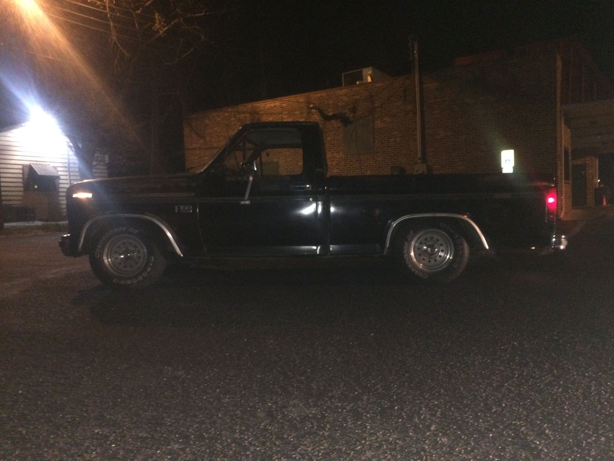

I picked up an 85 f150 xlt a few months ago and just started working on it this week. It's a 302/aod truck with a bad trans. Has a few things done to the motor intake, carb, headers with dual exhaust. Immediate plans are a healthy drop and wheels change, rebuild the trans, and clean up the outside. Down the road my plan is to build a cheap single turbo blow through set up for it. Here it is when I picked it up.
Very little rust and a solid start to a cool street cruiser.

Rear is done. I just put the rear on top of the leafs, set the pinion angle and welded perches to the rear. I didn't get any progress pics only one of it done.
Not the best pic but it was late and best I could do. The rear is quite a bit lower then the front so I'll have to buy a 2 or 3" drop spring to level it out.

You dropped the front properly with the special axle beams, not dropped springs for a reason. Adding dropped springs will put you back into the bad situation you avoided with the dropped axles.

First I have to say it is your truck and you are building it as YOU WANT and that is good.
Me I don't like the rear that low and then you want to lower the front to match the rear by using springs-read less wheel travel.
Me I would go back under the spring with the rear and use shackles to drop the rear to match the front.
I'm running 2" drop coils with drop I beams on my 96 f150. Chamber was set with special degree accentrics. No problems at all and it's my daily driver. I just didn't realize the rear would drop so much on this truck. Figured the 1" drop from the Lightning coils would be enough.

It is lower in the back then I wanted but i don't want to go with just shackles as it won't be low enough. And id rather not do drop hangers up front to lower it the rest. I'm going to throw the 2" drop springs from my 96 on it and see how it looks with one of the 3 sets of wheels I have. My truck rides really nice with the drop beams and coils. I cut the snubber in half in order for it not to bottom out and it never does. I've lowered around 10 I beam trucks so I know what works and what doesn't.
