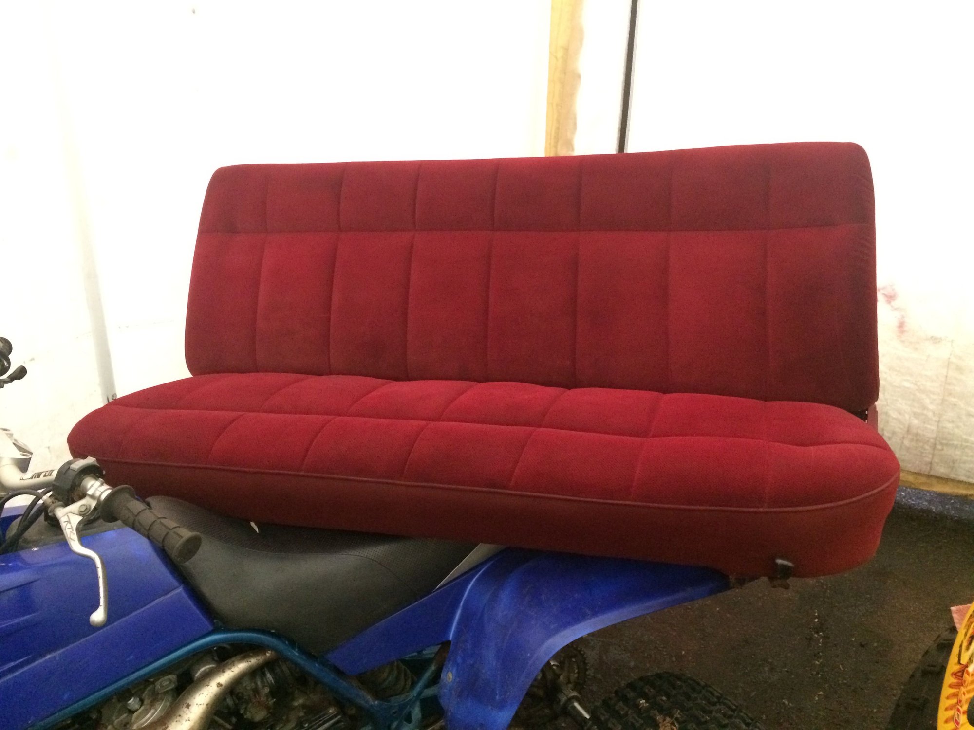

I got some more work done on the truck. I got my aod back from the shop. He changed a drum and added more direct clutches as well as a mild shift kit. I installed it with an FTI 2400 stall converter. I haven't driven it yet as I'm having an issue using the Lokar TV cable kit with the factory column shifter linkage but I'll figure it out. I'm replacing the Edelbrock carb with a rebuild Holley as well.
Also worked on the interior resto. I installed a new headliner out of a 92 truck with the matching sun visors. I had to drill holes for the inside visor clips that the 80-86 trucks don't have. Also my girlfriend dyed the badly faded but otherwise nice seat with the colorbond paint that LMC sells. More pics coming.
Old Apr 26, 2016 | 07:03 PM
UTlonghrns's Avatar
UTlonghrns
Joined: Apr 2016
Posts: 53
The seat looks great! I've got one I need to do that too.

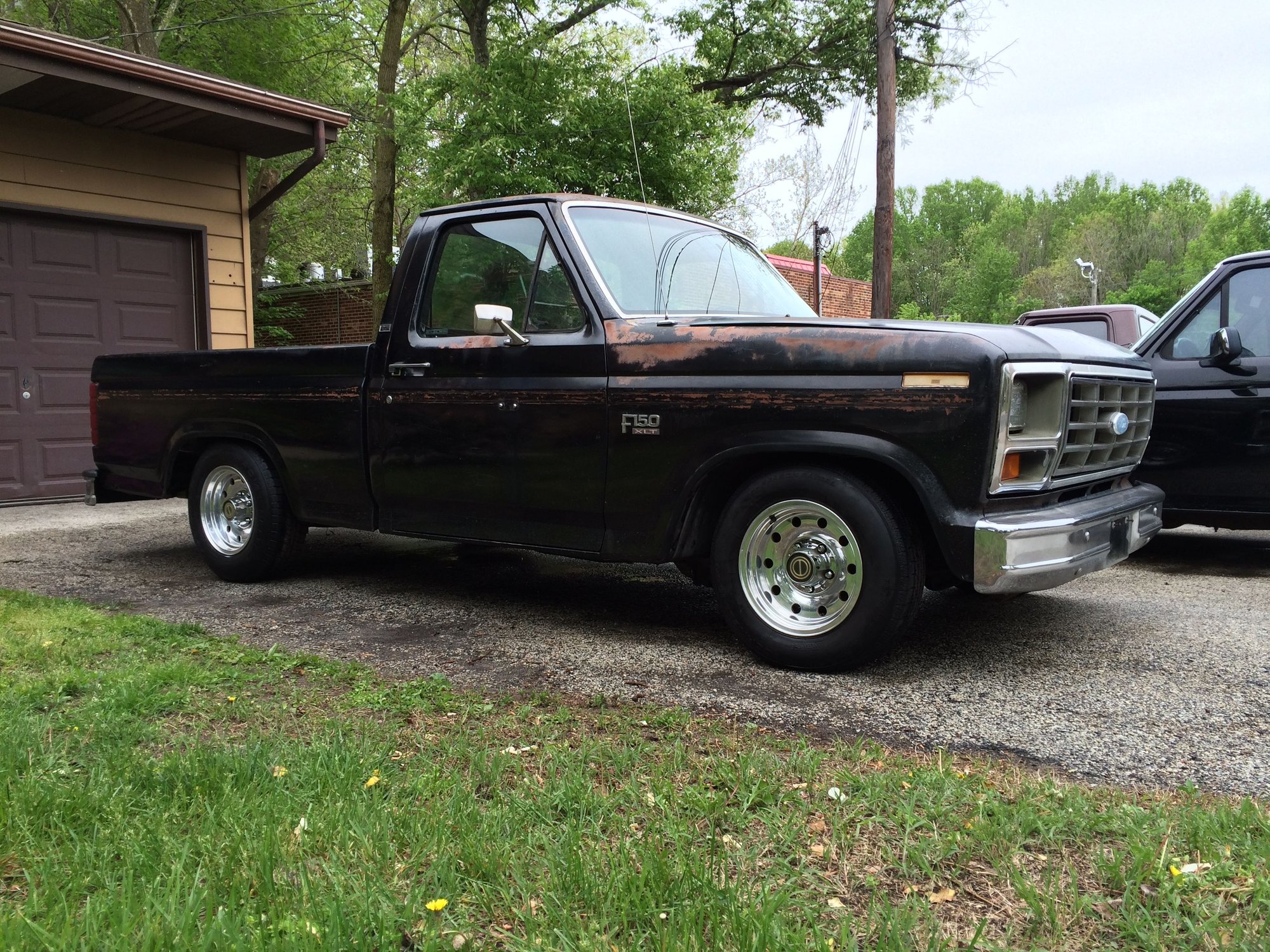

Ok I made some more progess this week. I took out the sliding back window that was busted and installed a 1 piece. I found out the windshield was leaking so I had a guy replace it. I finally got the Holley squared away and figured out how to hook up the stock aod tv linkage with the sonnax correction arm.
I also installed belltech 2" drop springs as the 93-95 lightning coils weren't low enough. Installed a 92-96 style step bumper in place of the bent chrome bumper. I'm really hoping to score brackets for a smooth bumper eventually. Installed new weather stripping on the window tracks and the outside pieces as well. Just about ready to throw the interior back together and drive it. Here is a few pics.
Old May 11, 2016 | 07:50 AM
  #28
lugnut1009's Avatar
lugnut1009
Joined: Sep 2005
Posts: 28
From: Vicksburg, MS
Looks great! You got me looking for one like that now. I hope you leave the paint alone too. I love that used/worn look.
Old May 11, 2016 | 09:04 AM
  #29
1986F150six's Avatar
1986F150six
Joined: Jul 2009
Posts: 6,477
Likes: 19
From: Sheffield, AL
Your project is coming along, nicely!

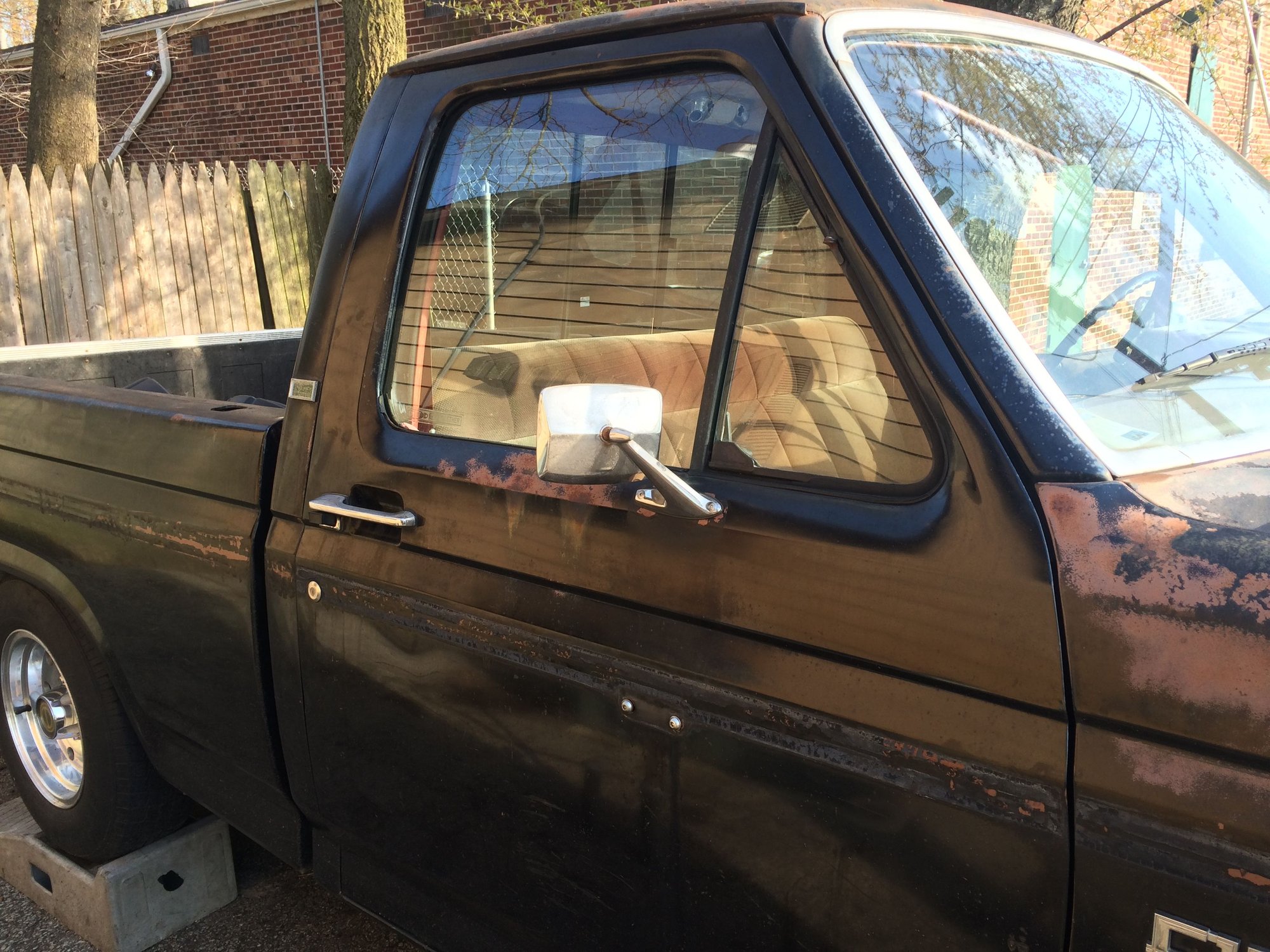

Thanks man. Yeah I have no plans to paint it. I think the patina looks good even though the truck isn't really old enough for the look.The only issue I have is the black came off while trying to remove the glue from the rubber molding it had when I bought it. What a nightmare that was to remove lol.
