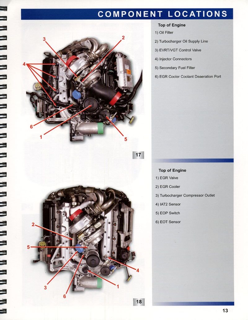

Hey Guys,
I have a problem. I have a 2003 F350 super duty 6.0. I replaced the hpop and low pressure oil pump and oil cooler all the sensors on top of the engine. After putting it all back together I have one connecting plug that I can not find the place it goes.. It has a blue top and two wires yellow with a white strip and a tan wire. If anyone can help me would be great!!! or ideas.
Thanks

What is it near? See picture:

Hey Guys it next to the egr valve. Comes out of the wiring harness the same spot the egr wire. it is only about 12ins. long.

It's the throttle plate connector, and would plug into the intake horn. If the butterfly valve is still in there, remove it.

That in fact looks like the wire. But I got the truck used 9 years ago. An it does not have that plug-in just a blank spot there! So the wire is of no use?

Pretty much. If you can get a later model intake horn the throttle plate control was removed entirely. No CEL no worries.
