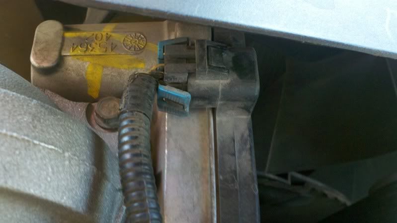

Chances are you have an early motor that had the throttle body. Programming to control the butterfly was removed very early on, as it was determined to be an unnecessary component. A lot of guys change the intake elbow and the throttle body goes in the trash, leaving the electrical connector for it dangling around the intake elbow.
I still have mine and this is the connector attached.

You are Correct!! While out in the garage a few minutes ago I finally found what it plugged into. It is hidden between the alternator and the fan shroud. (didnt know what it was, but at least knew it plugged in there) Thanks for the info!
