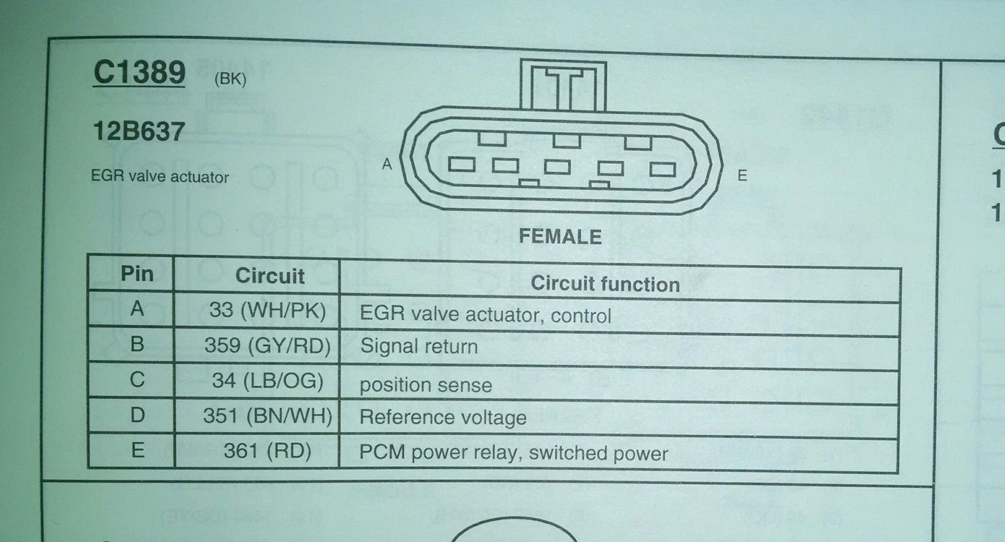

I have a 2004 F-350 cab chassis with the 6.0. I have an Edge insight CTS on it and keep getting p 0403/0404/0405 EGR codes. Well I decided to look at the wiring harness while pulling the EGR plug. What I found was a large amount of tape several inches down from the plug, after unwinding the tape what i found was that the harness wires had been cut and a different plug kind of spliced in. Can someone tell me what color wires should be going to where on the plug?
What I have traced is from left to right looking down at the plug is as follows:
1 red
2 brown/white stripe
3 green/orange stripe
4 white/red stripe or lt grey/red stripe
5 white/red stripe
Help

From 2004 Service Manual..
EGR Valve Connector Pinout

This is what I needed. Thank you.

Just wanted to let everyone know that after soldering and shrinkwraping the wires all EGR codes have gone away.

Seems like they were in the right positions, but weren't making the greatest contact. Glad you got it fixed.
