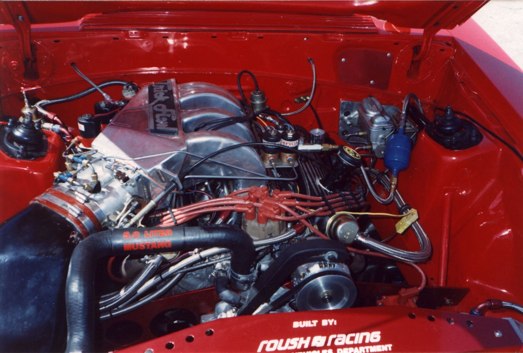

Nope...........the 5.0 version............maybe "a ton" of work is over stating it a little but it needs serious runner porting/welding or epoxy/splashzone to compete with the systemax II......probably more time and effort than the average enthusiast is willing to give...........in 1990/91/92 it was a great lower to base a box upper on or as TFS did build a HEAVILY modified truck upper in conjunction with a maxed out lower ala Stormin Norman
There was a "milder" version that used the truck TB's...........Steve Collison (then editor of MM&FF) ran one on his project 5.0 with TFS heads and a mild SD cam.......car picked up when he swapped to MAF and a gt40/65mmtb combo, not much but was faster........not apples to apples but a comparison none the less..............
Honestly most of this is not going to apply to 99% of the guys on here and i think the truck upper/lower are fine intakes but the "racier" you get there might be other options...........i have a typhoon i plan to try on my van and my buddy is working on another modified truck upper and lower we may try and i would add that i try to base all my "opinions" off what i've personally seen or experienced at the track or dyno or what i consider a reputable source..............
