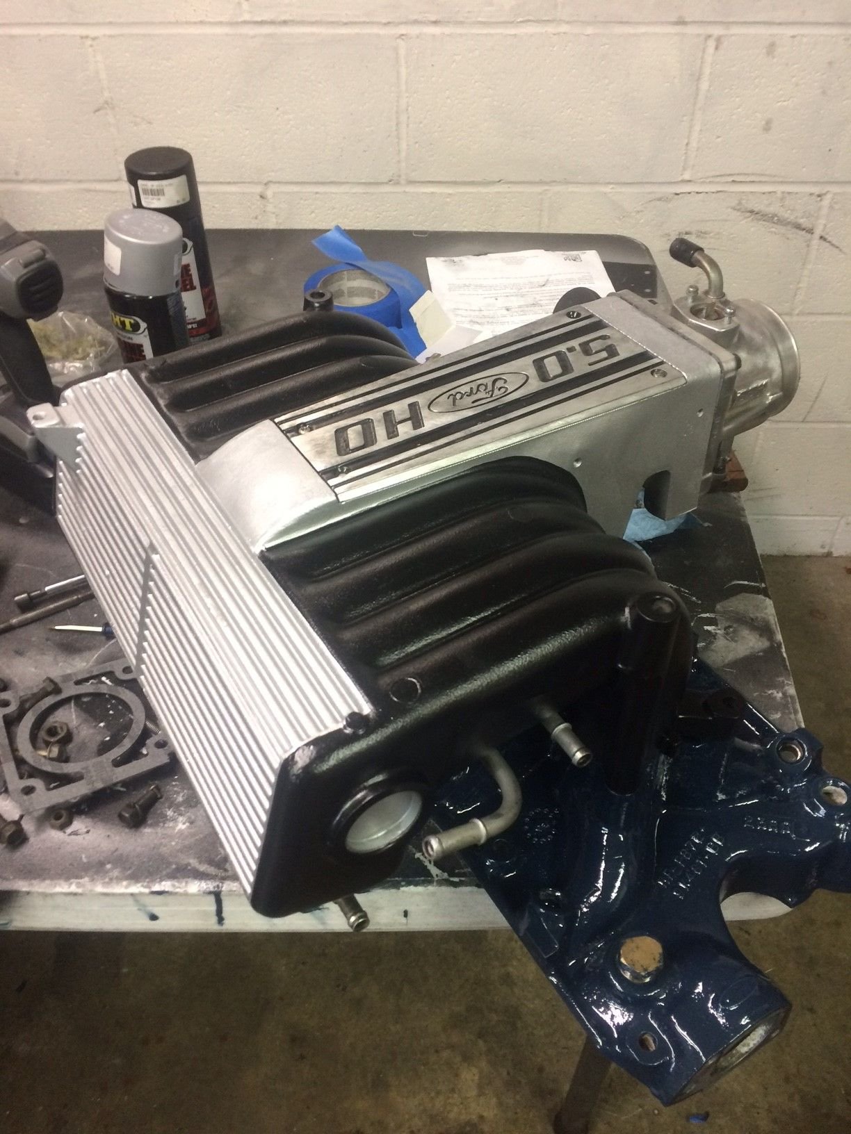

Tom: "If the Explorer intake poses no clearance issues, I like it with the 70mm MAF. Since the stock Explorer intake flows ~205 cfm and your GT40 heads flow mid-190 cfm there is no need to port the intake."
So from what I've gathered is that there is no obvious bottneck with the truck upper/lower and explorer combined with 70mm TB. I realize the greater cross section of the truck intake will allow more flow in cfm, and enhance low end band, and that although the explorer has slightly shorter runners, less cross section, it will benefit from greater air flow velocity and push the power band to the top end.
As I already have the explorer and 70mm TB, I'm going to try it out. I figure my comp 35-349 will help shift the power band a little lower and combined with pong tube headers into 2.5" single exhaust, I will still see an overall improvement over my current tire SD non-roller. Combine that with the fact that it's going into a short bed F150 that is just a daily driver, I figure if I feel like I need more low end I can always put the truck intake one.
P.S. plus I already have the explore intake all dolled up!! Wacha think?

Oh.. that's a very purdy intake.

Are you planning to run it flipped like this (and the Lightning)? I'm interested to see how it works out for you with the connections etc. I would ultimately like to put fuel injection with this type of intake on my dads '75 F100. Whether we would run it conventional or flipped, I don't know.
