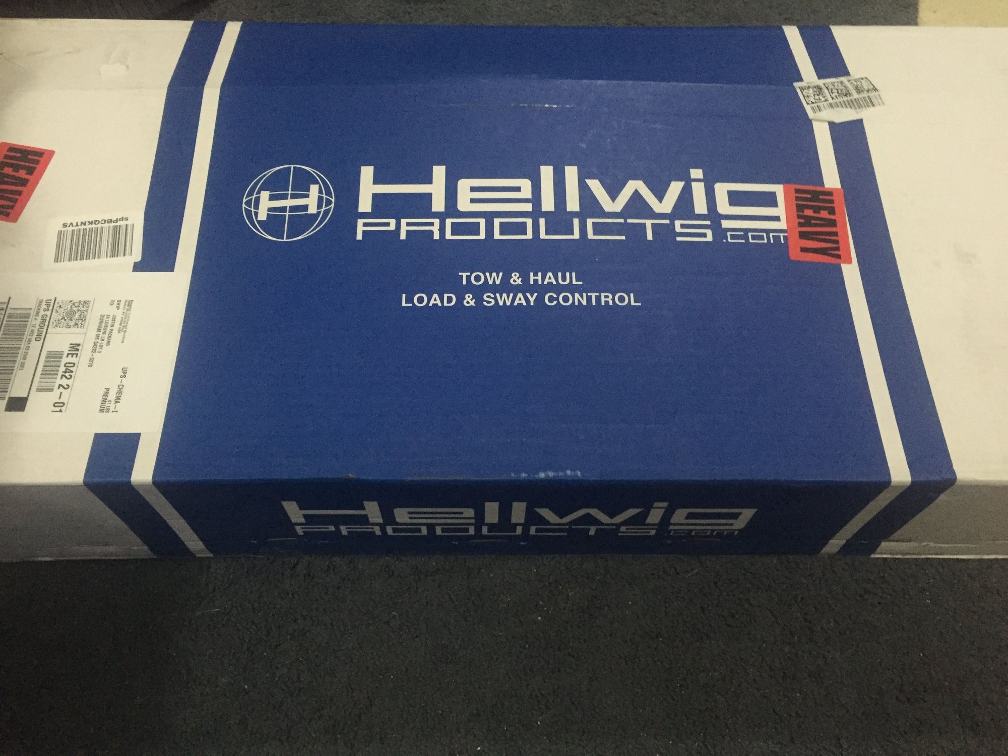

Well look what I got today
Haven't had a chance to install yet but this seems to be a pretty rugged bar, great quality too.
