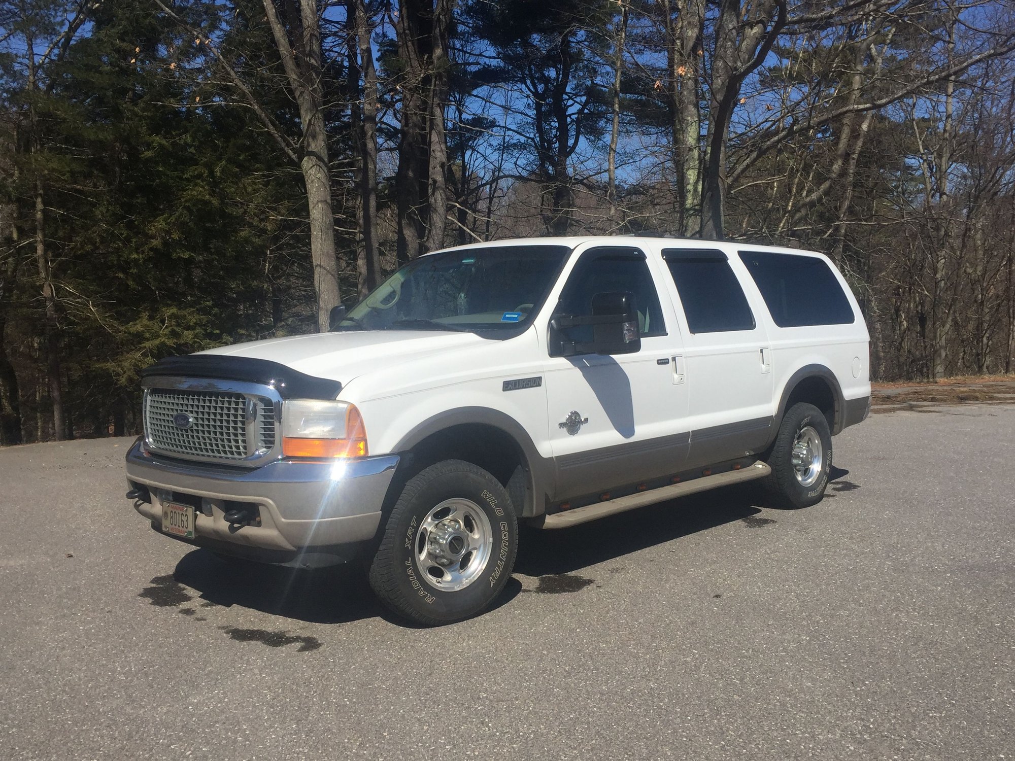

Well here is my very FIRST post. I have been a long time fan of the Excursions and have finally found one to call my own! I bought an early 2001 Excursion Limited 4X4 with the V10. It has about 170,000 miles on it.
I am a Skydive Instructor at Skydive New England and spend most of the summer on-sight, so truck will be mostly for pleasure. Once the fall comes it will be the my work horse (and home) and pull the camper to Florida for the Winter.
I have done some much needed TLC and replaced the Alternator, Muffler & Tailpipe, Rear Axle Brake Lines, and some miscellaneous parts. I have also had a little fun with upgrades, New Kenwood Double Din Head-unit, 08+ Towing Mirrors, Added Running Lights on Running Boards, Vent Visors, Brake Controller...
...And of course added New Excursion Emblem!
I need some guidance on the next few items. When I had the truck inspected here in Maine the mechanic found that I had a broken rear leaf spring on both sides (bottom). I am looking to replace but not sure if I should replace with B or X codes. I tow a 28 ft 8,000 pound Camper Trailer (with WD Hitch) and not sure what is recommended.
Interested in added rear sway bar, where to buy?
Also looking to update the look of the front end and would love to do the 05 Grille and Headlights. Where is the best place for Quality and Price?
Love the forum! Thanks guys!
Justin

Great Looking X Justin & WELCOME to the world of XXXs
I would have to I think the guy looking at you X did not know an A from an H & I'm guessing the broken spring he noted ON BOTH SIDES was the SLAPPER Spring that is to help with the spring warp the stock X springs can suffer from. LMAO
Helwig is the source for the rear sway bar (NEW) and the yard from a F-350 is another rout.
X or V codes are the front & B or Cs are the rear
BOTH the springs & the rear sway bar will pay off in spades to add to your towing pleasure. You should call JR at ATS & talk about your spring needs.
ATS Springs
Leaf Springs and Suspension Parts by Auto and Truck Springs
Phone number: 1-888-943-8287
He is a site sponsor & has helped many here on the X side of things.
PS: DON'T let that guy touch your truck !!!

You guys are awesome! I appreciate all the help. I was a little shocked when he said I had two broken springs, didn't quite add up. I'll give Junior a call tomorrow and get some much needed info.

I'll snap a couple photos tomorrow of the springs. All I know is the mechanic that looked at it said that the rear portion of the bottom spring was broken on both sides. Makes me think he might not be up to date on his excursion suspension

The Hellwig rear anti-sway bar is a nice upgrade for any EX that didn't come with one originally. Swapping in a set of the Super Duty pickup springs really transforms the EX into a much better tow rig, so much better than stock!
Yeah, that mechanic doesn't realize what he is looking at, the bottom front half only leaf is actually a factory installed slapper style traction bar Ford added to control the axle wrap from the weak rear springs. The EX got shorter and weaker springs than it's cousin pickups to make it more friendly to the targeted Soccer Mom audience, now we have to undo that great idea to make them into what they should have been.
The things you learn. Thanks. I'll be checking into new springs tomorrow from ATS and already ordered a Helwig Kit. The previous owner installed new shocks before I bought it, I believe they are Skyjacker Nitro 8000. Any idea if I should keep or replace them?
