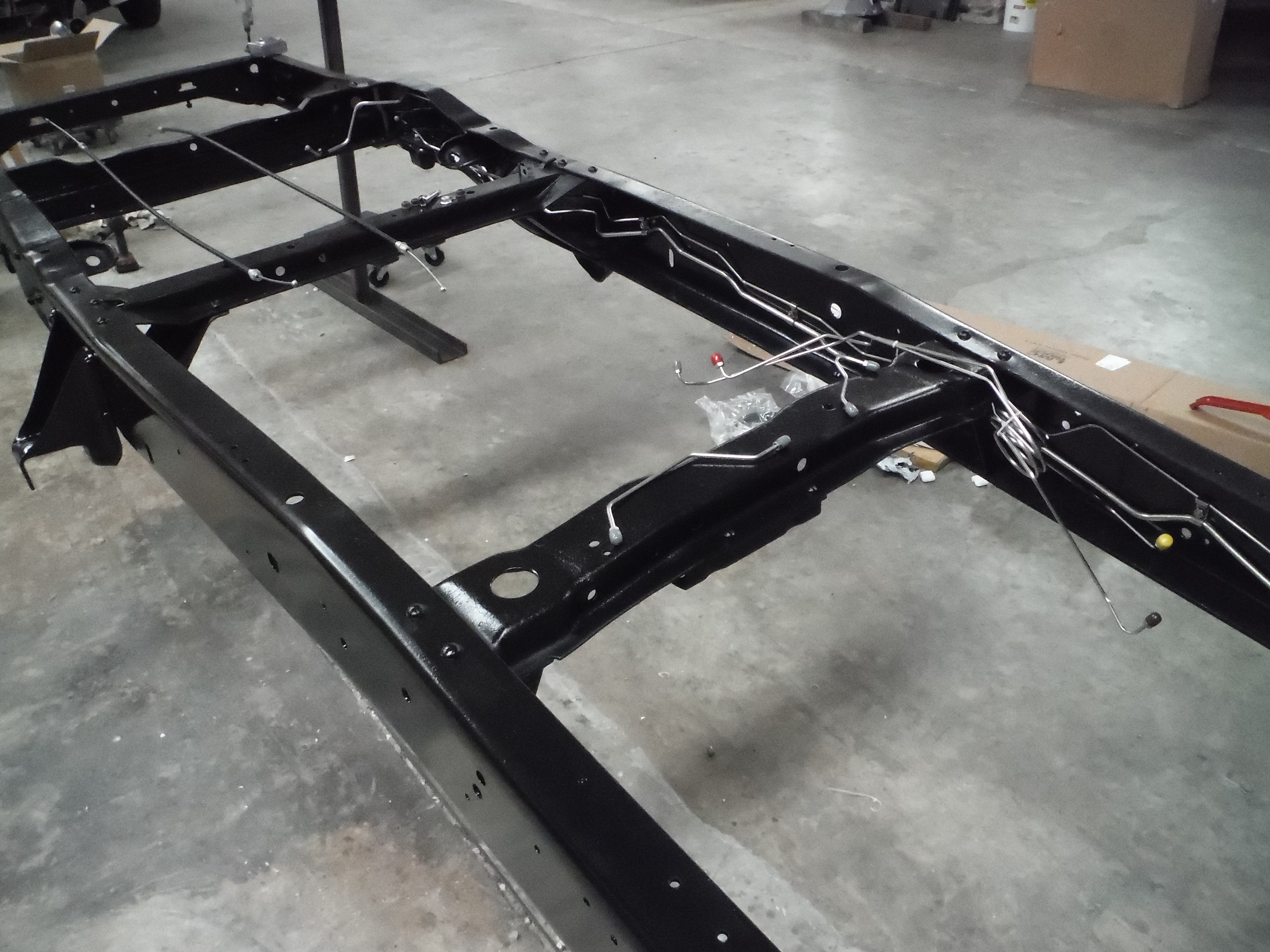

This is the exact way I went about my recent and in-progress frame up restorations. Everything has a price, so make sure your basics are in at least restoration condition. Remember, with these trucks you have plenty of room for changing and/or upgrading during your resto...just make sure you have a final goal.
I like you was more concerned about the frame condition, just a pet peeve for me but in my mind, the frame is the absolute starting point and structural security of the vehicle. If you take HIO's advice (which is sound) don't be afraid to get dirty and crawl around and under any perspective buy!
Attachment 289210
Best regards on your build!
